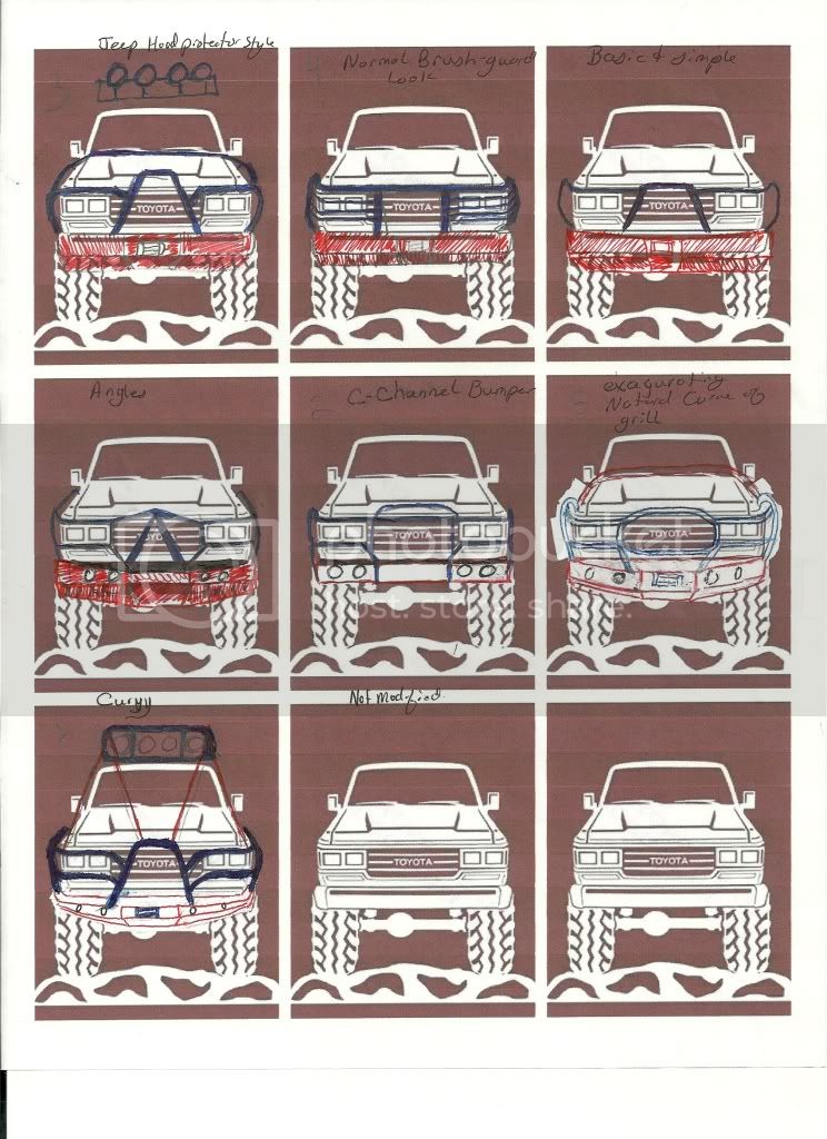

So, which do yall rather...
All will have the "red" cable running from guard, to roof rack, and All will have the Roof Light Protector, Just need to figure out which to build.
I'm also open to ideas.
I'm going to bring all of them up and around fenders to sliders, which i've tried to show on a couple.
Some I did just a front view, some I tried to give it the same slant that the truck is shown at.. :D
Thanks
Cody
