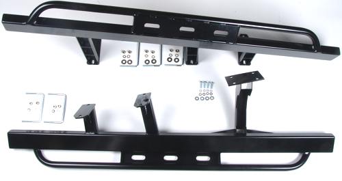

Which is better for a slider. 2x3 rectangle tube, or 2x4. And which thickness. 3/16 or 1/4. I'm thinking a 2x4 3/16. Seems a lot already on market uses the 2x3, but I plan on weighting alot by the time I'm done, so I want strength.
This will be for the front to back piece. The frame connector will be a 2x2 3/16 tube. I already have.
Also. What is better. 1.5" Dom or 2" Dom. Again most of the things I see use the 1.5". Would the 2" be overkill
I know that bigger isn't always better, but I think on this situation it might.
Also does anybody have a 2" bender. I believe one person here has an 1.5" but I'm kinda really leaning towards the 2"...... Any thoughts

I thinks its a matter a preference bud the 3/16 1.5 dom is going to be a tad bit easier to work with and both will do the job. The Slee Sliders on the 80 are 2"x4" 3/16" wall rectangular tube with 1.5" DOM outer tube. Sliders for the 40 are 2x4 1/4 with 2 3/16 runners to the frame, I broke the single runners so came back and added a second one on top of it and that did the trick :)
