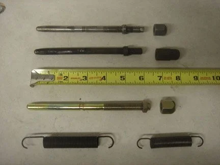

Attached is a pic of possible push rod combinations and lengths. The rods all appear to be the same length but the difference between the first rod (might have come from my 77 4 speed???) and the second (might have come from a 72 3 speed) is the adjustment nut. The first rod's nut allows for lots of adjustment due to the fact that the nut does not have a cap and allows the shaft to move up and down along the threads. The second rod has a nut that is capped and will bottom out thus stopping adjustment at a set point. The third rod is similiar to the first rod but appears to be a tad bit longer. I am running the bright shiny third rod now and it works just fine without the spring. The big question, is the third rod correct for a 77 clutch? If it is, then I can use Toads points for adjustment. The last important question, which spring is correct?? I found two in my bag-o-clutch parts. My rig came in pieces so I am not sure which spring is which or where they came from. Thanks for any guidence you guys can give.
The spring on the left is the clutch pedal return spring - it installs on the clutch pedal itself at the top of the pedal on the same pin that connects the master cylinder rod to the pedal - the other end of the spring connects to a tab under the dash.
The second spring on the right is the slave spring.
Thanks for your pics - my slave rod looks identical to the bottom one in your pic - ie the gold one.
