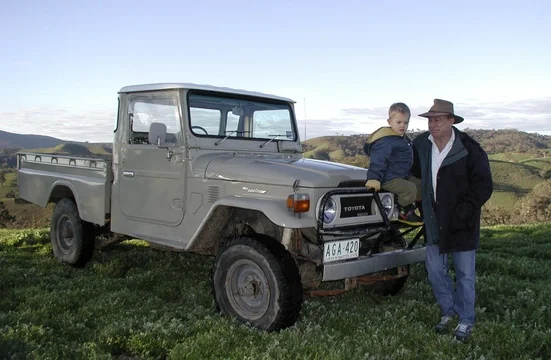

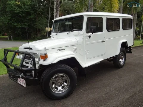

Hi,
I have a 1977 HJ45 Utility and a 1984 HJ47 Troop Carrier.
The HJ47 has a J07 50 amp instrument cluster. Some of the indications have been dodgy for a while.
I purchased a J01 50 amp cluster in perfect condition, with the intent of putting it in the HJ47. (I had the new cluster tested by an instrument shop in Australia, and they said it was all good)
When I plug in the new cluster, the temperature looks as if it over reads by double and the fuel gauge does not seem accurate.
Are the J07 and J01 clusters interchangeable on my 1984 truck?
Thank you for any help.
Regards,
Patrick.

Hi Rudi,
Thank you for your reply.
I have read the entire post multiple times, but most of this seems like "magic" to me!
The wobbly 7 volts was the term I was looking for to describe it to the instrument guy.
It is a shame to lose the extra digit from the original J07 odometer, but the other cluster is too perfect not to put in the troopy. (Once it is reading correctly!)
I really appreciate your help and look forward to speaking with you again.
Regards,
Patrick.
