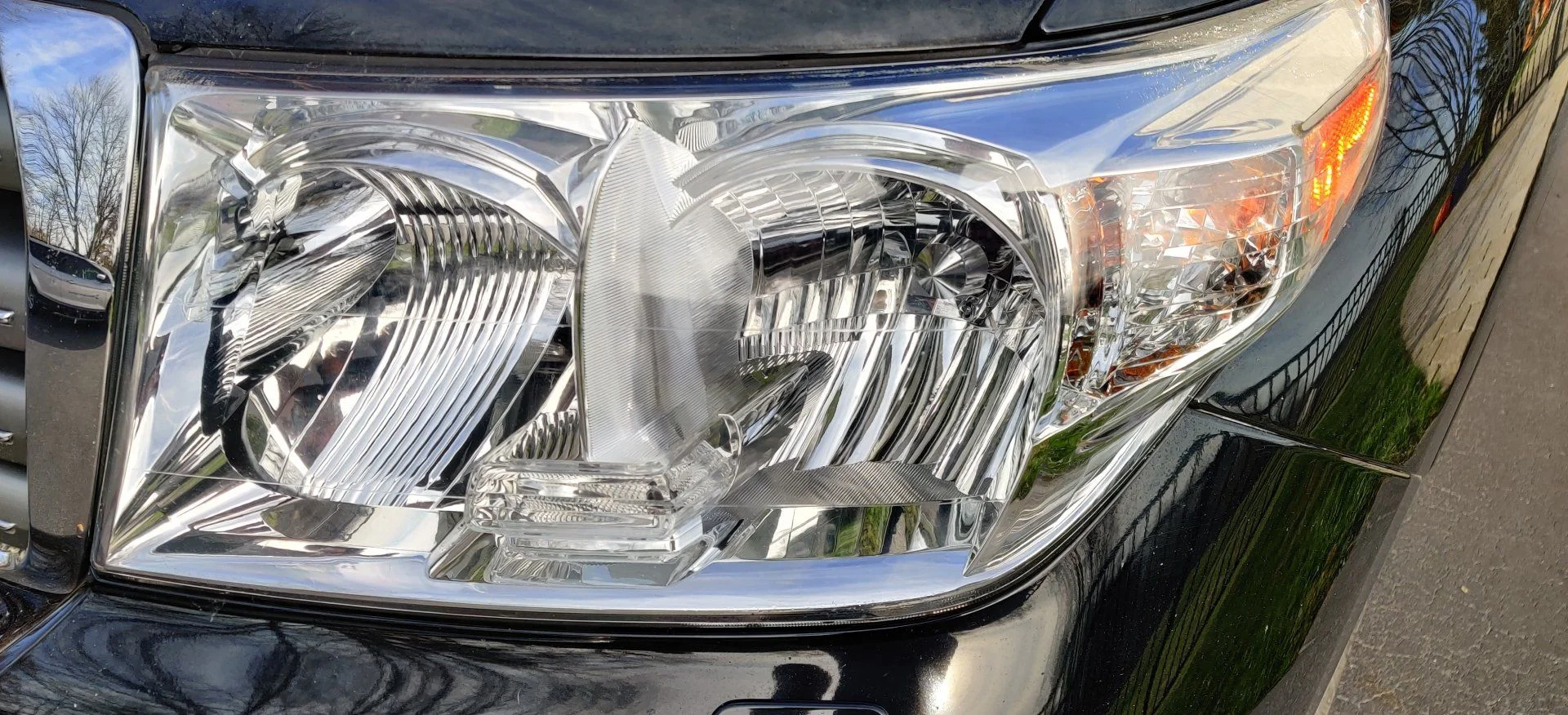

For the other curious souls out there, this is the XPEL H0114C headlight film. As stated previously, this is no longer available for the 09-11 lights. I haven't looked into later models.

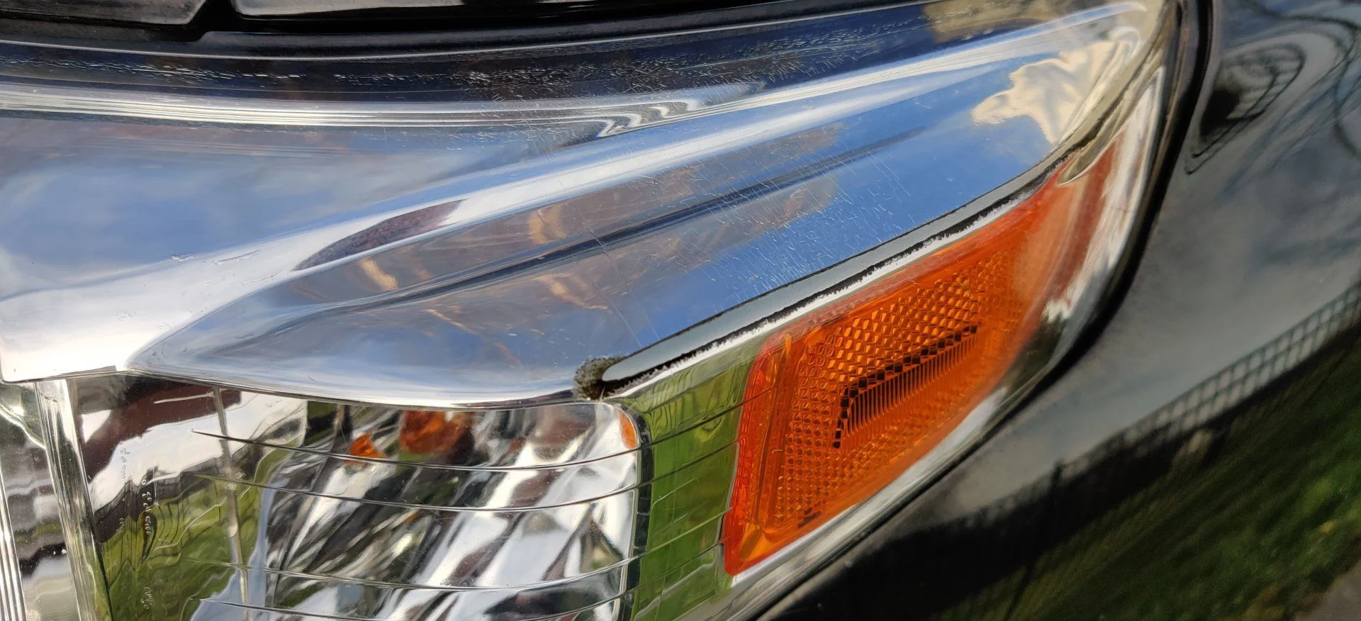

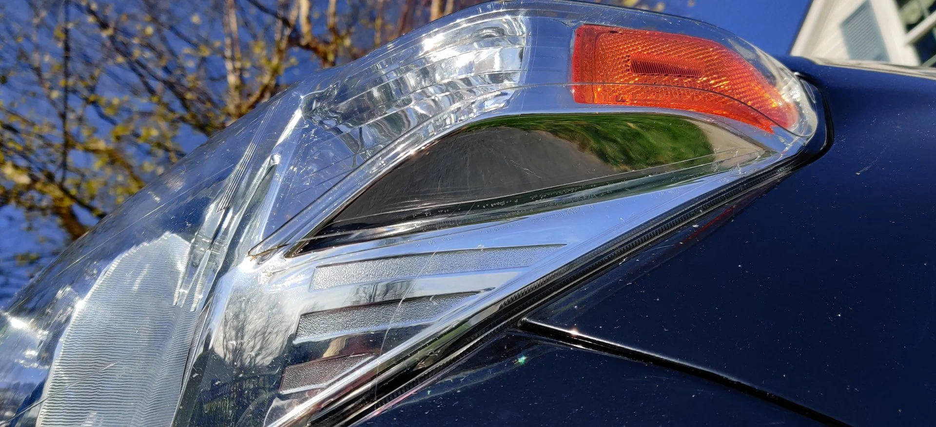

It's fairly thick, at about .03-.04". Mine has been on for a bit over 3 years, outside year round. You can see the seam has become more pronounced over time with dirt getting in. I haven't done anything to clean it up since it doesn't bother me enough. The film has three "tabs", one which folds over the top side, one which wraps around the side marker protrusion, and one which wraps around the bottom. The exposed area of the light is around the perimeter, at the two seams, and the area directly under the side marker protrusion which isn't exposed to as much direct sunlight and hasn't faded/clouded. You can see where the film is starting to deteriorate along the top edge, with what looks like fine scratches.

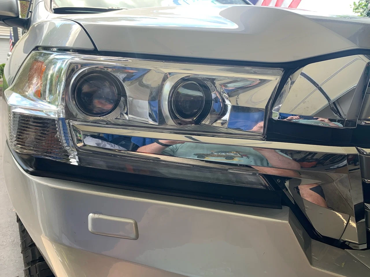

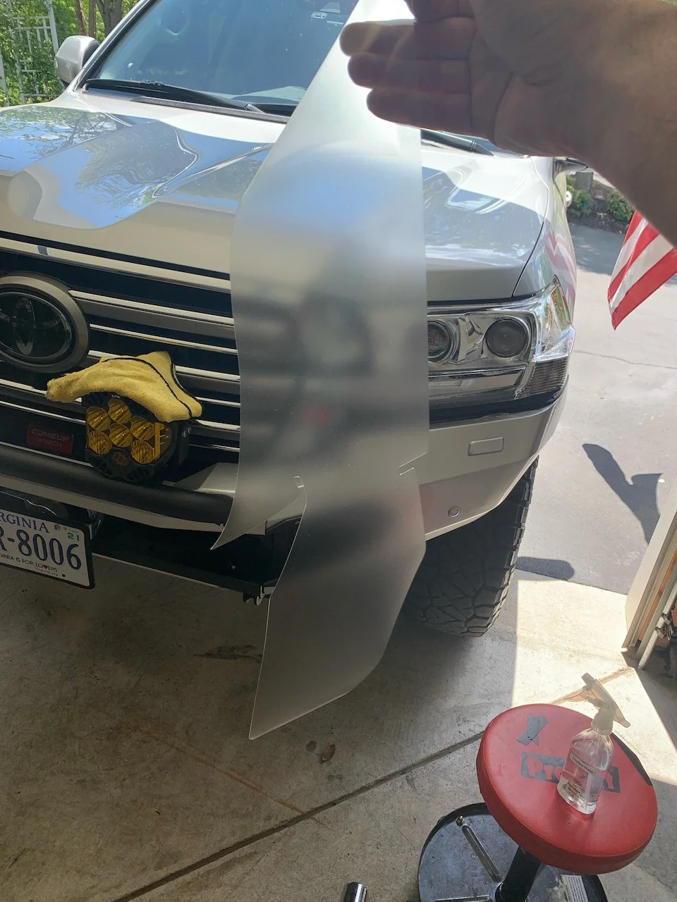

Installed the XPEL headlight film over the weekend. it consists of 2 pieces for each light. Also came with film for the OEM fogs but I don't have those anymore.
Took a spray bottle with distilled water and a little alcohol. Sprayed the headlight and the sticky side of the film with the water mixture.
Getting the lower section under the rubber gasket of the bumper was a little tricky but once you get started, its not bad.
Someone pointed out that a one piece film would be better so there are no gaps in coverage. That makes sense but probably easier for a skilled installer. Part $118. Labor = $0.
Has a few air bubbles but expect those to go away once dry.
