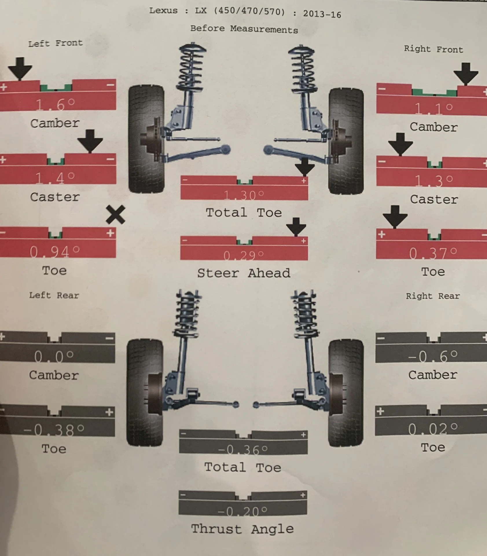

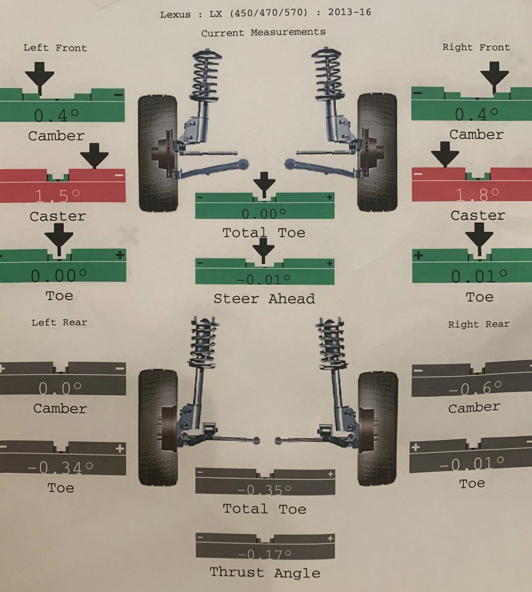

Here are before/after specs. Doesn't look like my caster changed too much.
Could anything else be the issue or definitely CV?

Unless there's something I'm not aware of with the Tundra suspension that caster number is waaaay low. Spec is something like +2 to +3.5 degrees. You're at -1.8. That means the tire is positioned too far back in the wheel well. Are you rubbing the fender liner plastic or body mount?

Also why is caster so far out after an alignment? Did they even try to adjust it?

I'd actually expect negative caster like that to make the front end shake/wobble, similar to pushing a shopping cart where the front wheels shake back and forth. Positive caster, like the front forks on a bicycle, helps the vehicle track straight and true with little to no effort.
If they can't do better than -1.8 degrees with the cams fully cranked then you need adjustable UCAs. I wouldn't think negative caster would cause your clicking normally, though it technically is putting the CV in an abnormal position (relative to spec, anyway)

My right caster moved from -1.3 to -1.8 degree. Could that have been enough to stress out the CV joint?
If they didn't adjust caster, did it move as a result of changing something else?

I would think it would be unlikely to damage the CV when driving straight ahead since there's enough play in the CVs to handle full suspension and compression. It could leave your CV at a weird angle though for normal daily use which might wear it faster? I'm not an expert on alignment, I just noticed that the values were negative and thus several degrees out of spec.
Caster will adjust as they adjust for camber. It's not a linear relationship but you can kind of think of it like that
Do you find the truck wanders on the highway? I do think you want to get your caster somewhere above +2 degrees - ideally around +3 or a bit more.

Your sensor lift could easily explain the negative caster. Look at the upper arms and notice they are tilted backward. As they swing down the upper ball joint moves forward. The truck can only go so far up before caster can’t be kept in spec, which is one of the primary reasons people run aftermarket UCA’s. Those move the upper balljoint relative to the upper arm bushings thereby building in some camber and caster correction to put you closer to stock spec at new taller ride height.
That doesn’t explain it persisting nearly unchanged after an alignment though. I’m guessing they didn’t even try to adjust it.
