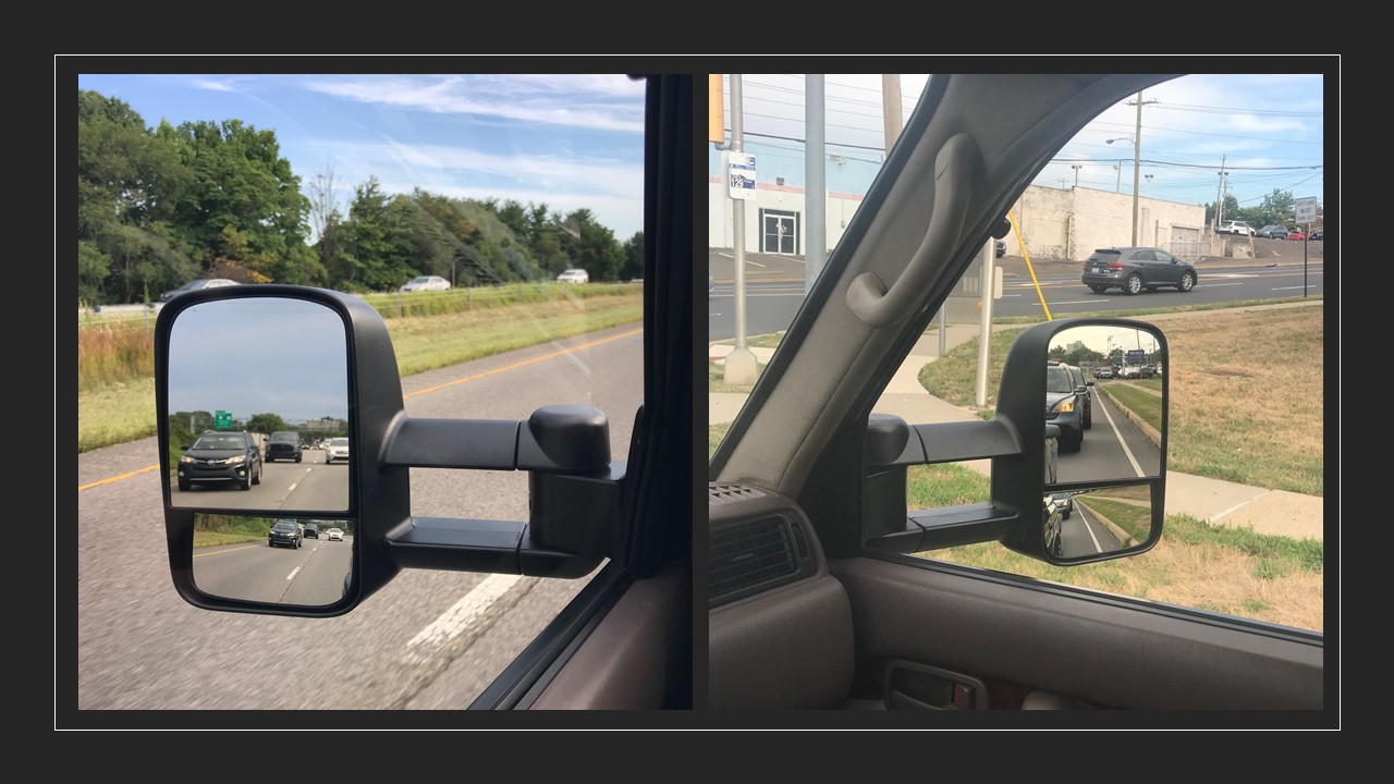

After a few years of being on the fence, I purchased a pair of Clearview telescoping towing mirrors about 3 months ago. They are made in Australia and are imported and distributed by Atlantic British Ltd. in NY. At $550ish for the set, they are not cheap, but the quality is top notch and from a towing standpoint, the view is head and shoulders above the stock mirrors. I use my 80 for towing in my job so this was a "justifiable ;)" business expense for me.
Pros
  • Excellent field of view
  • Wide angle section field of view is amazing - there are NO blind spots
  • No shake or wind noise
  • Installation is easy and mates with the OEM wiring and controls
  • Customer service of both the manufacturer and distributor is excellent
Cons
  • High purchase price - I realize new stock OEM mirrors could have been sourced cheaper
  • Unlike OEM mirrors, passenger main mirror section is just flat glass as opposed to convex
  • Even folded in, the Clearview mirrors still stick out 9" from the truck (equal to the stock mirror in its normal position)
As with many items currently, the wait time was a few months for these mirrors to be in stock. When I finally received the mirrors, the passenger mirror was fitted with the incorrect harness adapter from the manufacturer. After emailing Atlantic British Ltd about the issue, in less than a week I had the correct wiring harness in my hands from Australia along with a few beer cozies for my trouble. Mistakes happen. It is how a company deals with them that makes a difference. I wouldn't hesitate to order from either company again.

Update - 9 months in and I’m still very happy with them. They just work the way they are supposed to.
The only “con” I’ve discovered is that after a good soaking (rain, car wash, etc), and then sub-freezing temperatures, the main “folding in” pivot freezes and the mirrors won’t fold in to the truck. All the power adjustments work fine, the mirrors just won’t fold in. A bit of sun on the hinge, or temps warming up, they fold in just normal.
This may be a non-issue for most, but I daily cross a narrow bridge that requires my mirrors to be folded in. In the winter I need to remember to fold the mirrors in the night before so that I’m not stuck in the morning. I suspect I can disassemble the hinge and grease it but have not gotten around to that yet.

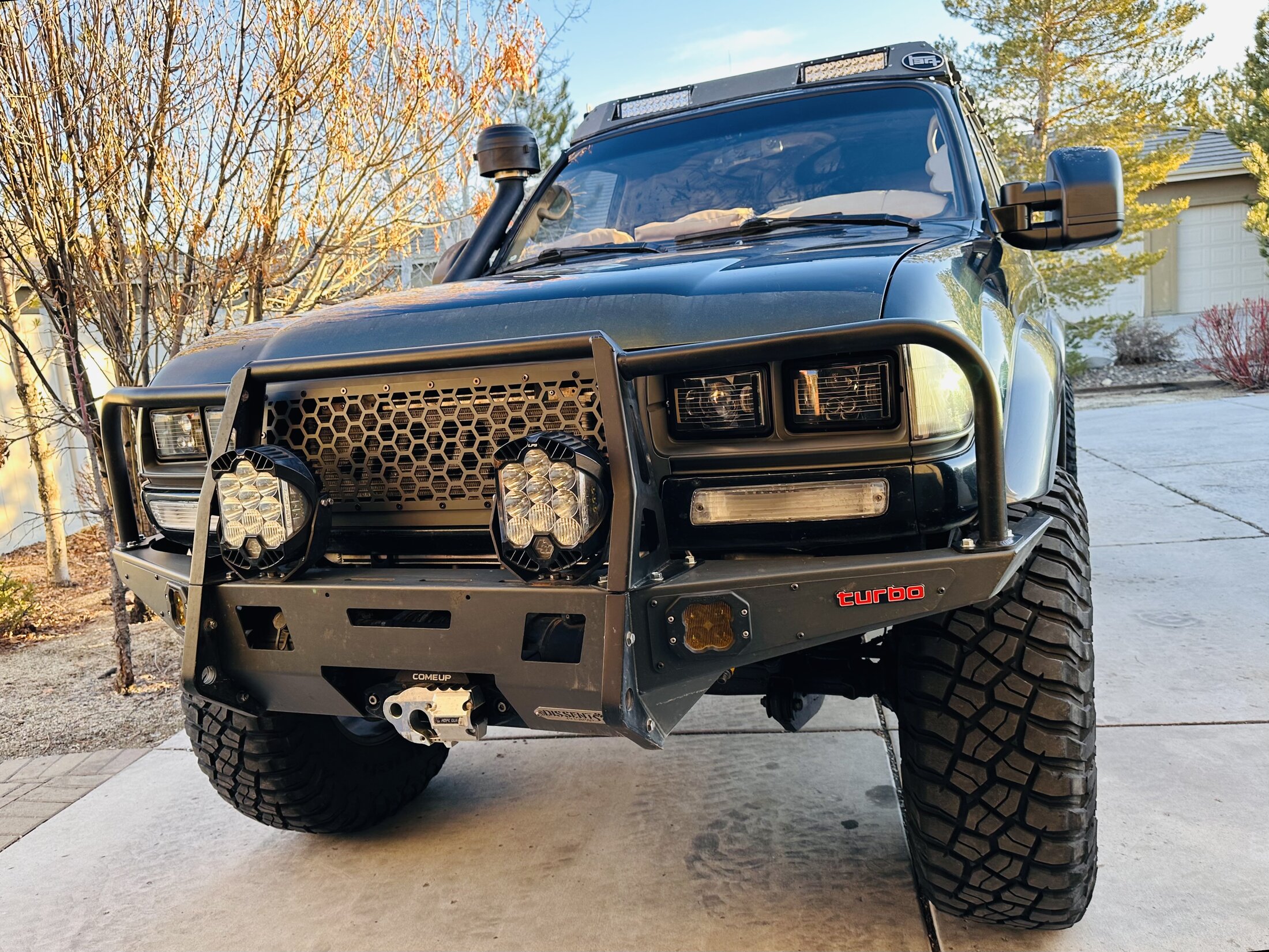

I've repaired my mirrors multiple times with Solve Function and Wit's End bits but after the passenger one went "spinny", I'm done fixing them. I just installed a set of the Clearview Compact mirrors I mentioned earlier and, except for me breaking off a mounting bolt, the install went flawlessly and they are rock solid. The convex glass takes some getting used to. Their adjust-ability seemed limited at first but I've adjusted them properly (front door handle barely visible in the lower inside corner) and they are working fine. I do find myself glancing to the corner of the door now and then and have to train my eyes to come back a few inches. Once I get my Landtank seat extensions in, they will feel more natural.
