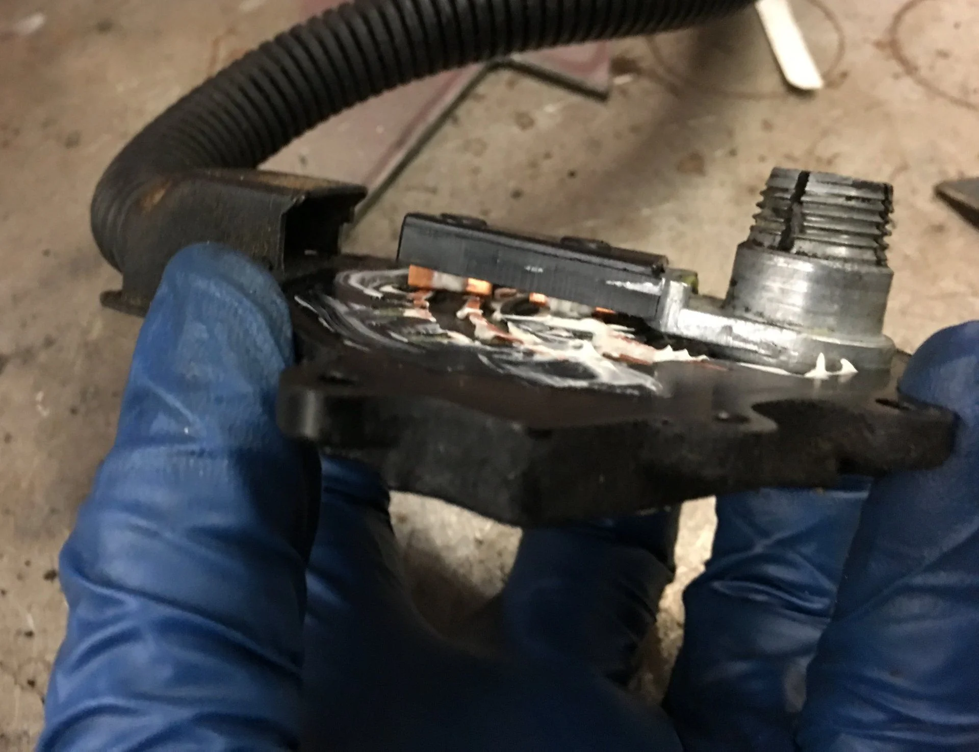

Hi guys, I thought I would post a few pictures of my NSS cleaning that I did.
Symptoms I was having before doing this:
No reverse lights on both the dash and out back.
Slipping in hard reverse.
Long time for the trans to go into reverse.
Occasional no start in park.
All of these problems are now gone 100%

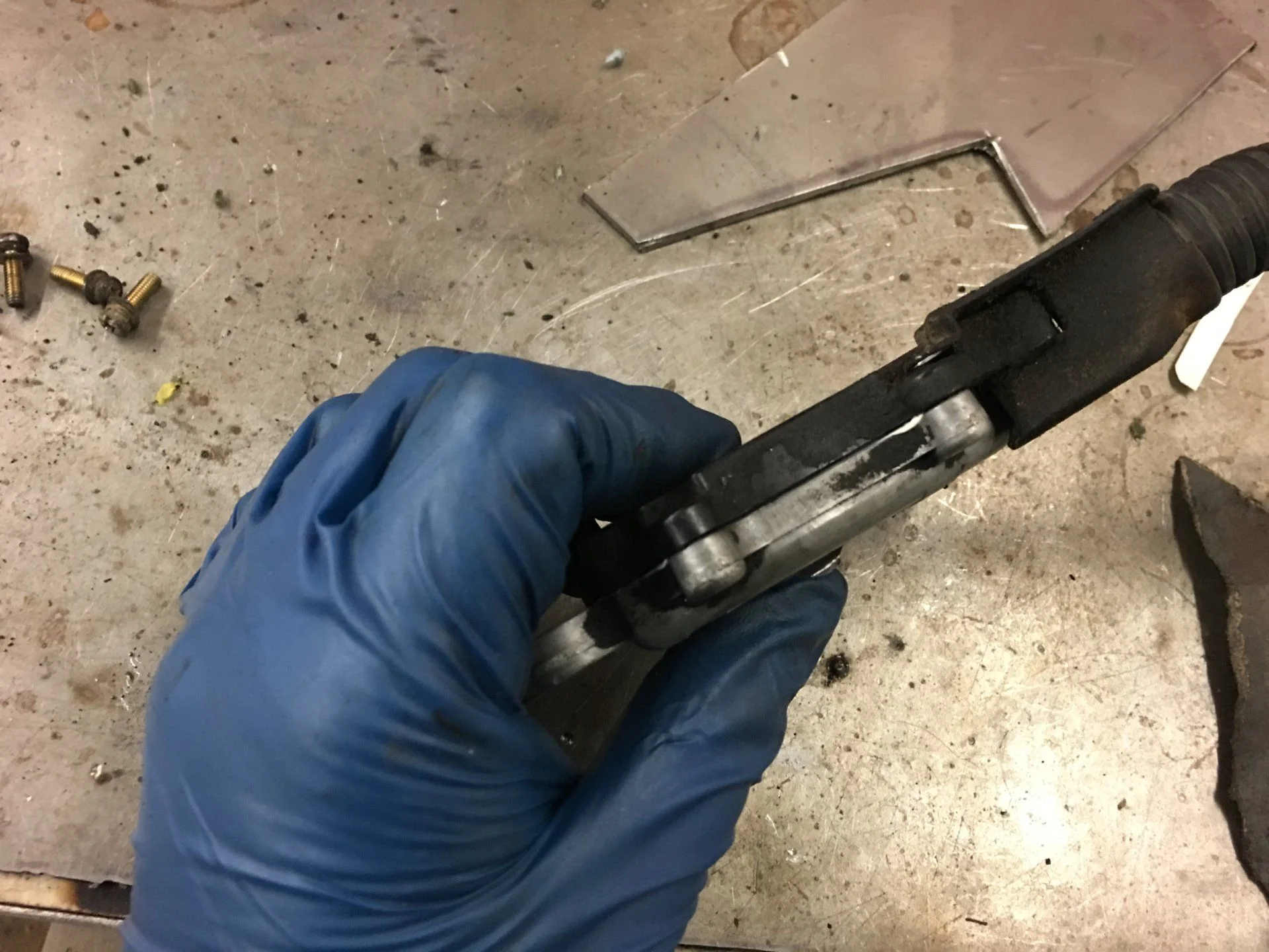

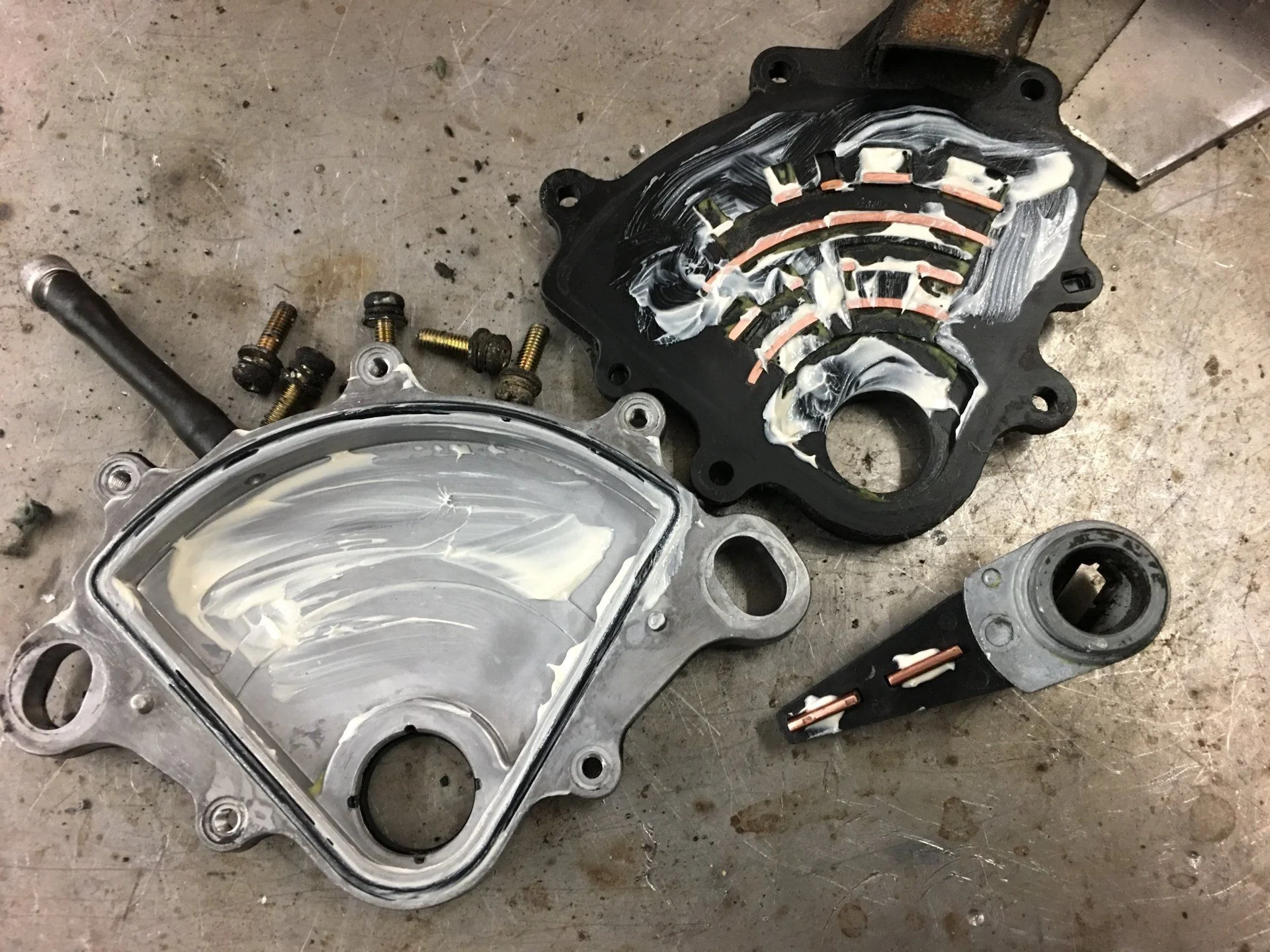

The photos you see are actually from my backup sensor that i bulled off my old blown transmission. The primary sensor I am now using I never took off go the car. I only loosened it in place. My advice is to just do this under the car so you don't have to bother with unplugging the thing. The plug on the A442F is way up by the top of the bell housing. If you have a 95+ I thing the plug is on the actual switch but I am not familiar. I would not be surprised if it cleans the same way. 2x 12MM bolts and one 22MM nut keep the sensor on the vehicle. The 22MM nut has a retaining washer with ears that need to be flattened to loosen the nut. The sense can actually be adjusted by just loosening the 12MM bolts but I will say this: if your shift linkage is adjusted properly than you should not really have to "adjust" the angle of the switch. It should be for the most part centered. I cleaned with brake clean and a pick to get all of the old goo out of it. I polished with 400 grit, and relubed with white lithium.
Pictures:

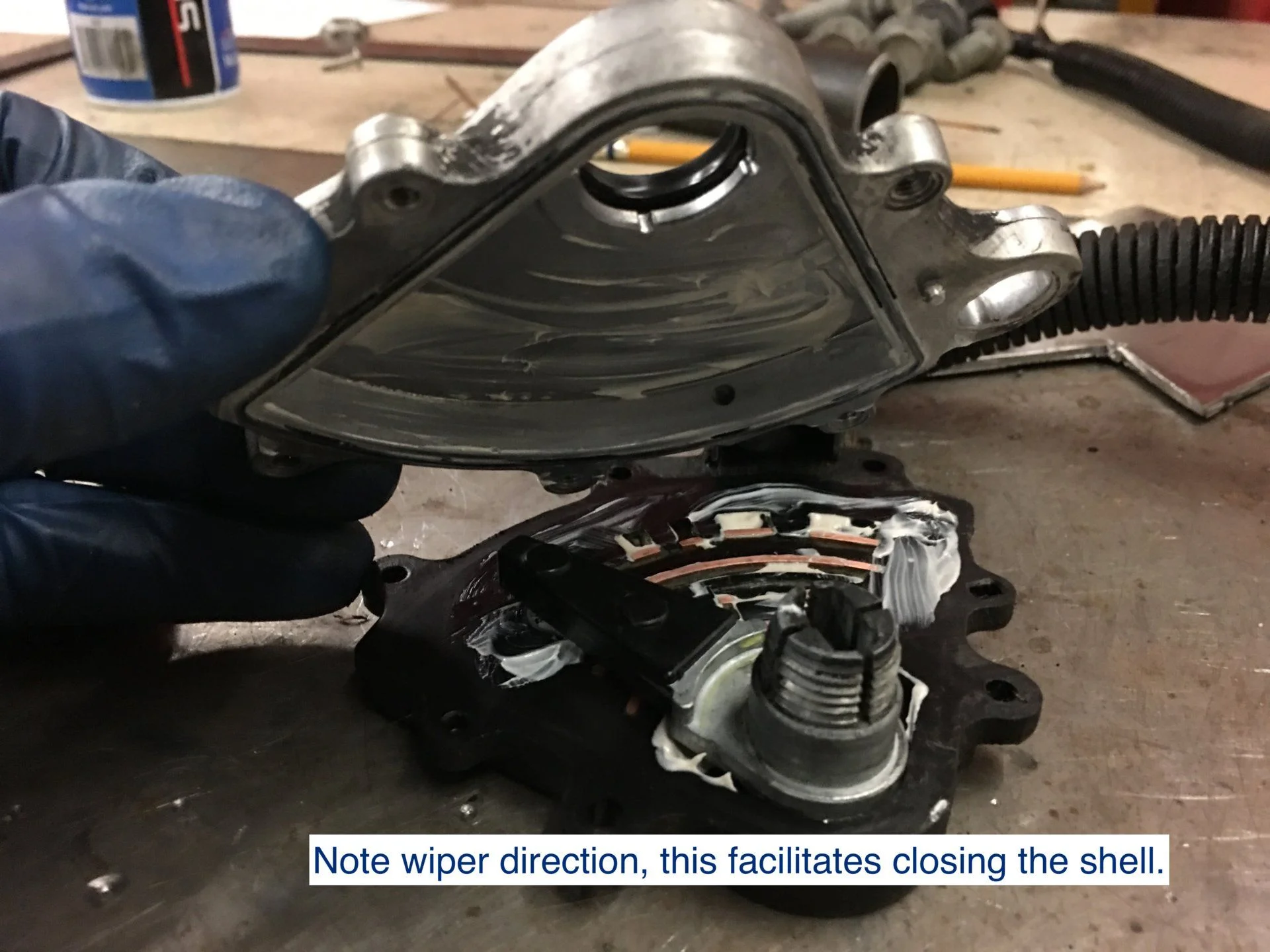

I did this under my 94. It's a pretty easy job, but there are tiny black springs under the contacts that are extremely easy to lose. If I were doing it again, I think I'd put down a large piece of cardboard for contrast and maybe an old towel to reduce the chance of them bouncing away if they pop out.

1. Clean and mark the NSS location with a razor blade before removing it ( make a mark on the side of the case) you won't have to adjust it when you reinstall it.

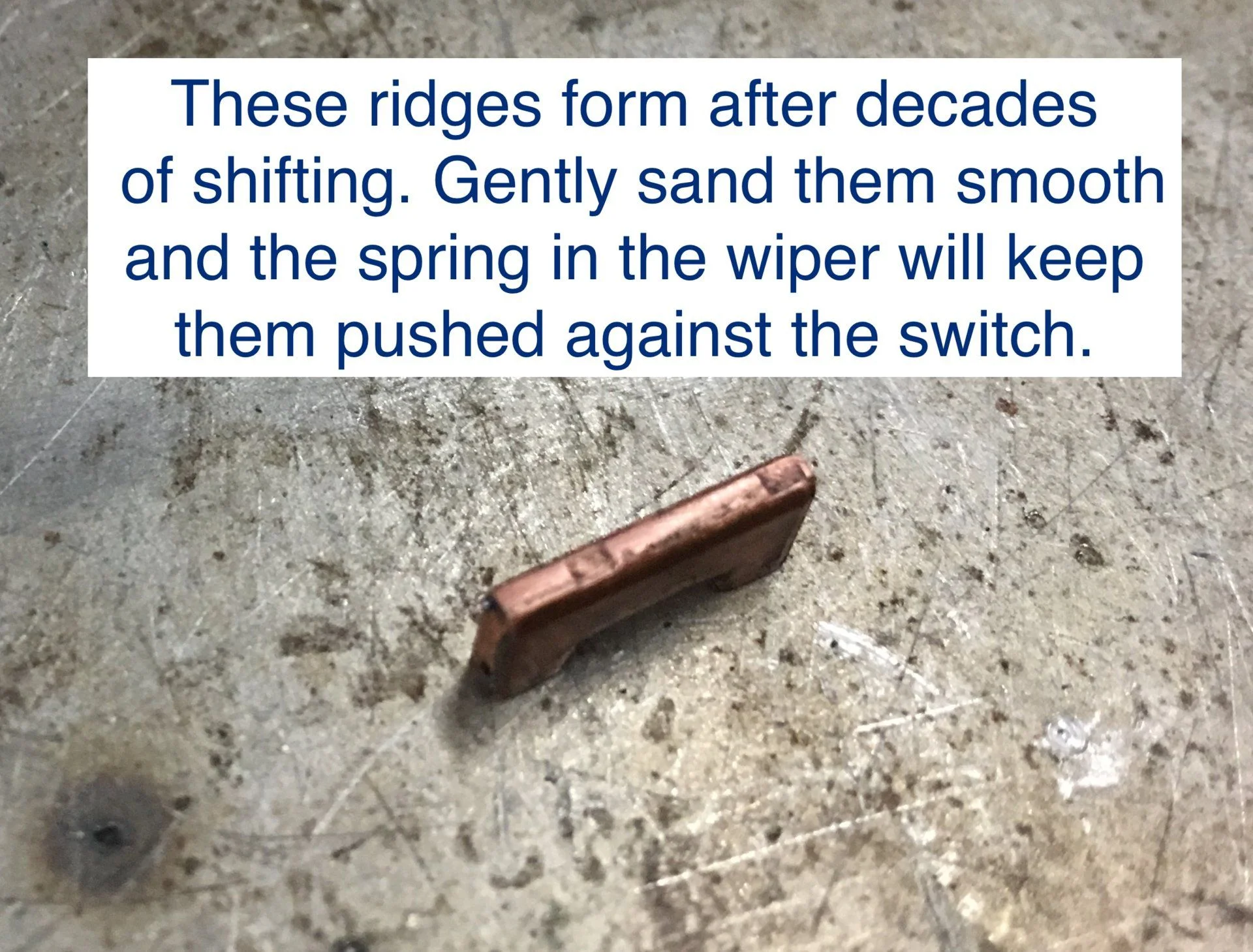

2 . You don't need to sand down the contacts, as you can see in your pictures only the top contact has grooves and they are offset, just flip the top contact over and you have new untouched contact material. You also don't want the contact to be sanded flat, if you look closely they are curved so they can slide smoothly on the uneven contact surface of the NSS. Thanks again!
