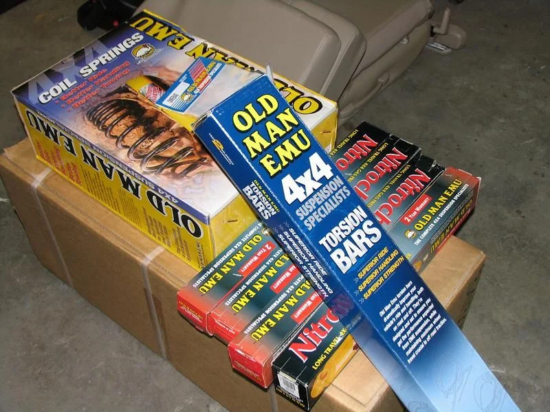

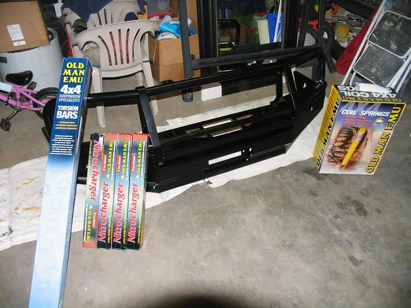

Okay now that some parts have arrived and I have something to take pictures of its time to start this thread. I got a 99' UZJ100 about two months ago, prior to this I had a very capable double cab taco. I loved the taco but the need to be able to carry more passengers got me into a LC. This is not my first LC, that was a 91 that was a complete lemon, I won't even get into that :mad: . The UZJ100 was a one owner, came with good records, was never offroad and never towed anything. I was hoping to call suppliers, place my orders and rip into this thing...Well it aint gonna be that fast due to some backordered items. So without further delay here is what I'm doing and the first of many pics!

Cool! :popcorn:
All I see are a bunch of parts laying around. :confused:

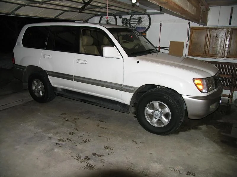

Got the front suspension done, will post pics when I get home from work. Everything went smooth, took about 2 hours. Also probably scraping the ARB rear bumper and steps and going with Slee steps and Slee rear bumper/carrier. The wife could sense some concern on my part about the ARB steps, she said just get what you really want! :bounce: :bounce: :bounce: :bounce2: :bounce2: :bounce2:

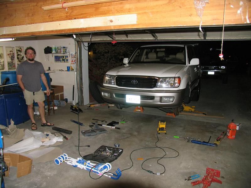

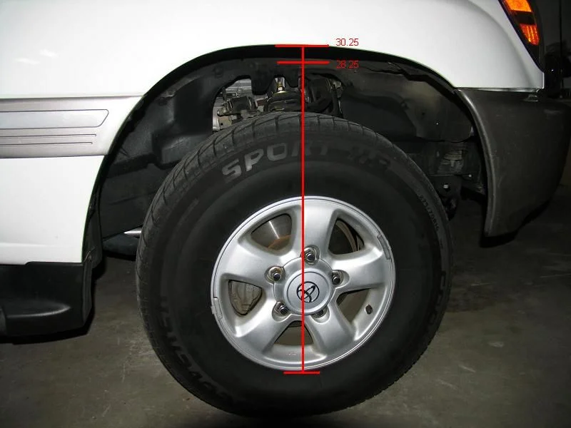

Here are some pics during the front lift, I didn't take any of the torsion bars as I think Bull documented that very well in his thread. When I go back and do the diff I will snap a few for everyones enjoyment.
My before/after measurements were:
Driver side:
Before 28.25"
After 30.25
Pass side:
Before 28.25"
After 30.25
Looks great! Nice job.
Did you do all that work in your mandals? I'd be afraid of getting black toe!
Also, it's interesting to see your CV boots leaking too. Hmmm...
What year is the pickup in the driveway? Reminds me of my old '93. I loved that truck.
