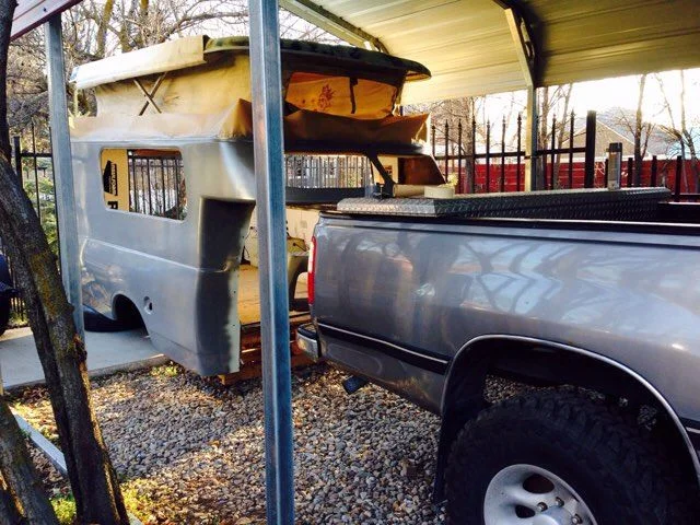

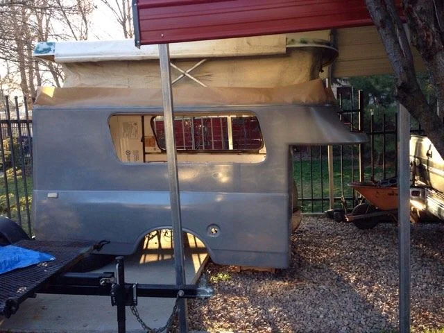

Put some color on the Chinook... Close match of the truck. Pop up roof will be a darker grey as well as a stripe down the side:)
