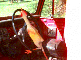

Theo/Scott thanks for the info. I did have a ‘72 FJ40 I sold some years back that I restored to almost factory condition (except for front bumper and wheels) with a cherry red paint job. The only pics I have are from a friends cell phone with a rubber chicken (it was a running joke with friends).
I loved it, but needed the money and my current ’73 was a total rust bucket and worth nothing. So after looking at restore costs like…
