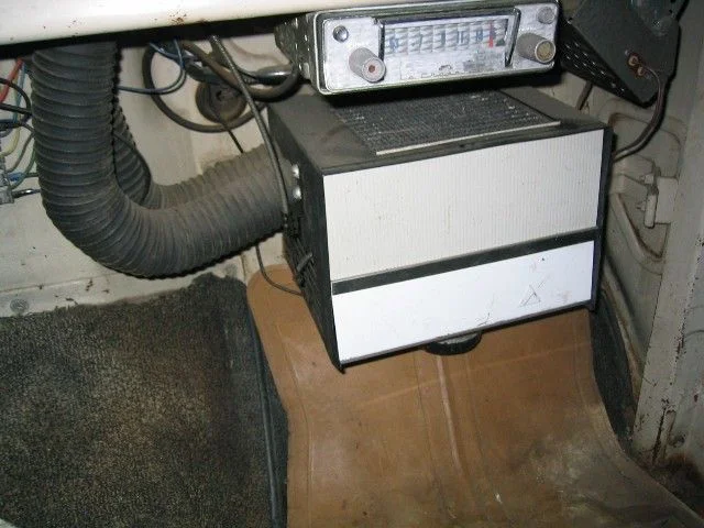

That thing is SUPER STOCK. Good to know stuff like that is still out there. Factory non-heater model not uncommon for that year. Have you determined whether it is an alternator or generator model?
:cheers:
On the left hand side at the top are two holes that hold the tubes that go to the defrost vents. At the bottom there are openings for air intake and hot air out.
Mine has a 2-speed fan and is noisy as hell.
I run mine on defrost because I have never spent the time to unfreeze the lever that moves it between defrost and normal.
You will like this. To adjust the temp you have to open the hood and there is a brass valve at the back of the motor that regulates the flow of warm water to the heater core.
Look like this?
First off
64's ROCK
(I got one myself if you can't tell by my username)
Thats where my heater was mounted also but if appears that the holes
cut in the firewall for the copper lines were not factory cut. I would
like to see what yalls looks like on the 64s.
