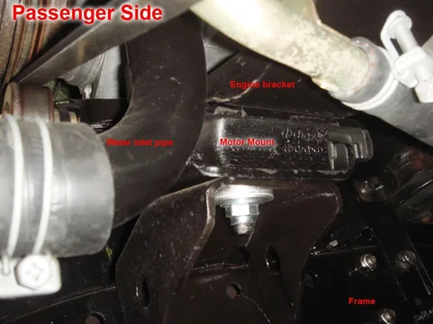

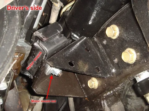

So I lifted under oil pan and didn't see a mount move. I know one is broken judging by fan and the fact that I drove around quick corner and heard a terrible noise that sound like fan hitting shoud. Also hit a bump and had same noise. Not sure what's going on. I took pics
Passenger-
Driverside-
Driverside covered in oil or steering fluid but I think PO replaced ps pump not long ago. No leaks and fluid always same level. Ds looks larger than other. That's if I'm looking at the right stuff. Lol.
I'm not recognizing the passenger's side photo (I have a '86)
But your driver's side mount is definitely messed up if the engine is lifting up like that when it's torqued.
You can't see the tear in the rubber if the engine is setting on the mount.

Here are some pics from a '86 for reference.
Take a wider pic of that passenger mount. somethings odd..
X2 that passenger side mount looks like it was replaced with a piece of rubber and a bolt. Not a stock mother mount. It may just be the pic but something looks wrong.

Thanks for info. Just a bad pic of passenger mount. I will try to change both mounts. It seems you need a good amount of clearance to get mount studs to clear.

I replaced my FJ60 driver's side motor mount, and the motor mount looks like it is sitting on part of the engine (?manifold). See attached pictures. Does this look correct? thx!
