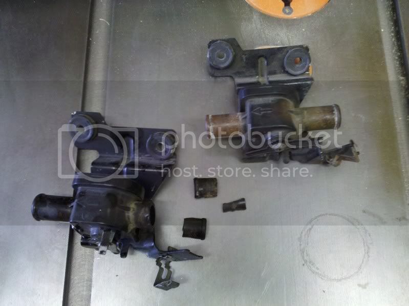

While working to replace the PHH hose, I removed the stainless steel tube that connects the PHH to the heater valve. When I removed the bent elbow heater hose off the heater valve, the end of the valve crumbled & disintegrated:
Thankfully I had reconnected my rear heater before last winter, and in doing so, I got a second heater valve along with the hoses I needed from a fellow 'Mudder. The spare heater valve I had looked to be in much better condition than mine which had broken down. I pressed on the nipple ends, and none of them felt the least bit brittle. Only time will tell how long this used replacement will last though; I may end up ordering a new replacement to exchange this one before it fails too. Here's the spare I ended up putting in:
And a side by side of the two valves:
Just a an additional heads up - it seems as though timing is coming due on these parts beginning to fail more & more commonly. :cheers:
