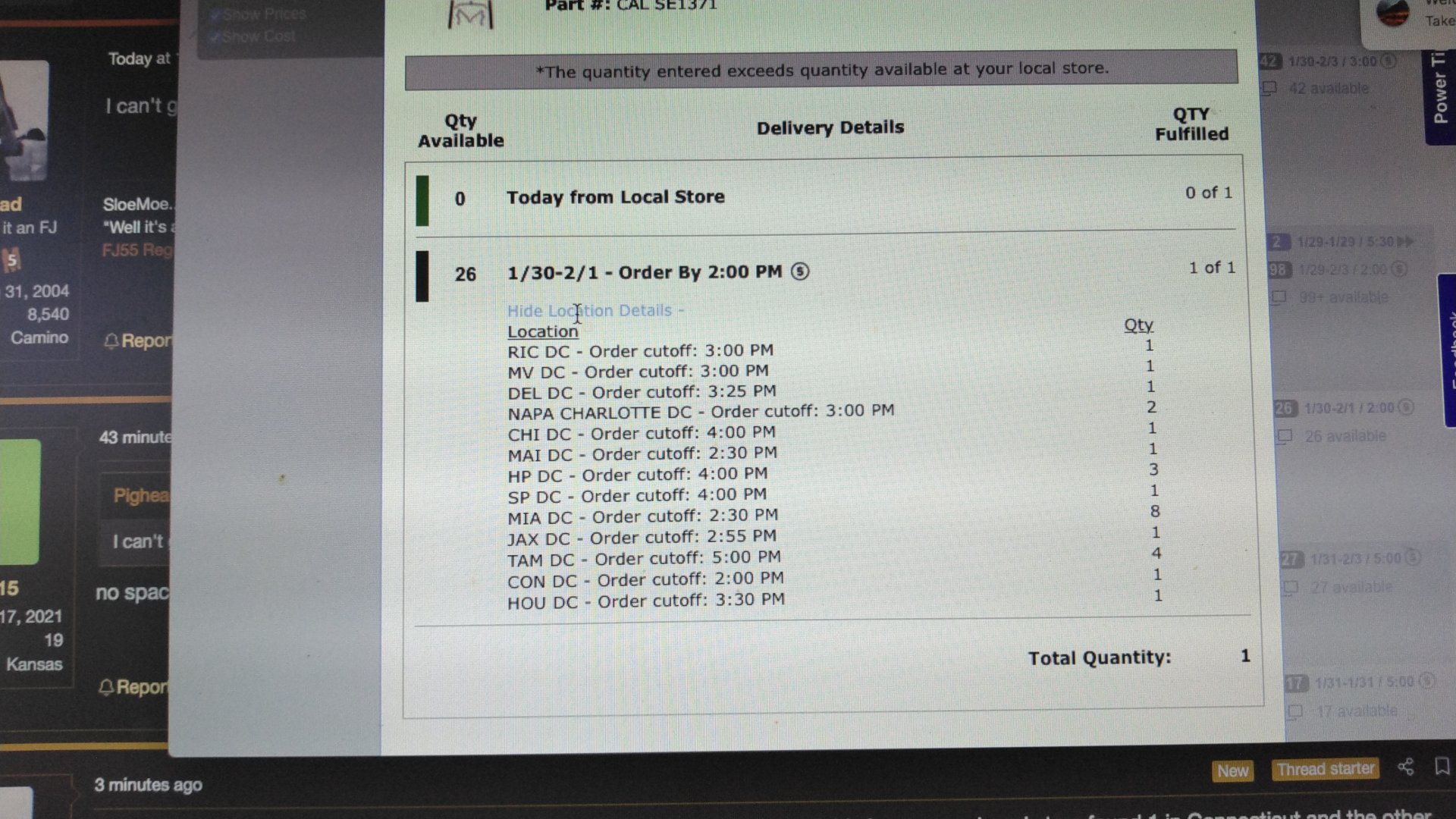

Weird, found the numbers looking up by application as a 85 pickup. Here's a shot showing application guide and all the inventory they've got spread out in warehouses across the country. Tells me I could have em both here by Feb 2.
