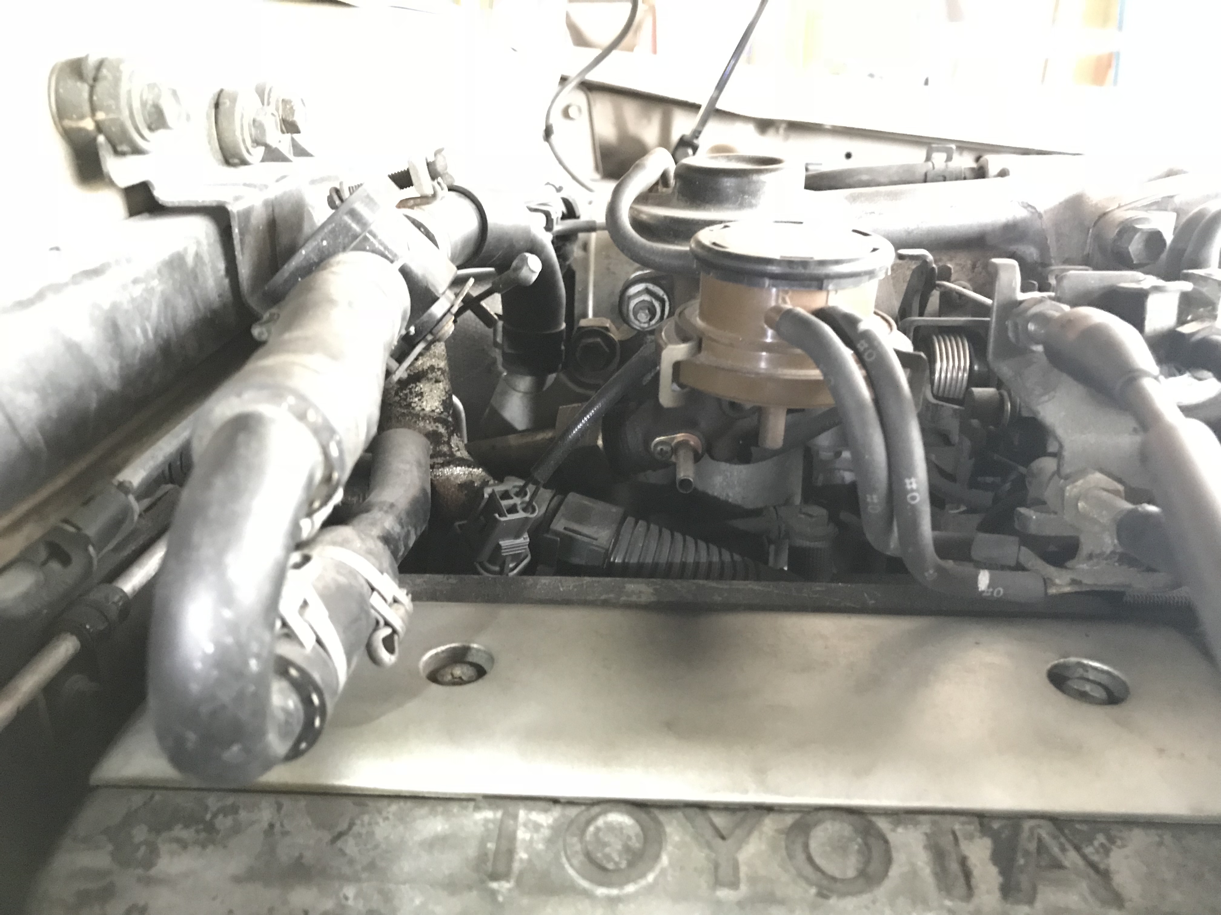

Over the weekend my check engine light on my ‘93 came on cruising down the highway. The idle is a little rough, but otherwise the truck runs great. I pulled codes, and it looks like I'm getting a code 71, which is the EGR sensor.

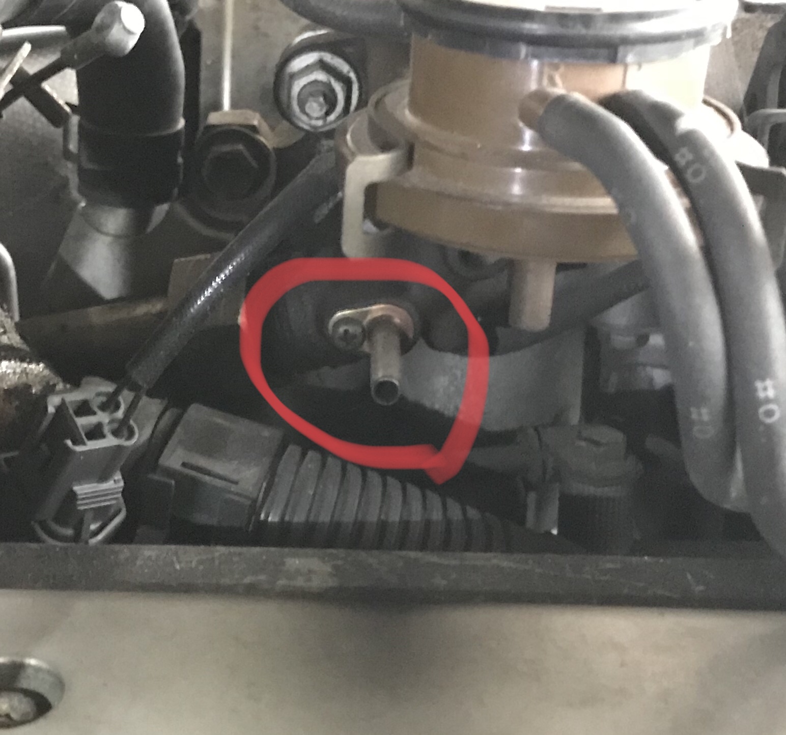

I also noticed a vacuum port on the EGR solenoid is running to atmosphere. Could this be the issue? Does anyone know where this line is supposed to run?
Also, I'm interested in deleting the EGR and PAIR system anyway. Would this be a good time to do it? Will I constantly get a CEL if I delete EGR?
Put a vacuum line back in place, clear the code and see if it comes back. If it does then short the two temp sensor wires together and call it a day (no more codes, EGR still in place). I also recommend capping the EGR vacuum lines if its not being used.
Thanks! How do I clear codes? Also, any idea what size the vacuum lines are?
Pull the EFI fuse to clear the codes. Not sure on the exact size but the EGR modulator (brown round thing) comes off easily and you can take it into the parts store to find the right one.
Use the code reader app you pulled the code with, or Torque.
All the vacuum lines are Ø4-mm (ID). That's 0.157-in in old money (or 5/32").
BTW, it'd be helpful if you'd either a) mention the year model of your truck, or b) put it in your signature line. Not everyone is following you.
BTW, that's a fuel line size hose.
This isn't the cause of the fault code, unless it fell off while you were driving.
