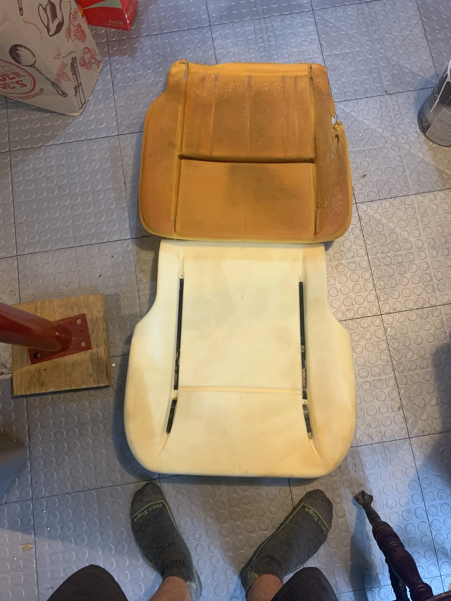

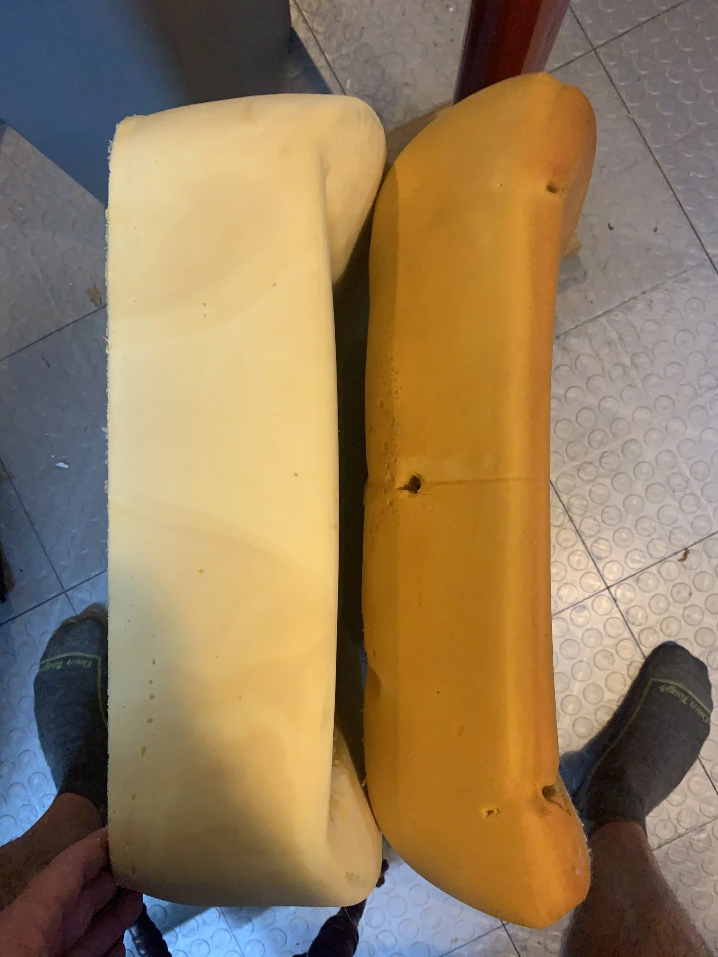

So just for a whim I measured the dimensions of the seat foam on the drivers side bottom. Turns out Dorman 926-896 is a good match for 75 bucks. I pulled my old foam and took a pic comparing the two. You can see it attached.

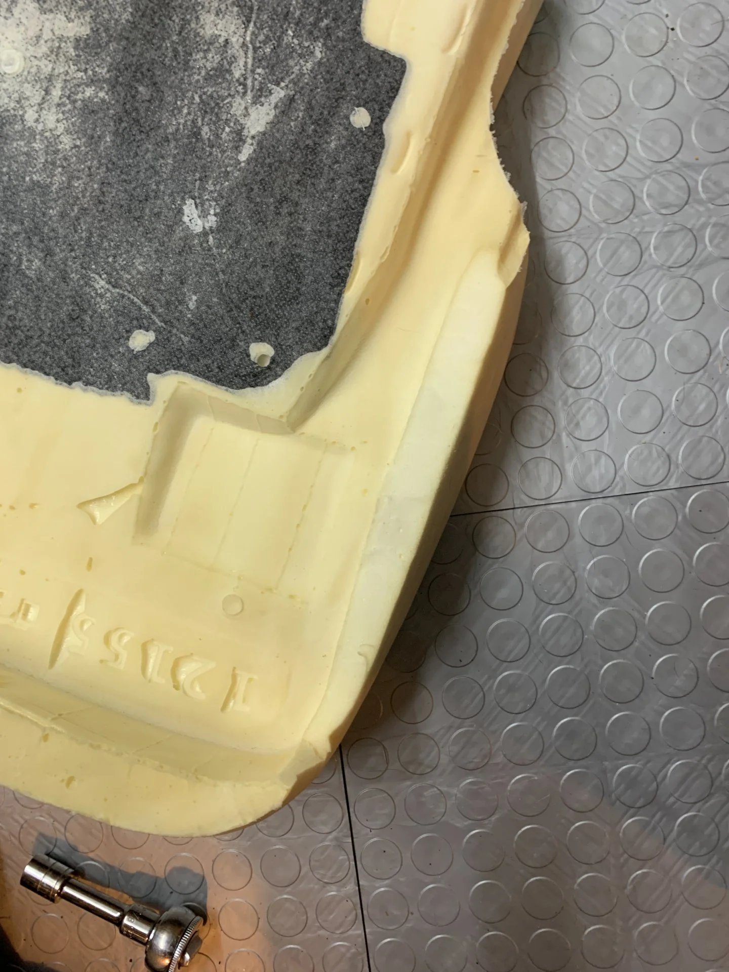

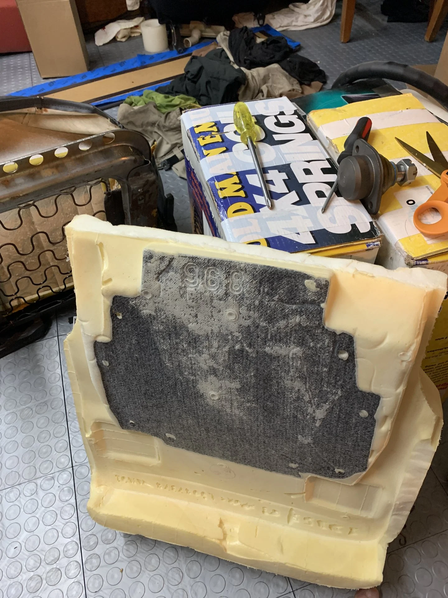

did you slice the center of the foam for the piece that goes down thru and attaches underneath?
I did not slice down the middle. I am going to trim the rear about 1/2-1 inches and reinstall. There is too much foam hanging off the front lip.

Couldnt find my hog rings and pliers so waiting on a new set. Ill update the thread once I have foam in and the seat in the truck. Probably late this week.

Cut the foam down about an inch from the end and trimmed one part that was over hanging a bit. It fits pretty good and for 75 bucks isnt a bad fix. I sat on it and it feels nice and firm. My OEM was smushed so I don’t really have a feel for what it is supposed to be like but it is better than what it was.
