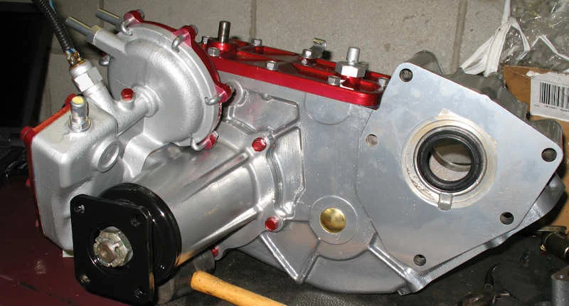

Here is a pic of the t-case I just completely powder coated... :grinpimp:

I like that! very nice looking! gives me some ideas for certain!
