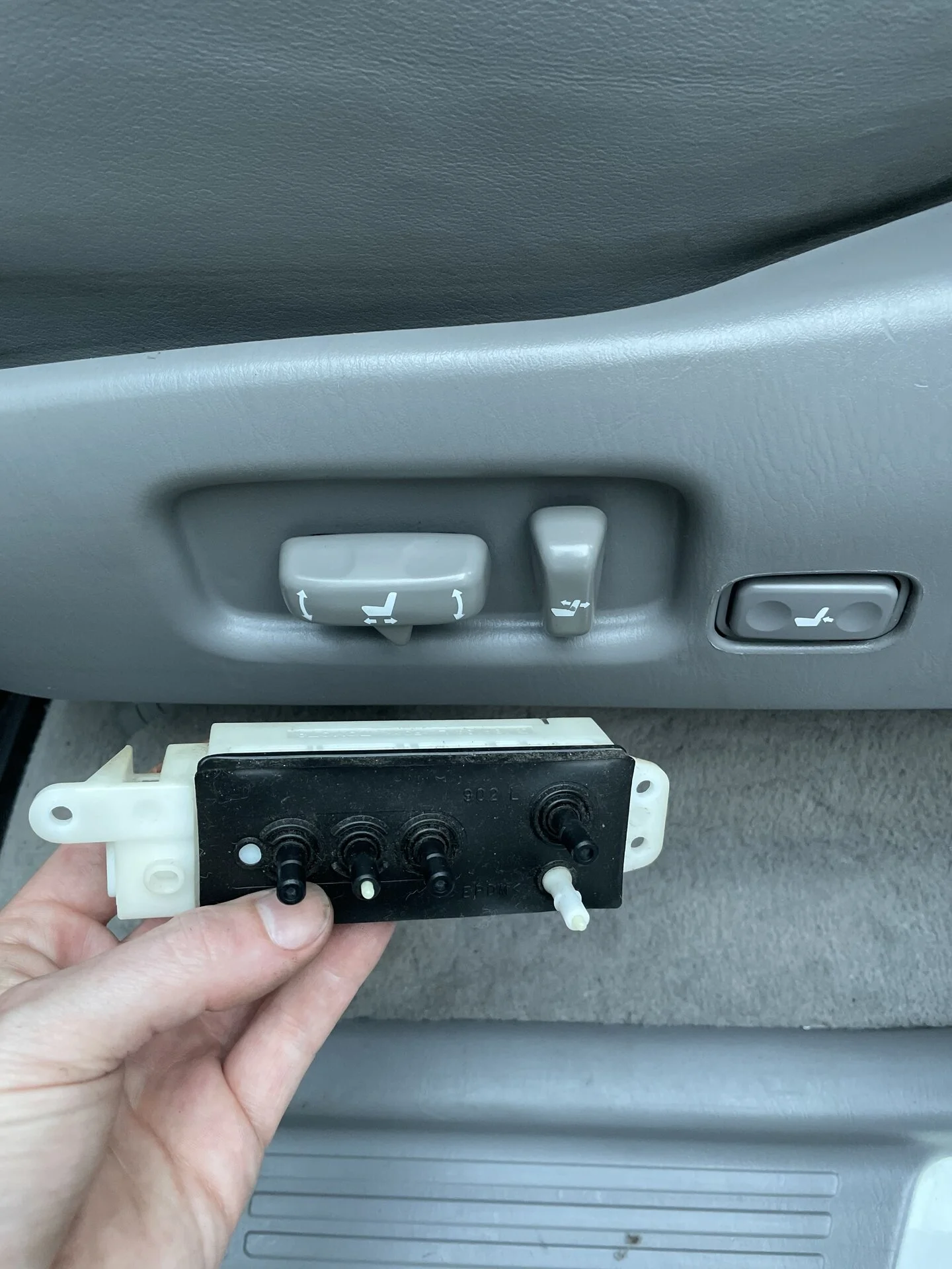

Just did a little repair, the front of the seat wouldn’t go down, the button actuator broke. Found a factory replacement for $95 in Dubai, it arrived in Virginia 5 days later and voila! 4 trim screws and three switch assembly screws. Did not have to take the trim all the way off either. Lexus wanted $550 for the whole repair lol

Partsouq or some other?
I did a test once, i ordered from mcgeroge ( usually lightning fast) and partsouq on the same day. The partsouq order arrived 1 day before the one from the US mainland. We live in an amazing world
I’ve had similar results.
I live a few miles from both a Toyota & Lexus dealer, and ~30 min from the Gulf States Toyota parts warehouse, but inexplicably it's cheaper and easier to order parts from McGeorge (~1300mi away) or Part Souq (~8000mi away).
