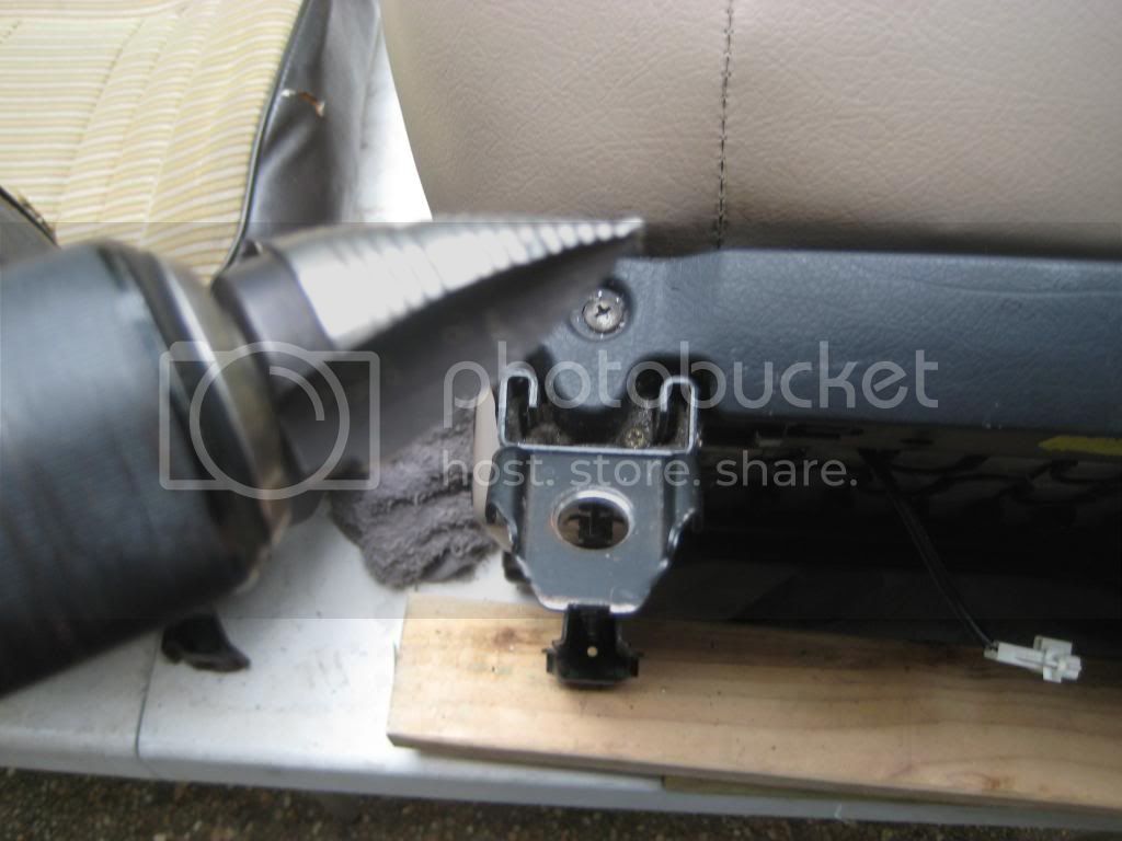

When I got home I set about putting them in the truck. The great thing about this swap is it is almost a direct bolt in. In the front I wallowed the Rodeo mounting holes out with an angled step drill bit and then I hammered the front tabs of the seat braket from a 45 degree angle to an almost 90 degree angle similar to the stock cruiser seat. The rear mounts on the seat were wallowed out a little more sevearly then the fronts but never the less all modifications were done with a cordless drill and a hammer. I bolted the seat in for a test fit before pulling it back out to spray a little black paint on the wallowed out holes.

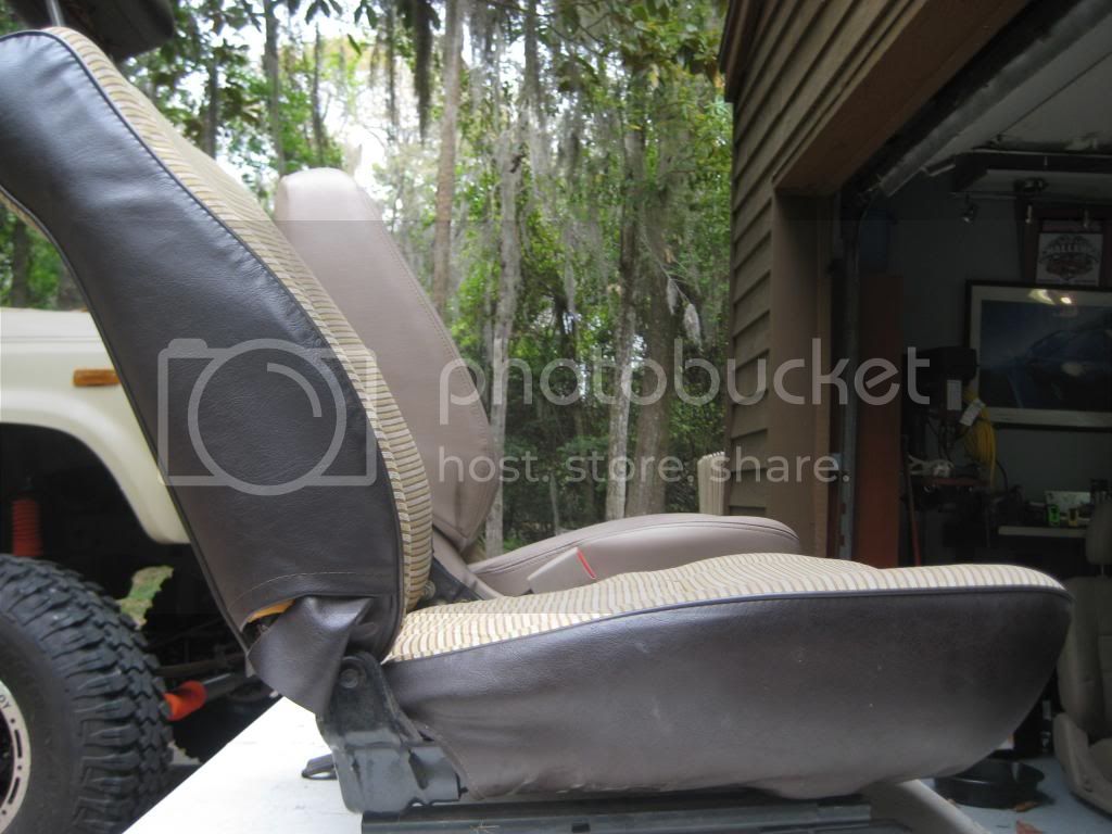

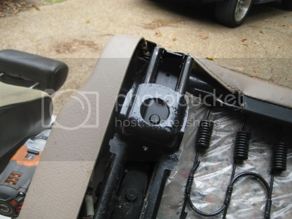

I have a bunch of pictures on my camera at home that I will add to this thread tommorow. I took them as I was doing the install to document for anyone else looking to change out their seats..Here are the two Ipictures I took with my phone..
The seats are a great upgrade over the broken 32 year old seats I removed. The only drawback, other then them being power, is they are about one inch taller then the stock cruiser seats. I am 6'4" and I still have plenty of head room and I fit in them quite well.

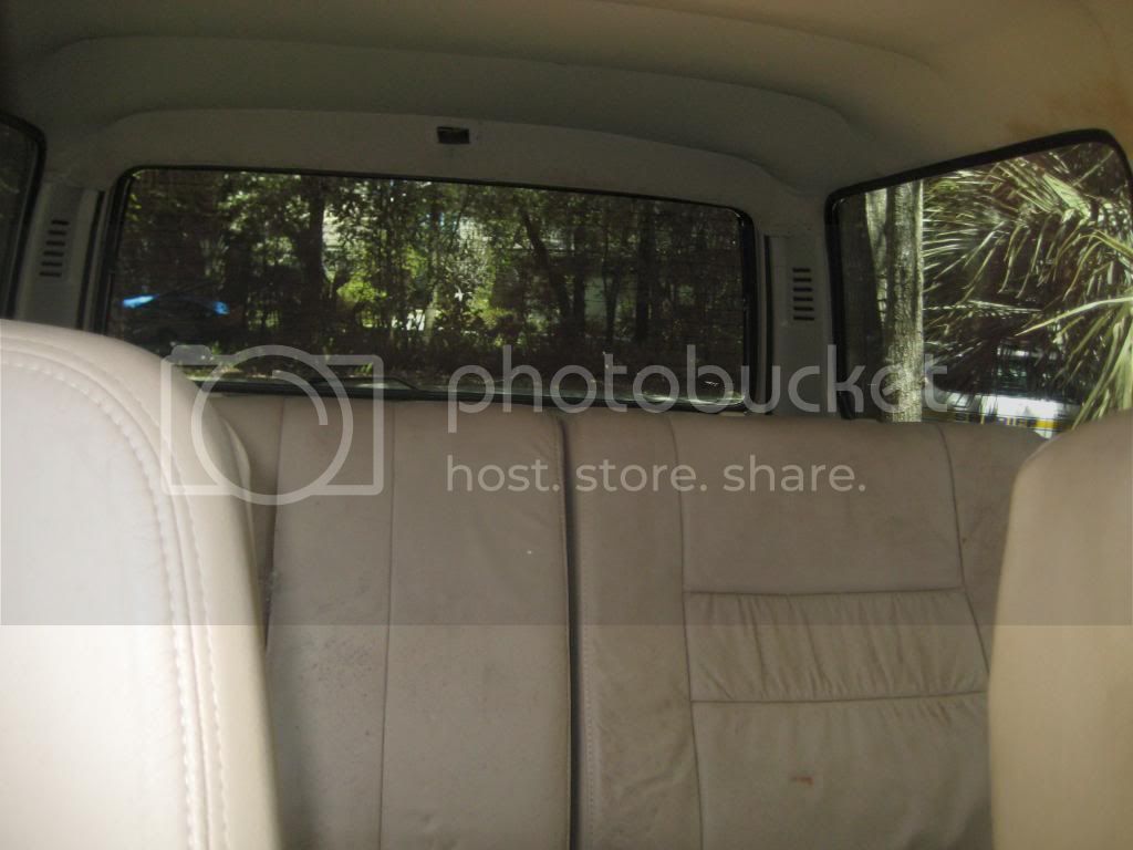

I am going to try and adapt the rear seats to the Cruiser tommorow when I wake up. Unfortunatly making the rears fit will probably be a bit more in depth. I have been thinking of how to do it without modifying or welding on my truck for the past couple of days and I think I have a pretty novel solution in mind. I will keep this thread updated as I work with the rear seats.

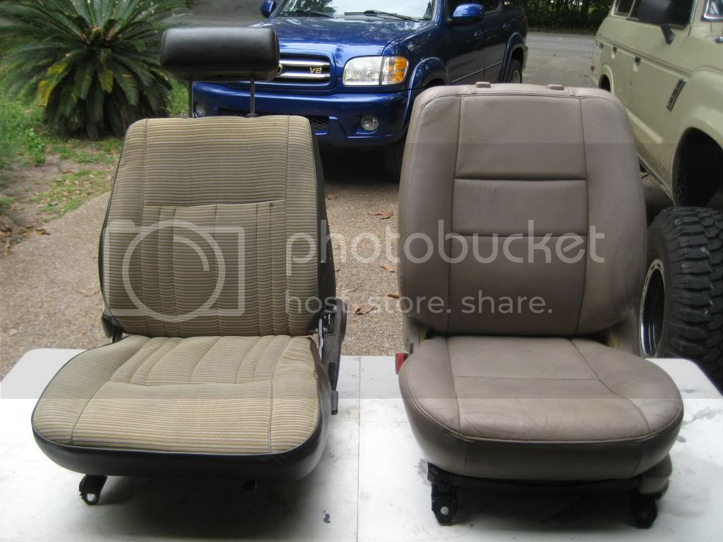

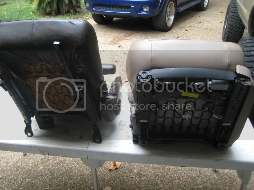

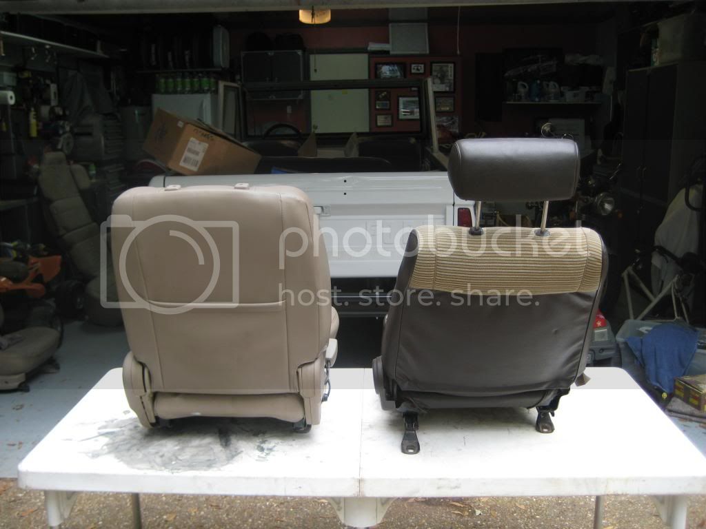

Here is a comparison of the two seats side by side...
If I remember correctly the holes were 5 mm off on either side relative to the Toyota, which is why I wallowed them out...
Here is the wallowing out in progress...
Before...
After...

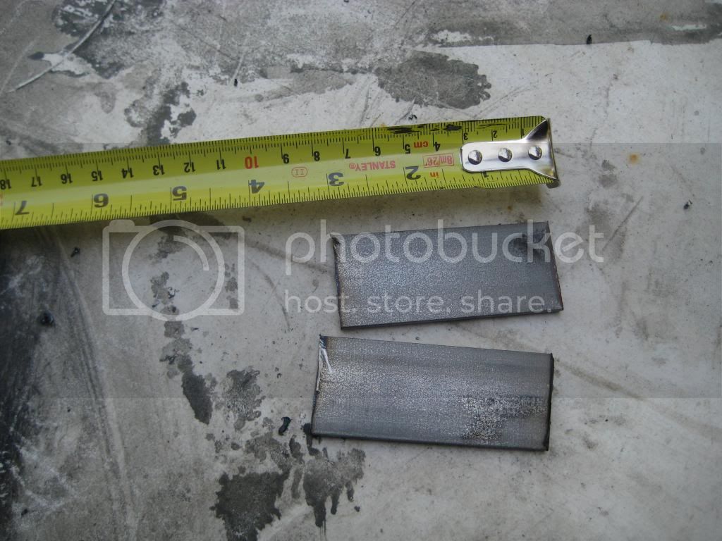

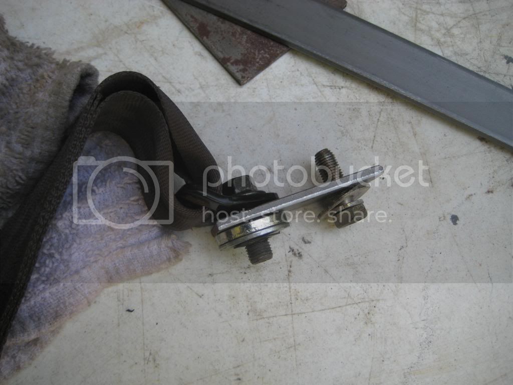

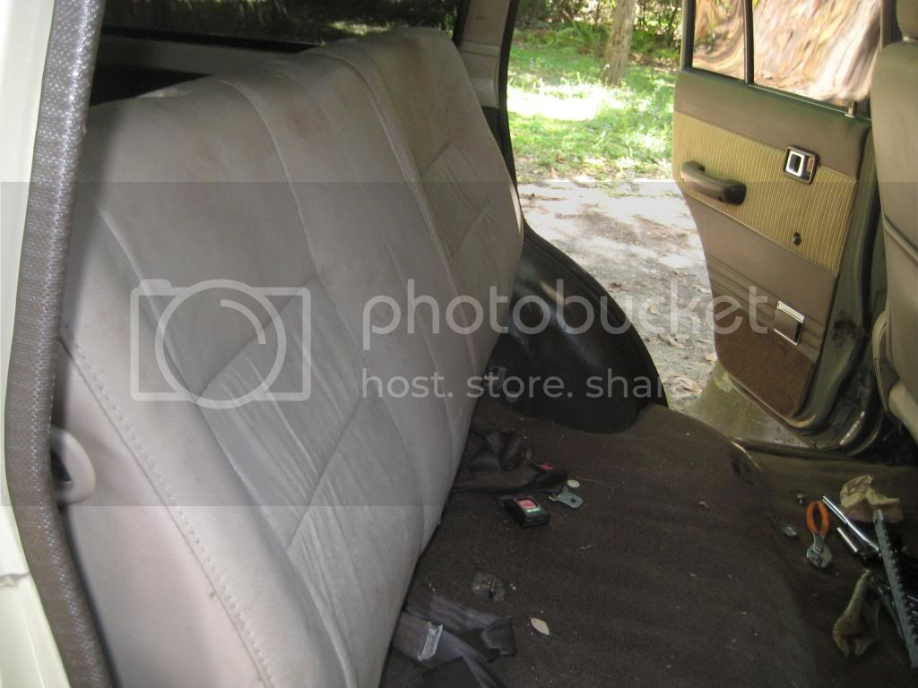

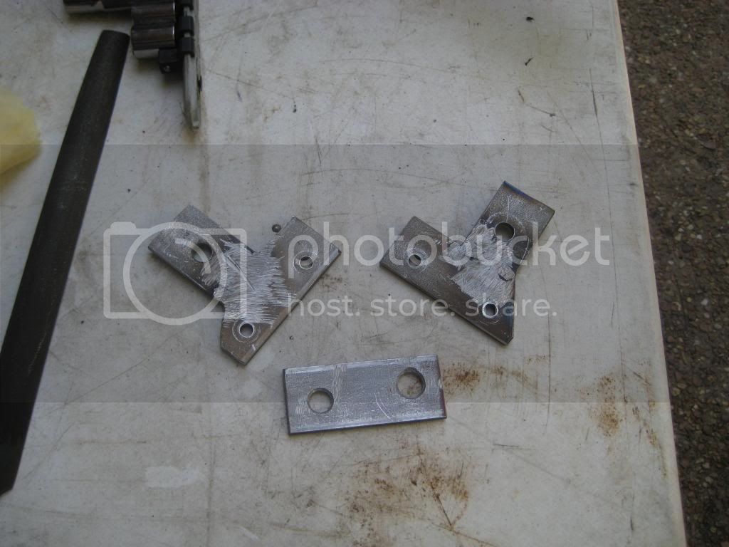

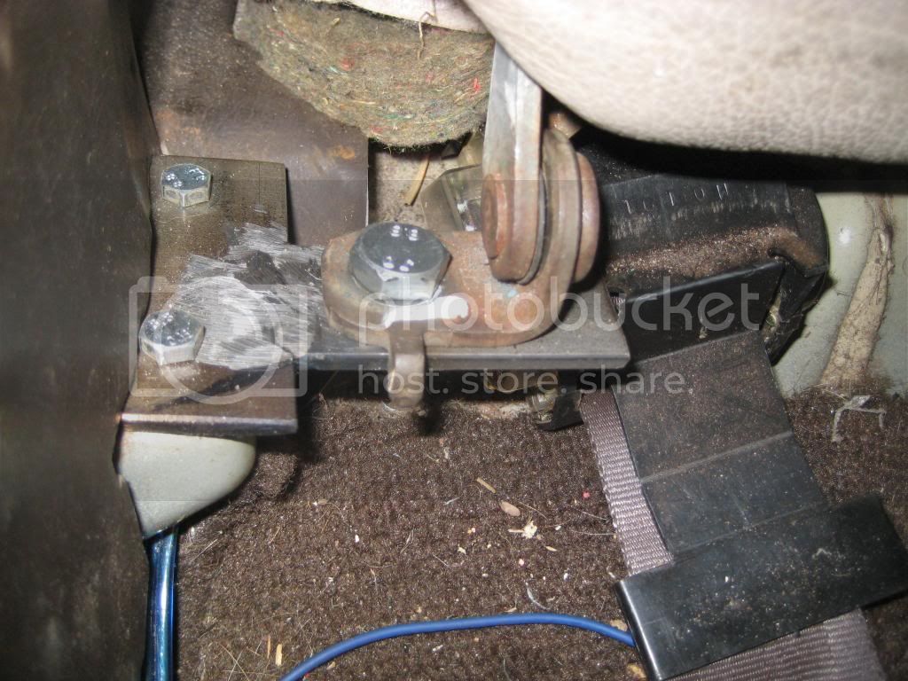

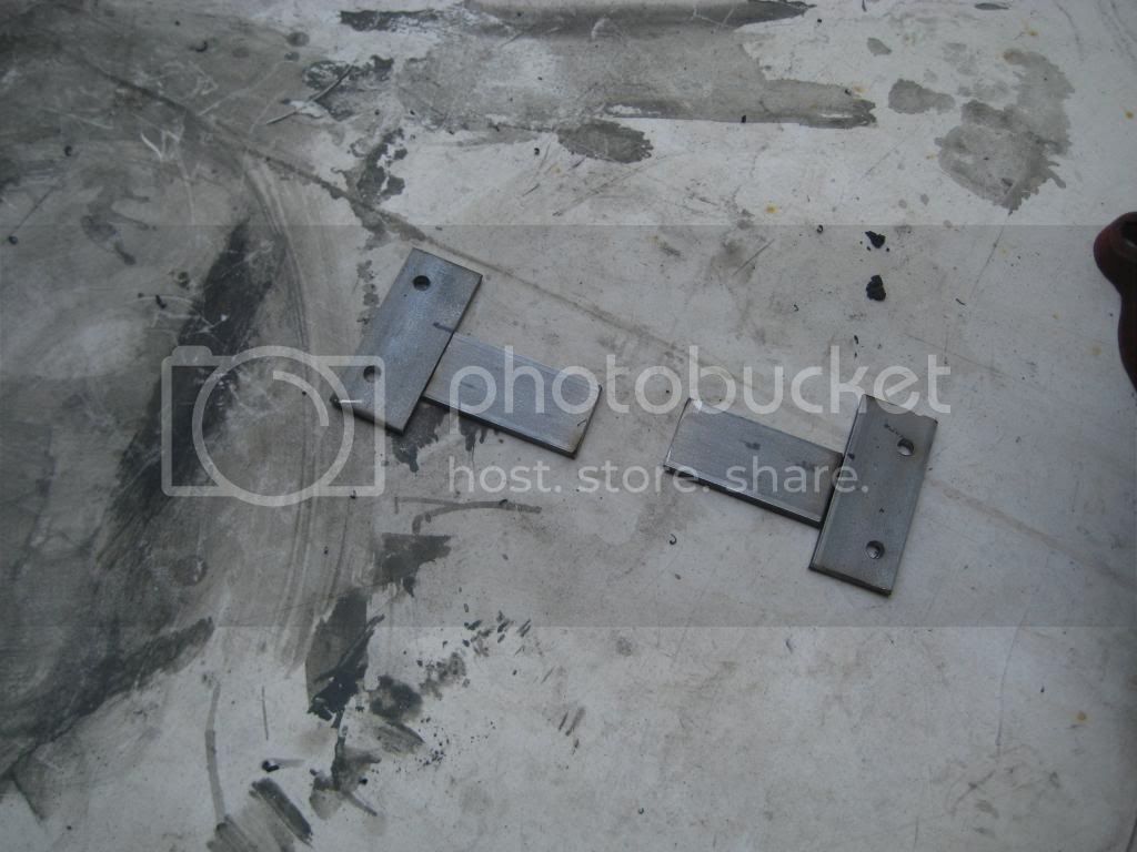

The back seat looks as if it is going to work. I am pretty stoked because I am going to have almost new interior for under $120.00. So far I have spent 100.00 for the seats, $6.00 for two trailer extensions (for the under seat wiring) and $6.00 for a piece of steel from Lowes to make the rear seat brackets.
The brakets I ended up makeing are real simple and they allow me to utilize the stock Toyota seat mounts and the existing Rodeo hinges. If you buy a three inch wide piece of steel you could make the brakets with out a welder. I am cheap and have a welder so I used inch wide flat steel.
I should finish up the seat bottoms tommorow. I will post up some pictures of the finished product when I am all done.
Incredible! How does the seat-back stay put??
I attached a metal rod the same diameter as the stock toyota one to the back of the seat. It attaches the same way the OEM Toyota one does with the lever on each side. It works out great so that you can fold it flat to extend the cargo space.
