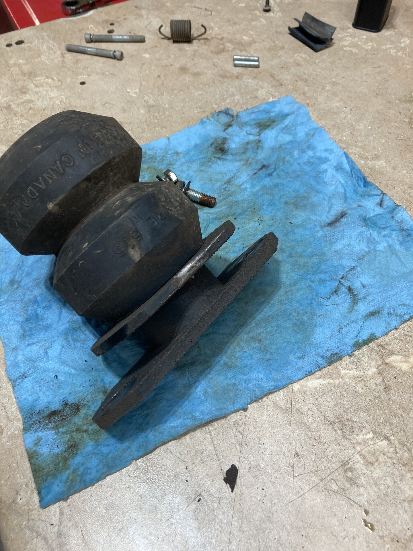

Had a mystery clunk myself. Found it when I tore everything down. Ended up being my springs making out with the timbren bumpstops:
Shiny spot shows the rubbage.
