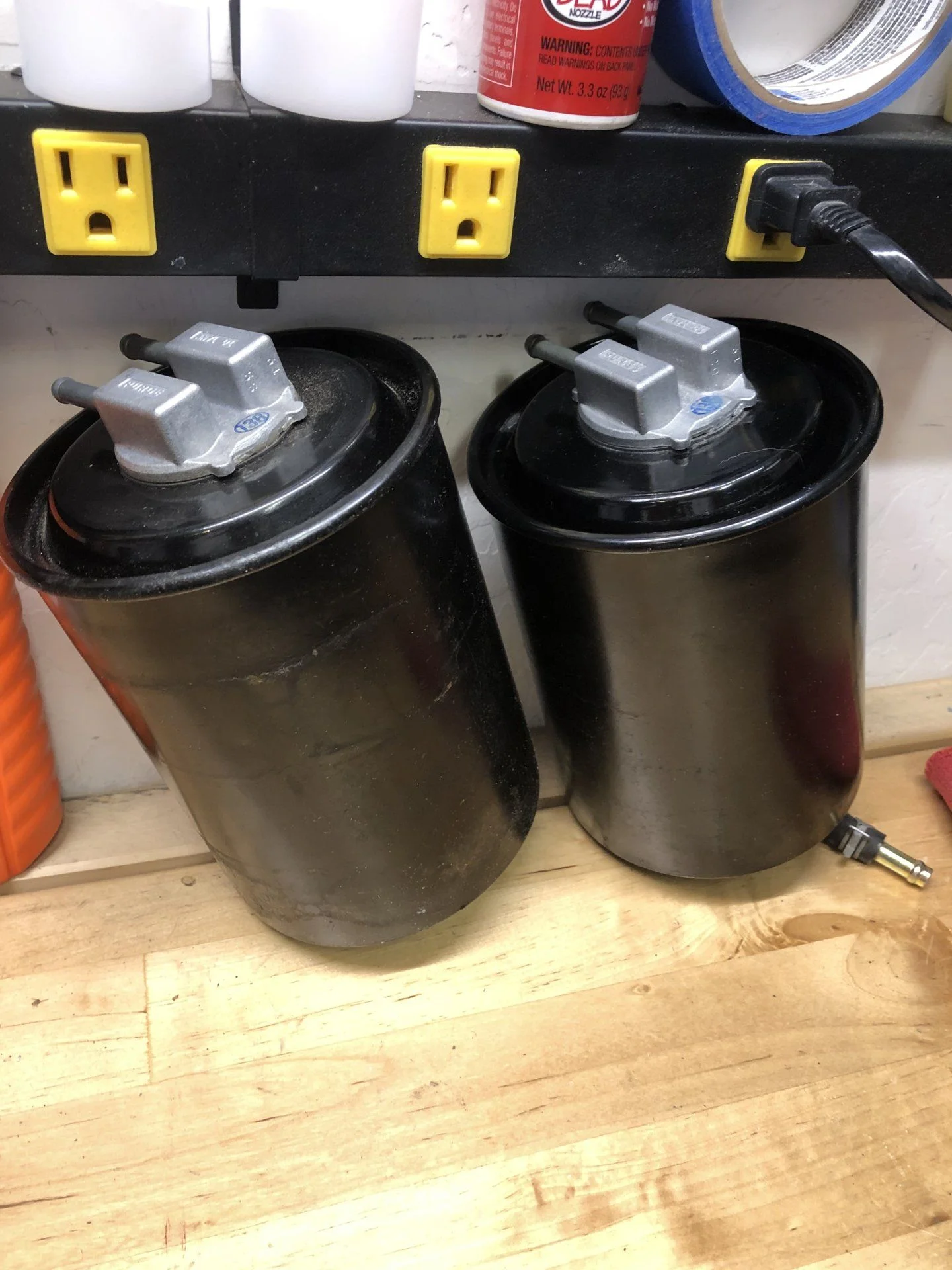

This is a good thread on CC tear-downs/rehabs in the hundo neighborhood: Charcoal Canister Replacement Option - https://forum.ih8mud.com/threads/charcoal-canister-replacement-option.1006708/

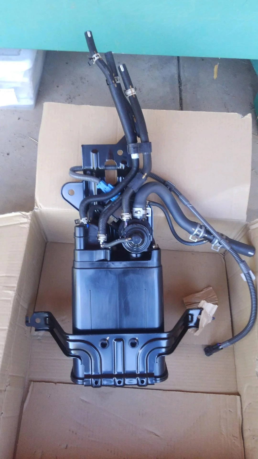

My current pursuit: I bought a cheap but brand new Prius CC, which looks darn near identical to ours. Have not installed, but have heard from credible people that it's drop-in levels of sameness to the gold plated version they try to sell us.
Oh, go figure, I just clicked "buy now" on the Gold plated version from a Japanese vendor. :lol: :bang:
Take heart. The time and aggravation you've saved yourself by doing a simple rip-and-replace--instead of a deep dive into charcoal canister barnyard engineering--is worth the money.

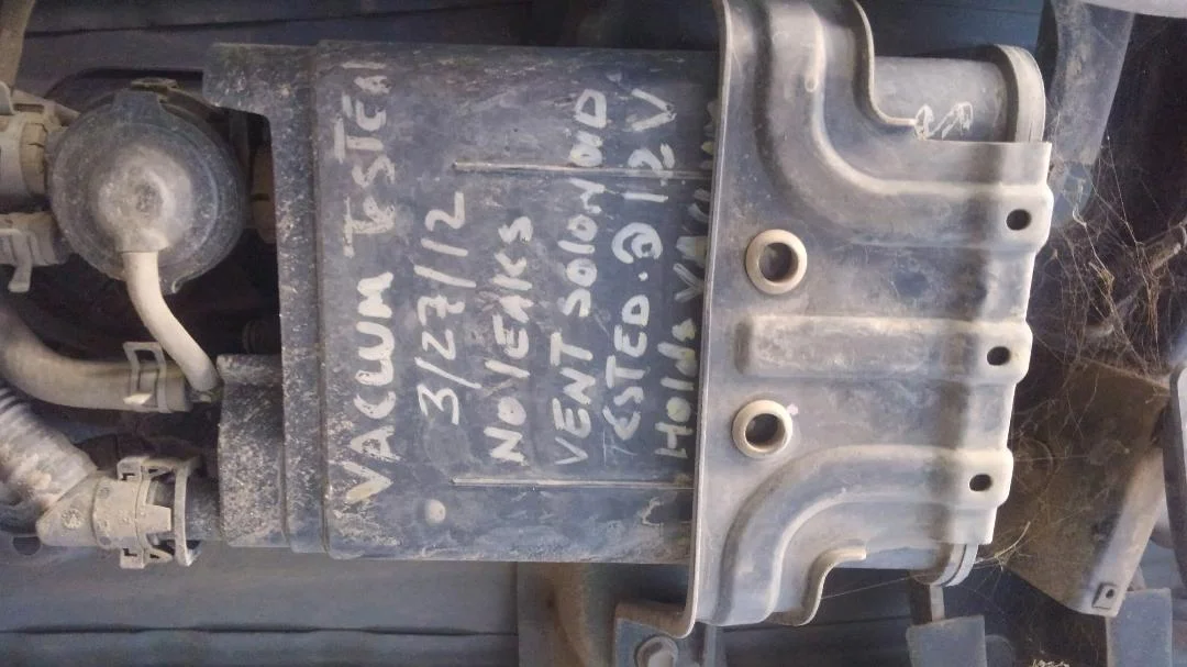

After I dropped the spare it looks like "Barnyard" or probably more like "Junkyard" engineering. The previous owner was a mechanic and the vehicle belonged to a long time customer of his and has serviced it since it went out of warranty then eventually bought it from her. Looks like he took a shortcut to pass emissions at some point.
Most common code is the usual P0440
Followed by a P0441
Occasionally a rare P0172 (caused by a rich idle after fueling up).

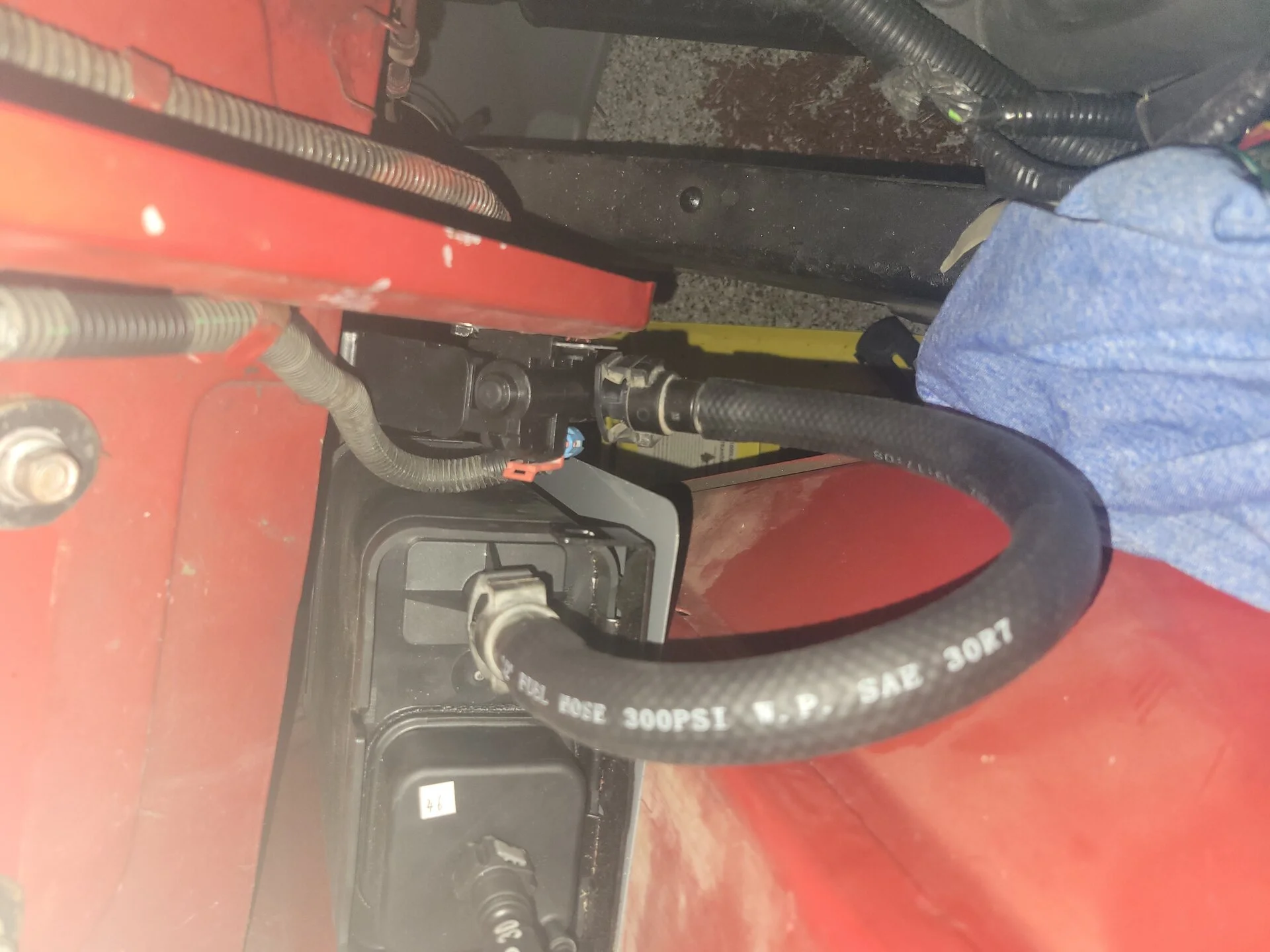

Swapped out this morning. The biggest pita was getting all those crusty, hard, old hoses off and someone tossed a differential in the way.
Think I have got that long term intermittent monkey off my back. First thing I noticed is the truck idles better. Then I went down to fill the
tank (this is where it would load up when starting again). No issue. Ran a forced evap system test with the handheld and Zero codes.
Time will tell, but I am pretty optimistic at this point.:bounce:
