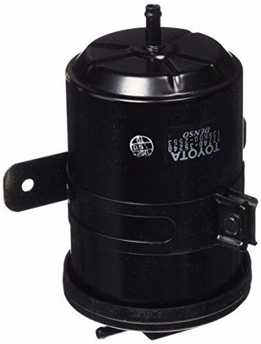

There are some Toyota (Denso) units available that will fit, but they're all well over $200 ... Which (to me anyway) is just too high for a can full of charcoal.
Thanks Spikestrip. That's what I wanted to know.
