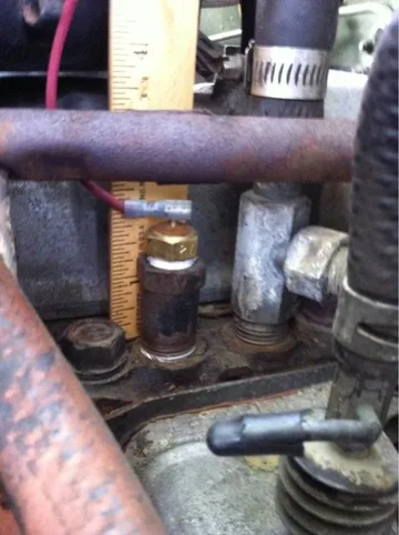

Here you go, also there is pipe tape. My gauge works fine "h" when off. Slowly moves to cold then about the first tic mark when warmed up.
Is that brass? Did you make it? Went to Lowes and looked at brass fittings and the only thing I could piece together was LONGER than the WTSU and it will not atually reach into the cylider head.....:mad:
Kill me again. PS before someone suggests it....I do not want to put an aftermarket one in.:lol::flipoff2:

No I didn't make it myself the cruiser shop here in Denver put that on for me. Also I think it's steel or some type of metal not brass. Check sor or call Mark. This should be a part you can easy make at home depot or purchase. We are not the first guys who delt with this issue. I had a thread a year ago here on mud "2f stays cold while at hiway speeds" goes through my journey of engine cooling issues. And this exact problem happened. I trust my gauge is correct and it's hot when off slowly moves to cold when started and stops at the first tic mark. I held that ruler in the pic to help give you a idea on length for that riser. I think once you get that installed and the early wtsu installed you'll be golden.
Saw this link searching mud...http://www.autometer.com/cat_accessoriesdetail.aspx?vid=66
also might try this part number at toyota :toy part #90404-16160
TEMPERATURE SENDING UNION
1/75-7/80 FJ40/55
Just need to make sure the wtsu doesn't bottom out on the block when installed with that union/riser
