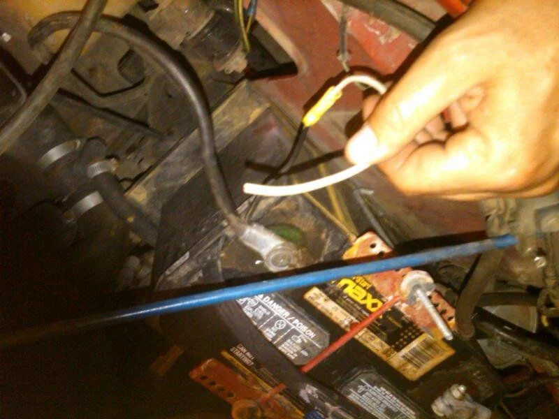

Not that far of a reach...I have a funny feeling this is supposed to be hooked up to something? This white wire is off the negative terminal and just hanging there.
PS not that scientific but readings never the less...

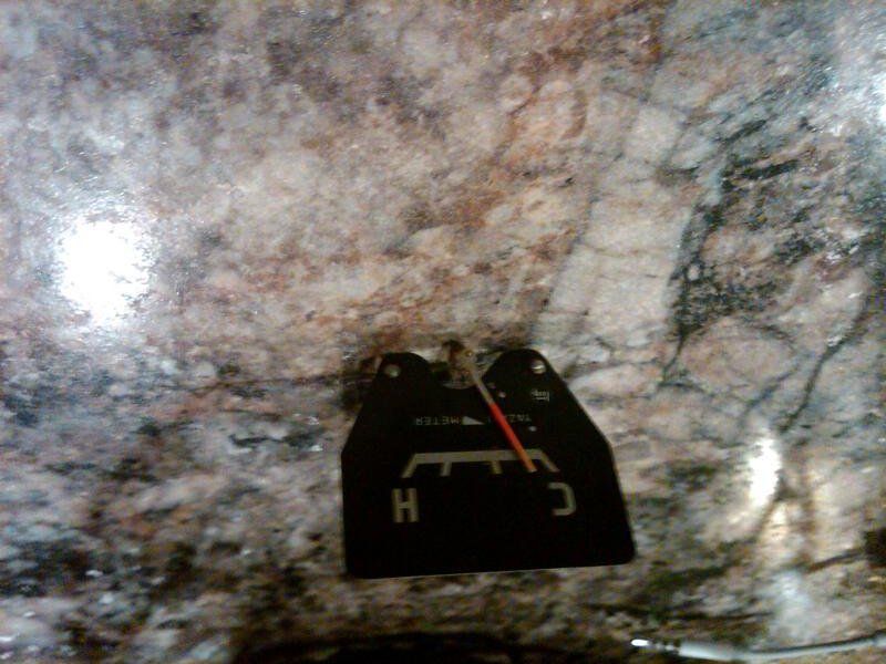

I do have a couple of these to practice on to see if the one in the 40 is good. How would you get the the needle to move? Have alligator clips
Randy
The FSM test for the gauge involves having the gauge hooked up in the instrument cluster, then unhooking the connector at the sending unit. Between that connector and ground, install a 3.4W bulb. When you power the circuit with the ignition key, I think the FSM said that the bulb will light, then start blinking after a couple seconds. The Haynes also outlines this procedure, can't remember if there's a picture in there that would be more helpful. The FSM has a picture of the setup.
To do a real temperature test, I would take the sending unit out, get yourself a pot of water on the stove and a thermometer, and take readings that way. But your numbers sound reasonably close to me, so the problem must be elsewhere.

That white wire looks non-factory to me...
I think the white wire was hooked up to the tach the PO had installed.
