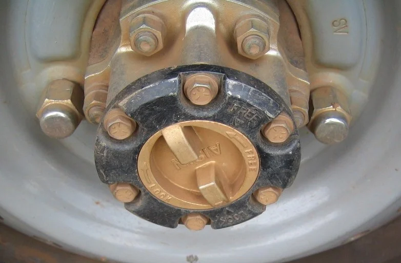

I think it's highly unlikely your vehicle has a part-time kit installed, but freewheeling hubs (FWH) are components which lock/unlock the outer ends of the front axles from the wheel hubs. They may be manually or electrically switched/actuated.
Manual types look somethig like this:
