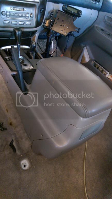

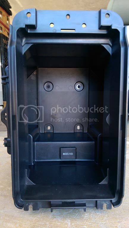

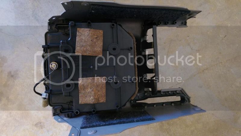

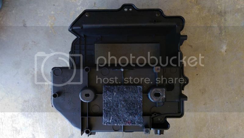

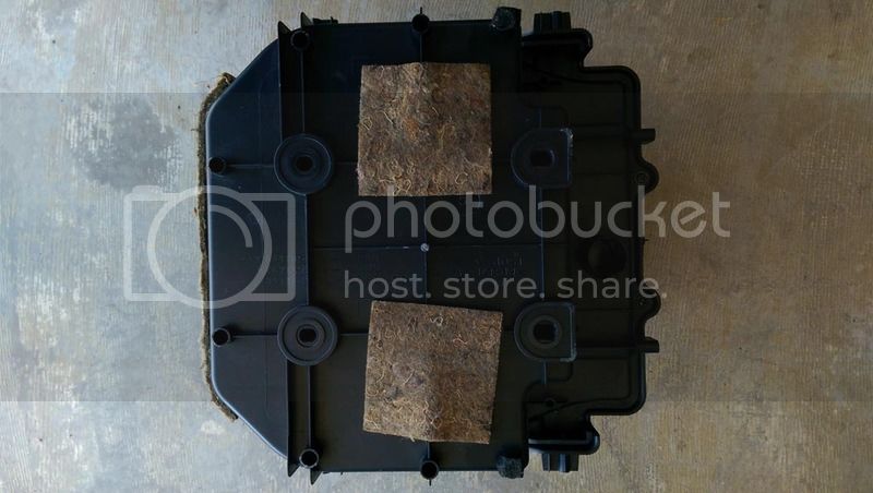

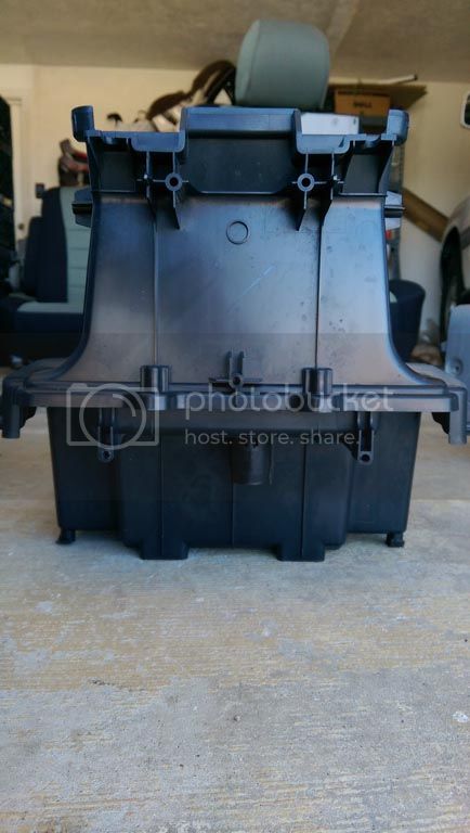

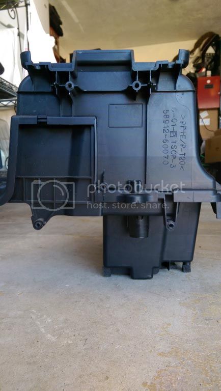

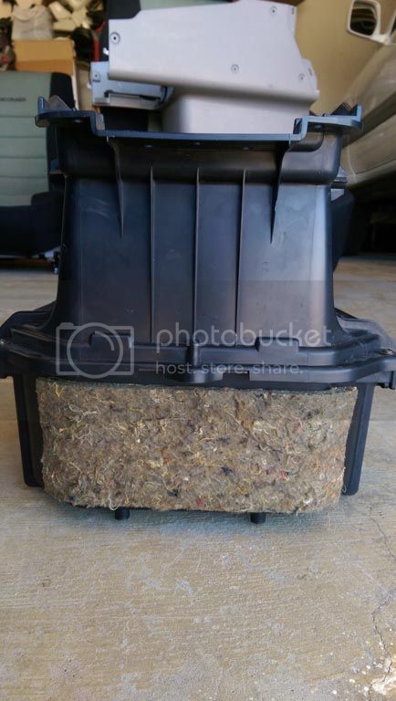

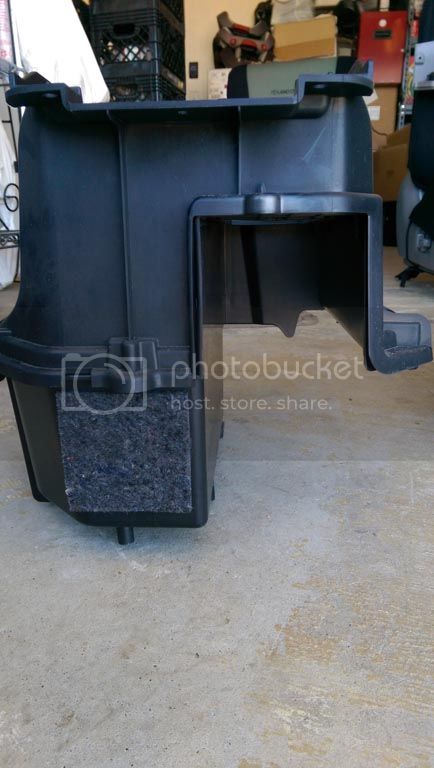

Here are some comparisons between the two:
Test fitting:

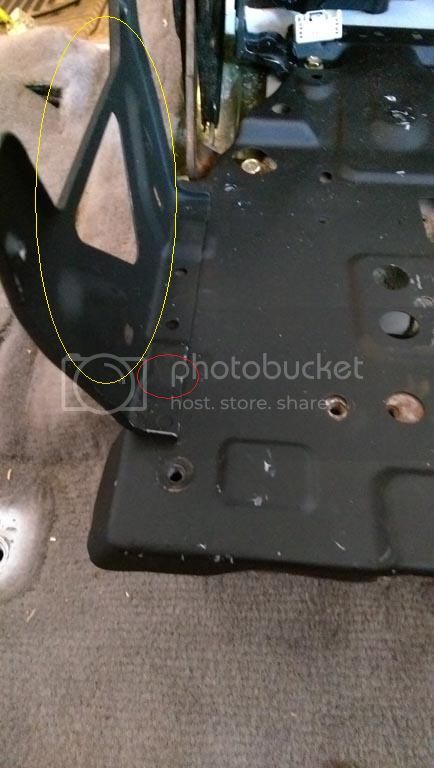

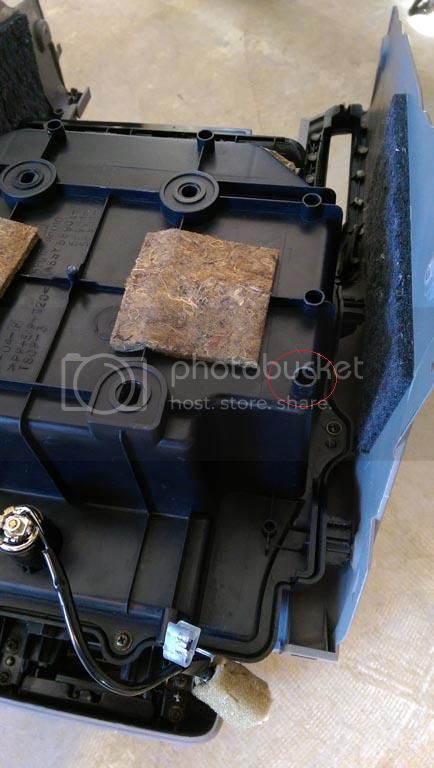

When installing the assembled console, it wouldn't seat all the way. Turns out the two areas circled in red were interfering. I filed down the plastic leg about 1/8" and it seated properly.
Also, the bracket circled in yellow was interfering with the side of the console lining up to the side of the cubby. With a little convincing I was able to get the holes to line up. It would seem this vertical bracket is not on the non-changer trucks.

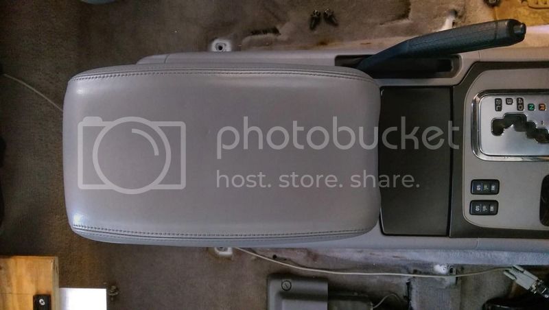

And installed. I was able to use the blank plate to cover the hole where the rear controls were.
