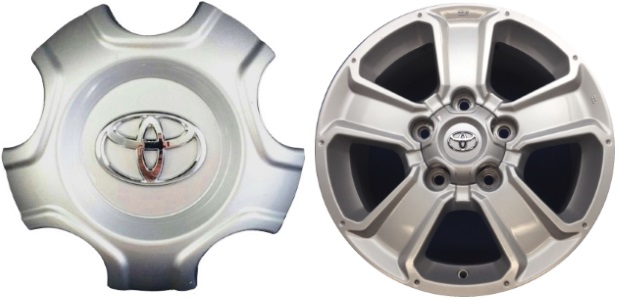

I have a 2000 Hundy. I have these tundra wheels and can't find the 18" Land Cruiser Center Caps that are supposed to fit over front hubs? If you have successfully found one please post pic and part number - greatly appreciate any help. (I currently smashed the dust caps in and reformed the tundra caps but they look pretty crap - don't want to buy a new set to drill - really want a fitted LC center cap if possible.
Caps I've tried that don't fit + 16" Stock caps

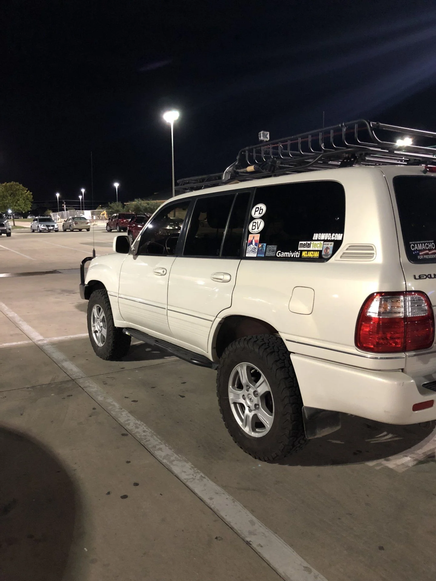

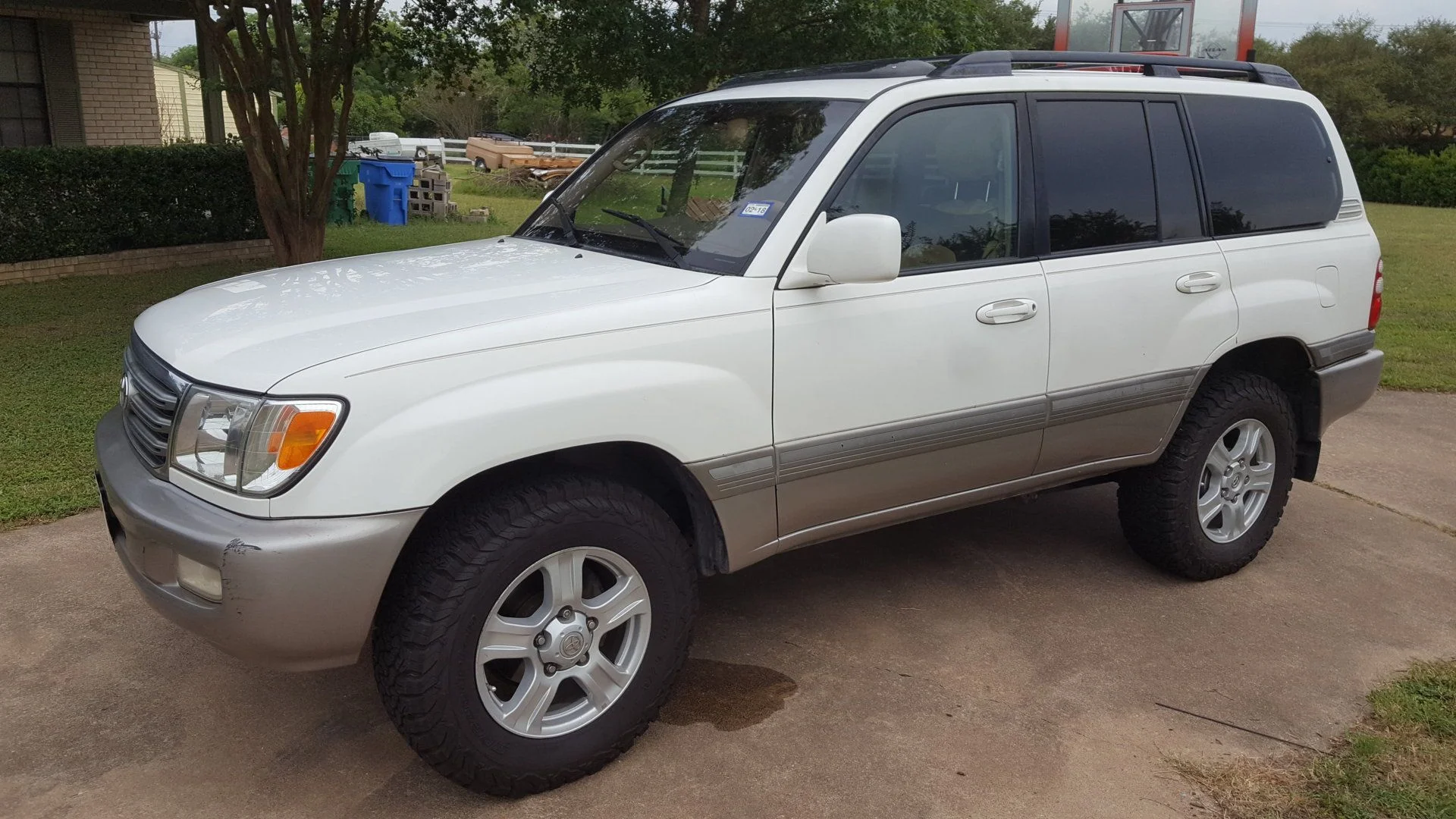

Spacers are 1 of 3 options available to you. The second is to use a hole bit to drill out a small hole for the cap to stick out of as gatormark91 mentioned above. The third would be to use the LX caps which will clear the hubs without spacers. Issue with those is that they are more of a silver/grey rather than just silver like the Toyota caps. I'd go with 1" or 1.25" spacers. I went with 1.25 from BORA
I've got a set of BORA 1.25s at home waiting to go on. Looks great!
(BTW, though, the rims on your truck are not the ones OP posted about. People have fit those with some decent grinding on the center caps, and hammering on the bearing dust caps. The later ones fit too close)

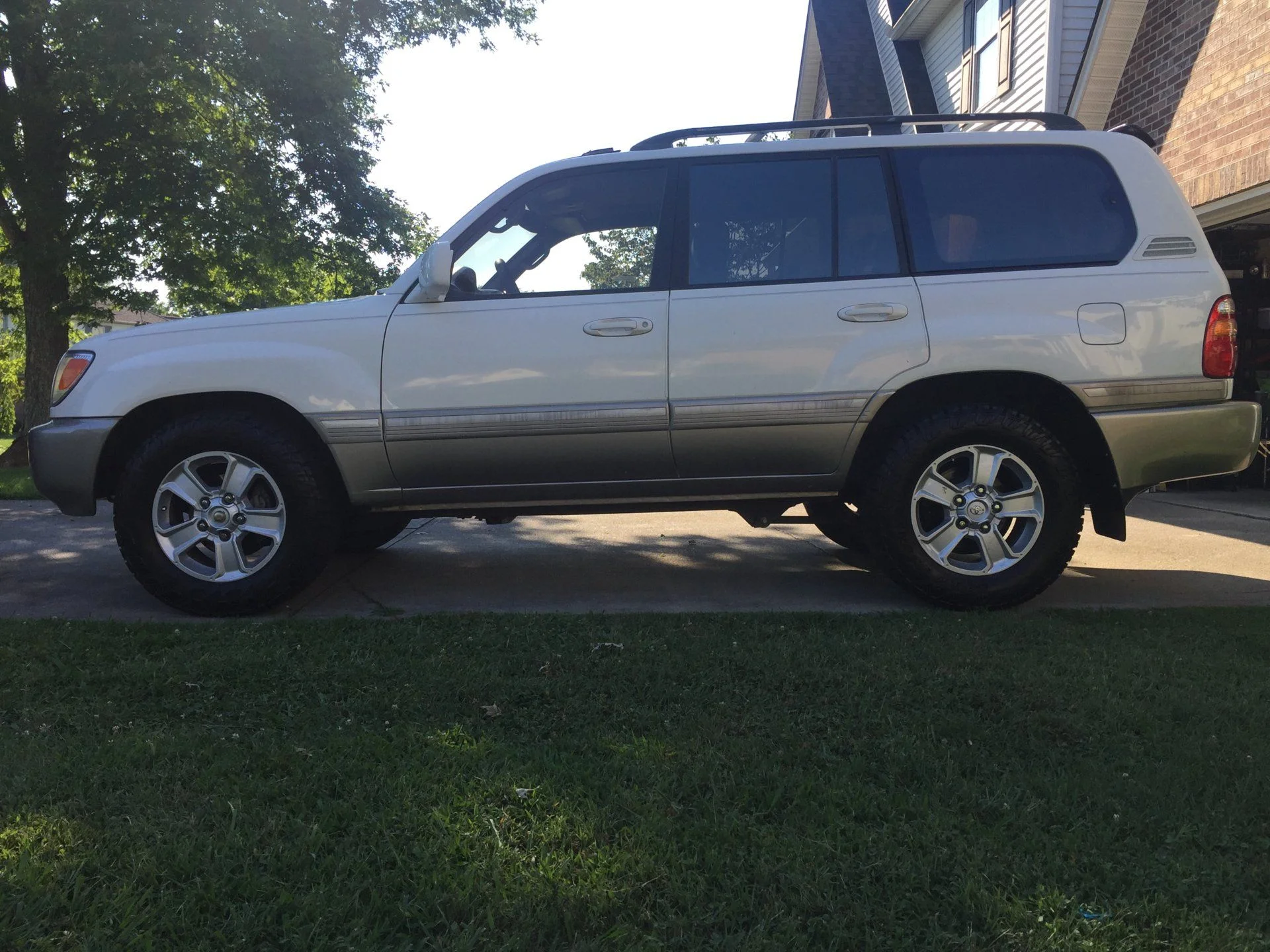

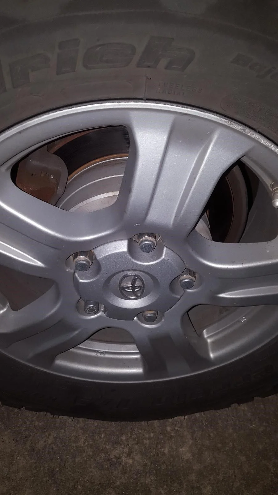

I have the same wheel/tire combo that geanes has. I used the original '04 center caps on the tundra wheel. Slight difference but no need for spacers, plus I do not like how the wheel looks like w/o a cap. First pic is from the front with 04 caps and second pic is the Tundra caps.
I have the same wheel/tire combo that geanes has. I used the original '04 center caps on the tundra wheel. Slight difference but no need for spacers, plus I do not like how the wheel looks like w/o a cap. First pic is from the front with 04 caps and second pic is the Tundra caps. View attachment 1590553 View attachment 1590554
They look great, but not the same wheels OP has. Those are earlier Tundra wheels than his. Mine are off of a '15 Tundra, which is different that the earlier 08+ wheels. The diameter of the indentation in the wheel that retains the caps was reduced a very small amount. Maybe someone else got other earlier caps to fit, but I was unable to do so without bending the plastic tabs that held the retention ring in the caps enough, they were going to break off.
