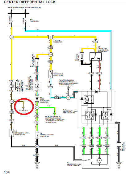

The CDL indicator lamp also ties into the ABS ECU. A failure in that ECU or in the wiring could be providing a ground path which would light the CDL indicator lamp.
