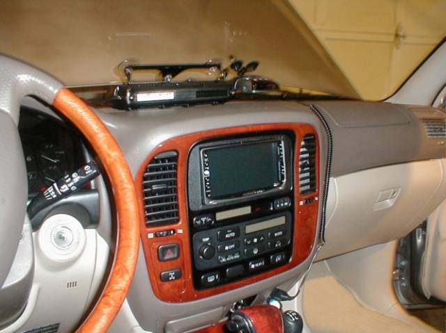

I haven't seen the Nakamichi unit.
But here is the factory radio I pulled out. You can see how much bezel is there. It sits entirely behind the center stack dash trim bezel.
Versus the Pioneer unit that protrudes out through the opening of the center stack dash trim bezel, because it has to in order for the screen to move.

Notice the position of the left and right mounting brackets on your Toyota radio. These "mounting ears" have to be removed and reinstalled onto the Pioneer unit. I think there were 4 small screws per side. Use the new screws supplied by Pioneer. I was only able to get 3 screws per side back into the Pioneer, as the predrilled holes didn't match exactly.
Now see the cavity you have to work with for the install. The AVIC-Z1 has lots of new connectors, cables, auxiliary connectors and labels that all have to fit, while not blocking the small fan in the back. You will also have to run GPS antenna, microphone, Speed Sense, Reverse Signal and Parking Brake sense wires into here, as well as any camera input, iPod/BlueTooth/Satellite modules. That's a lot of extra cable and connectors. Most of it will dangle down below the radio, where it turns out there is plenty of space.
I removed the Instrument Cluster trim panel (which has the dimmer adjust knob on it) by simply pulling rearward toward me. Like a lot of this truck, it's held by simple friction retaining clips. Disconnect the dimmer switch connector and set aside.
I partialling removed the knee trim below the steering wheel too. This was to give me some routing room. This was NOT a necessary step, but it helped when reaching up to pull the GPS cable across. There is a screw at the lower left corner. I am 90% sure from memory that the rest of the fasteners were just spring clips. Pull toward you to remove. Might need a little prying at each spot.
