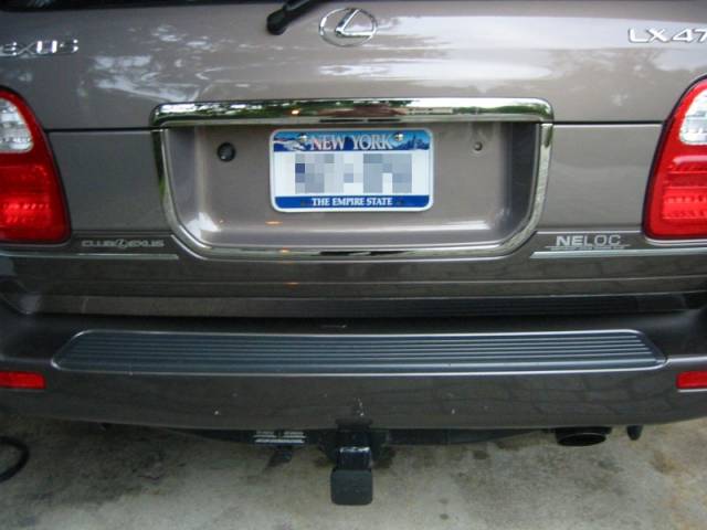

I had the camera mounted on the left side of the licence plate exactly the same distance as the key hole. I didnt want to loose the keyhole as i sometimes use it so i can be stealth. I need to get the bluetooth and Ipod setups now too.

Thats how my tailgate looks.
Wouldn't you be better off with the cam at the top, above the window? Better view / angle, see the corners better?
Opinions?
Q: What angle are the cameras you use? I've seen anything from 90 to 150 degrees view. That will decide the best mounting position.

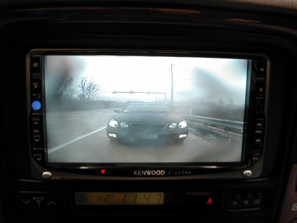

i have the camera more for backing up long distances...i usually like to drive in reverse a lot. I have 5% tint also, so at night i cant see out the back window that well, and i use the camera as a sort of rear view mirror. Also really helps when the cargo area is packed with ish and i cant see out the back window thru the mirror....so i just use the camera.
Yeah it sucks that i cant see the actual bumpers of my truck and the car im parking in front of but, i didnt want to go with one of those little box crap camera hanging off my car.
Now if someone really wanted to ied assume, they could take the standard LX470 rear camera that mounts between the two licence plate lights and wire that up to work. But its a weird fish eye and you cant really see behind you, just whats right in front of the back bumper.
it was raining when i took this picture, but its my friend in a Lexus GS behind me at a light. That shows my field of vew
