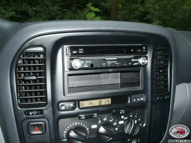

Does the Avic-Z1 look like this X1?
Looking forward to see your install.
I must be the only person in the world who likes the big OEM stereo controls better than the tiny little controls you get on all the aftermarket units.
Do they make aftermarket units with more usable controls ?
