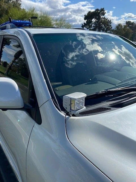

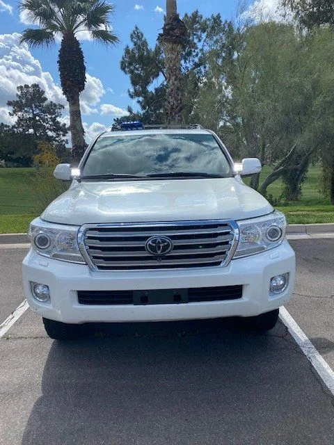

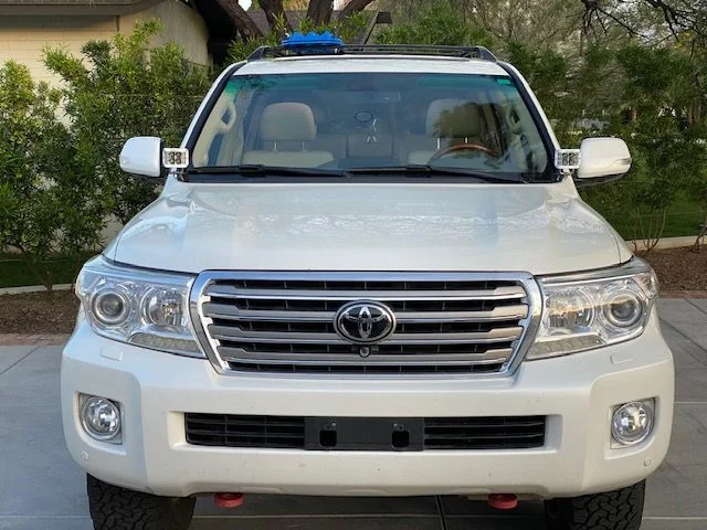

Just wired them this morning. They did take A LOT of trimming. Part of it might have been not doing what I was doing but definitely needs some...
@AZCRSR when you have a chance can you take a side shot on the right (passenger). I want to see if they'll clear my snorkel. TIA.
Here you go @grinchy

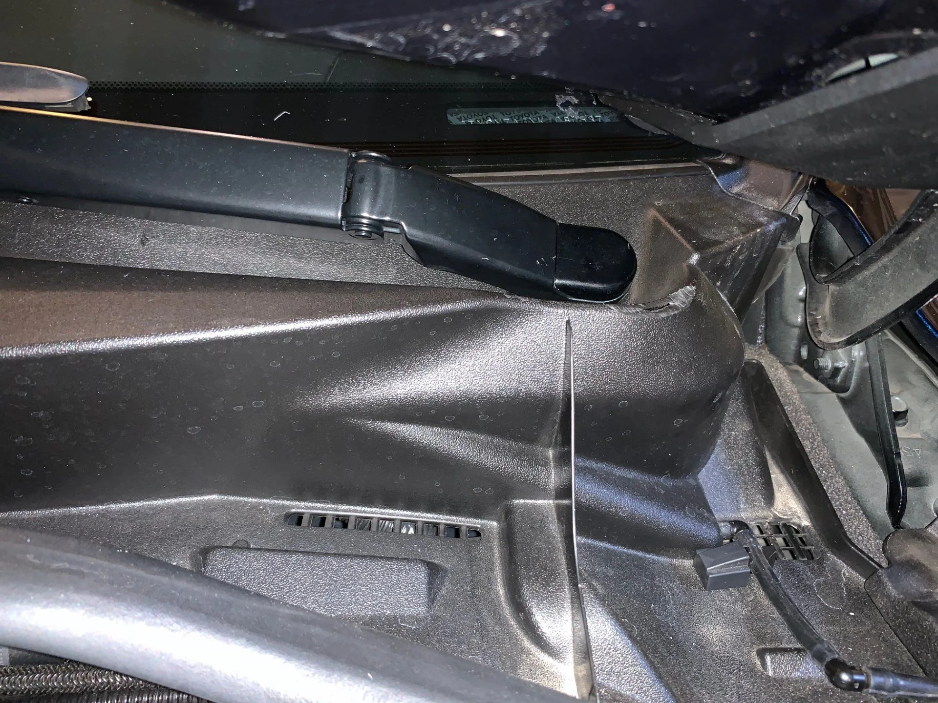

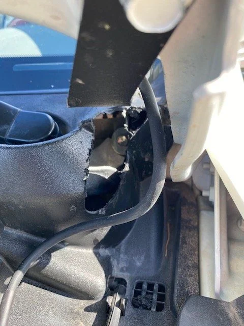

Here are some pics of the trimming. I probably need some more practice with my Dremel. :confused:

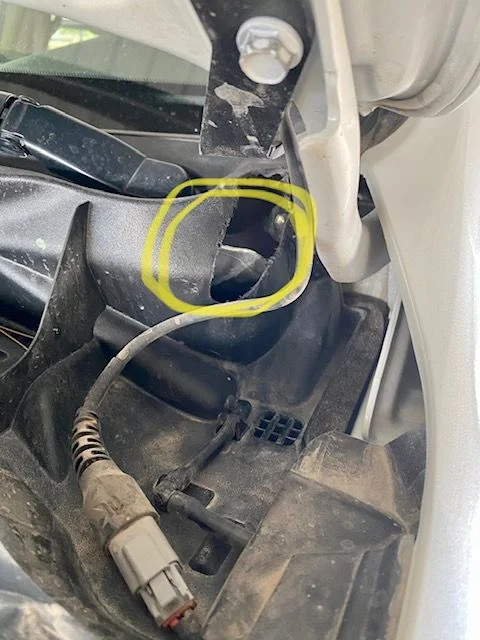

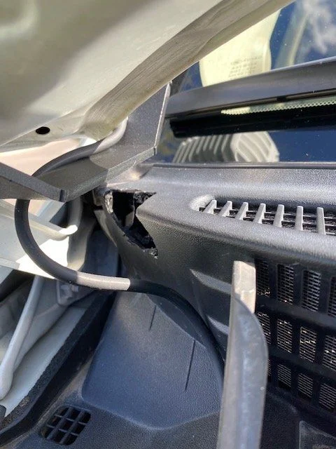

I just installed SDHQ bracket on my LC200 2019. It is not even rubbing it is pushing against the plastic really hard. I trimmed it until I saw the whole (in the picture). It is still pushing hard which cause the hood alignment when in closed position. After contacting SDHQ, they suggested the following.
" We do not have an exact measurement. Another route to get the fitment you can use a heat gun and press the plastic down to mold it. Ideal fitment is when the hood shuts without lifting the rear of the hood so that it just rests on the cowl. " Not sure they ever done actual fitment or installation.
I am not sure if I want to damage the plastic more. Because it fills like I really need to remove 1/4" more of plastic.
What's removing a little more? It's only plastic. ;)

I was just afraid that there is some metal parts under that plastic not suppose to be exposed to water. Whole plastic is channeling water pretty good to the drain holes. I usually don't afraid removing some non-functional peaces. But that looks like have some purpose. My be pushing this plastic with the heat gun could be a better option. But heat gun could melt it too. The plastic itself is pretty hard.
Not that I can see but maybe someone with more knowledge can chime in? I only see one piece of metal on the driver side but it's a pretty stout body piece so I don't see an issue. Nothing under the passenger side.
There is also a secondary drain on both sides under the hood. It looks like all of the drains channel the water through the same area and away from the engine bay.

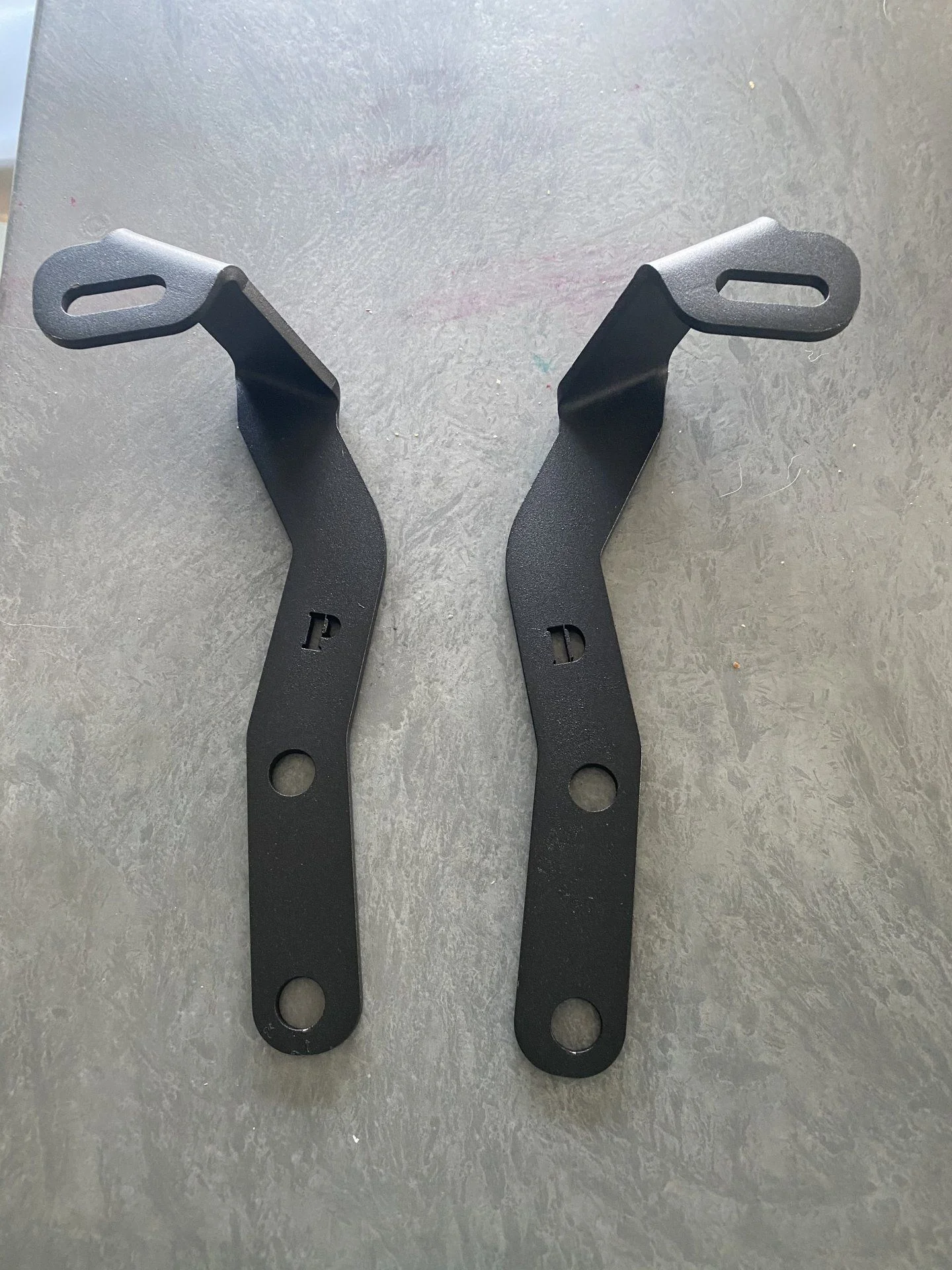

Does someone have a picture of just the brackets or can you confirm these are the same ones you got for fitment up to a 2015?
