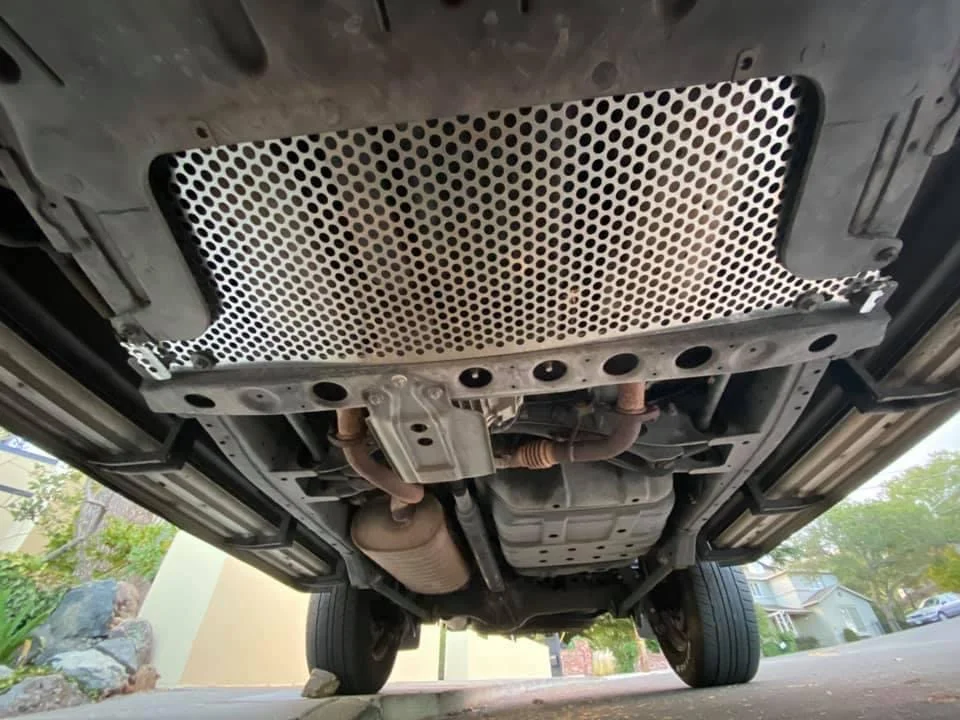

I would prefer this over a skid plate. I like the ability to ventilate. I tried a search on the image name on Google but didn't get a hit. Would be great to find some additional info, or better yet, one to buy!
Good point. It looks so thin, though. Since the plate is open on both ends shouldn't it have plenty of airflow, except perhaps if you're idling too long?

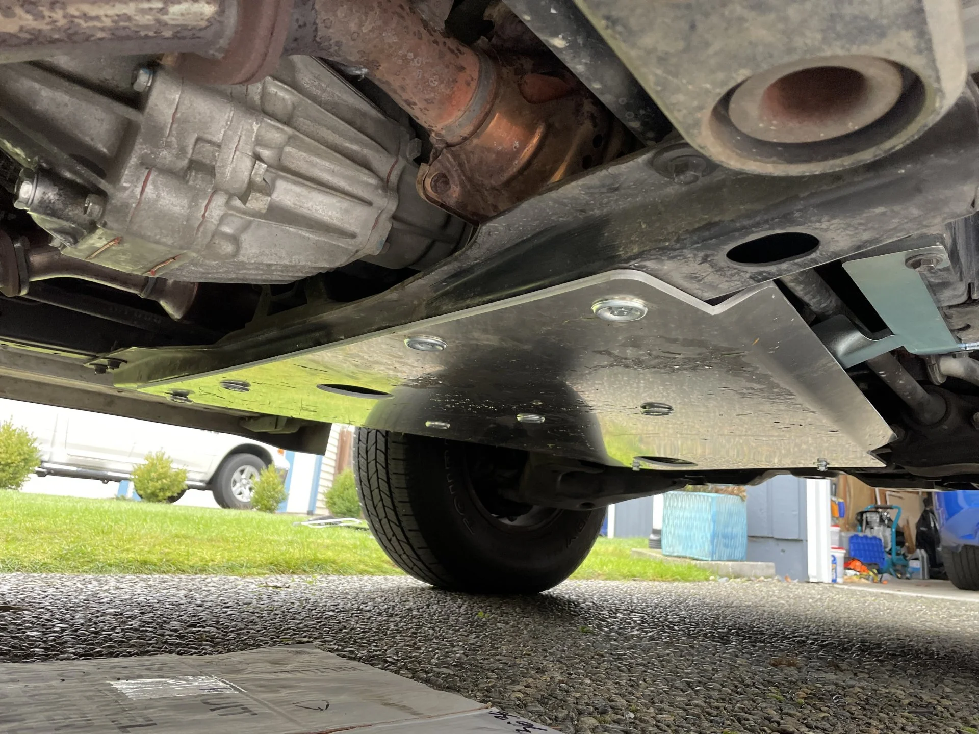

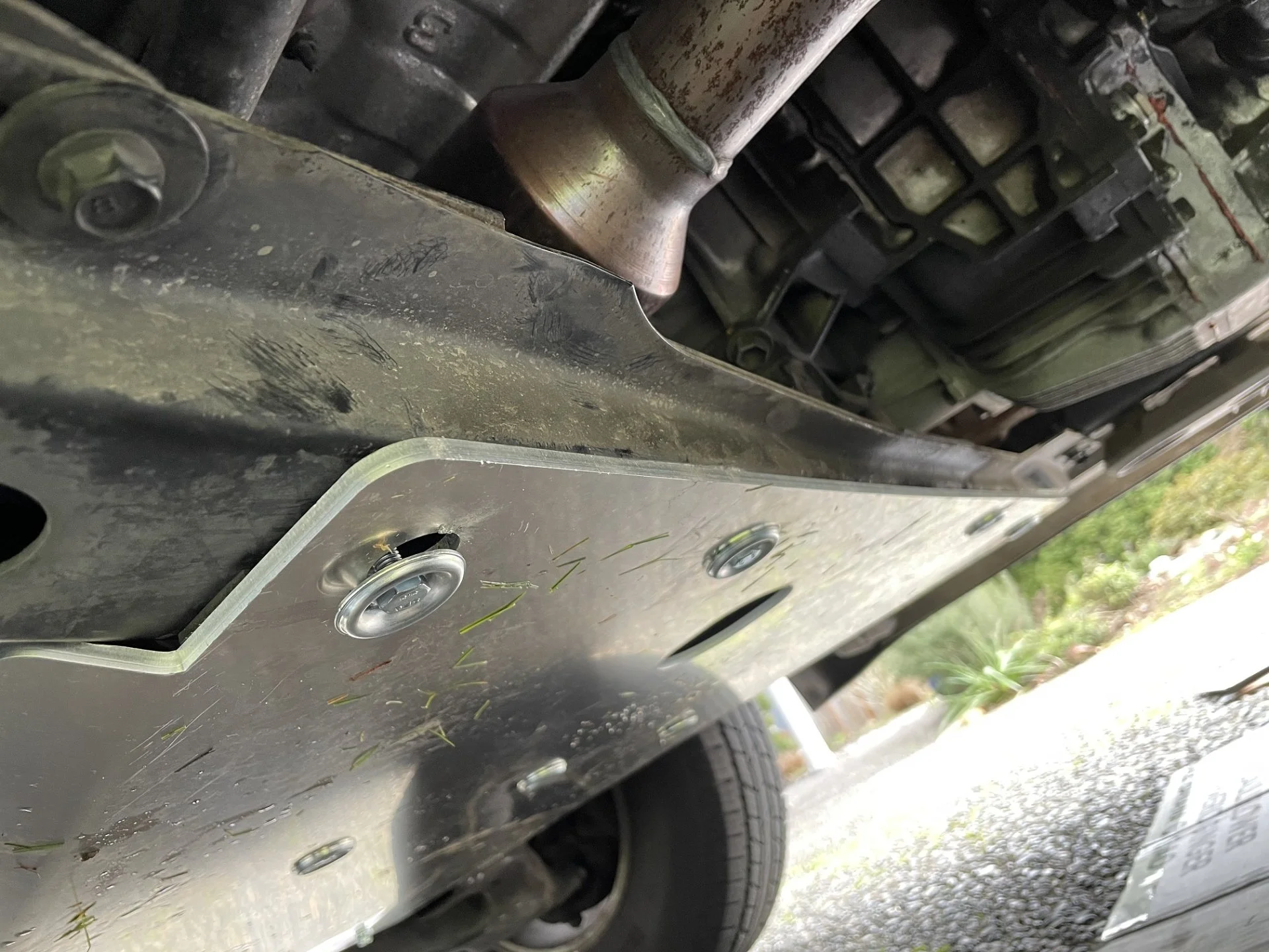

Ok, as promised I'm back with an update after installing my ASFIR transmission skid. Overall, I think it's going to work out fine for CAT protection. There were a few issues as described below. This was my experience with a completely stock 99 LX, there may be slight variations with other installs that used spacers to clear sliders, etc.
Looking from the driver side:
Passenger side looking forward:

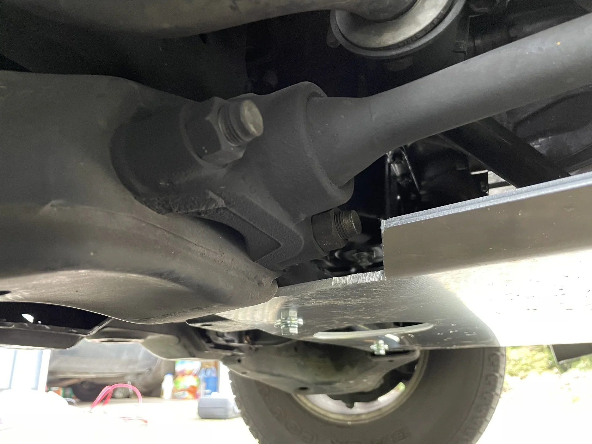

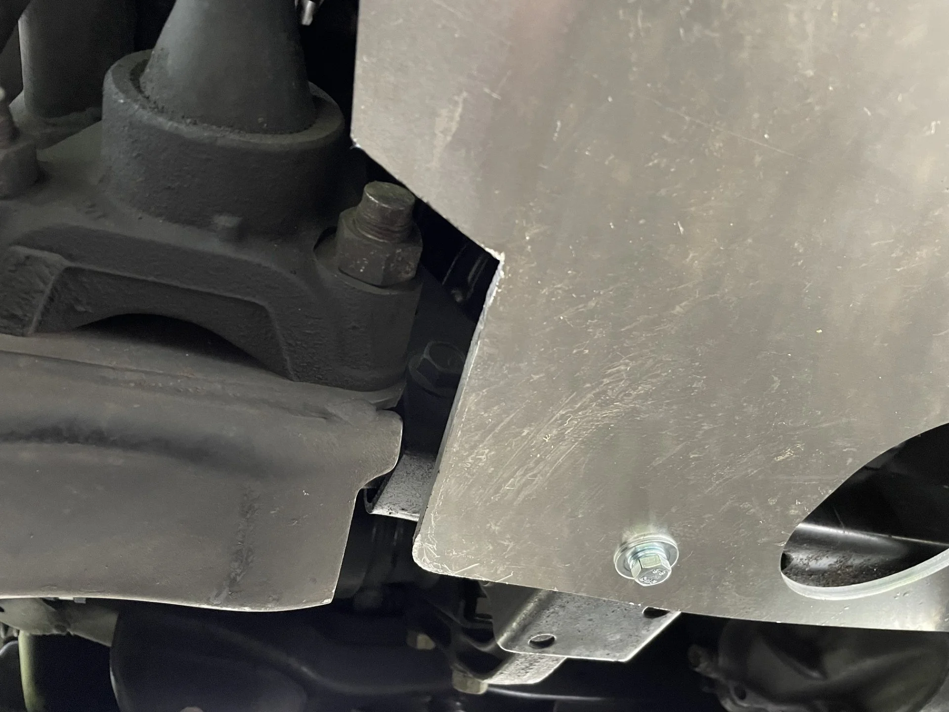

There were two fitment issues I encountered. The first is the front of the "ears" on the skid interfered with the torsion bar bolts on the lower control arms. The plate bolted up just fine, but it wouldn't have been good if I hadn't noticed. Of course I worked back to front so didn't realize it until I had it pretty much all the way on. I then had to take it all back off and grind that back a bit. The pictures below are after grinding, the ears on the skid plate were just touching the torsion bar bolts before:

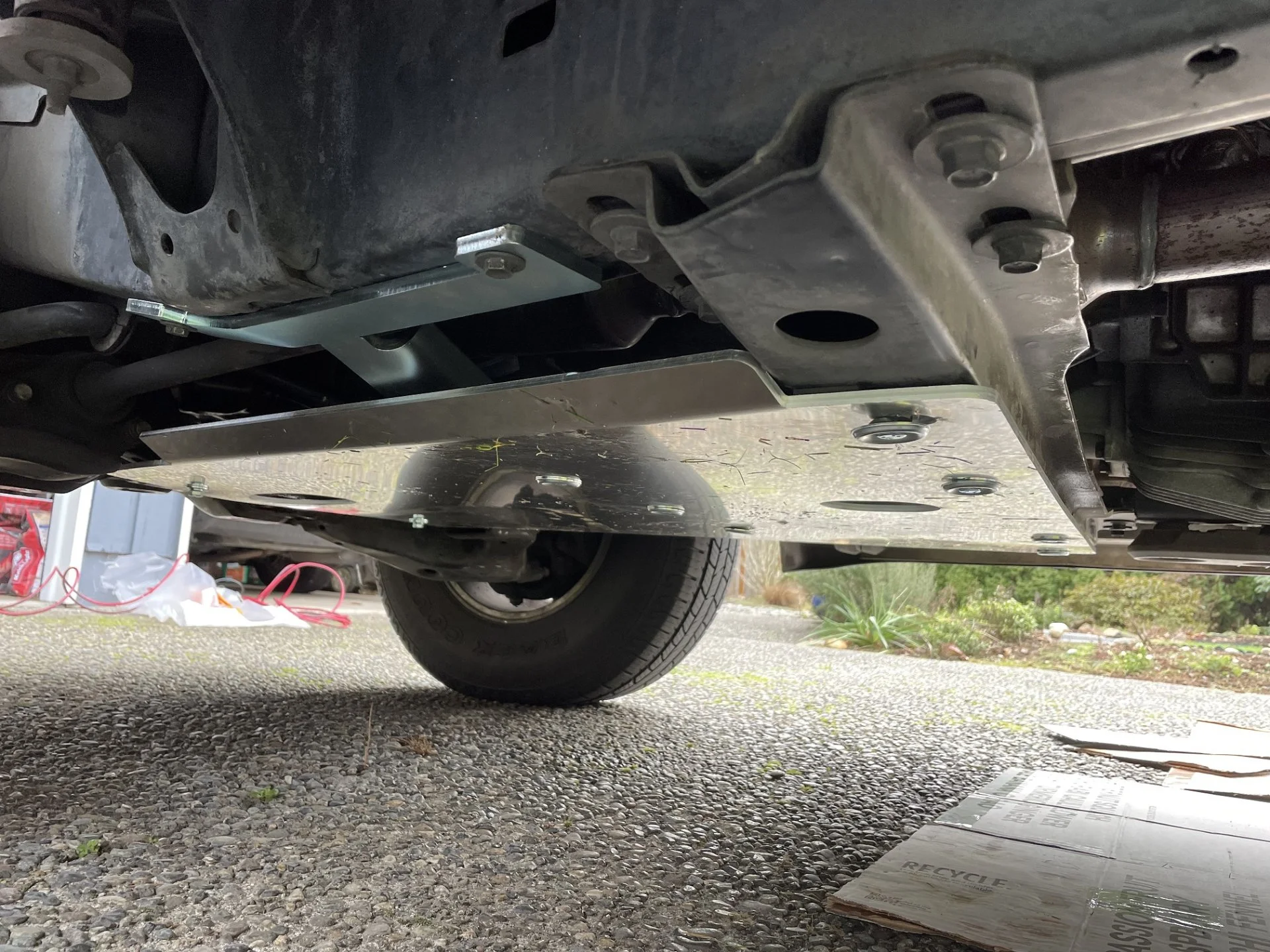

Finally, the driver side rear mounting hole wasn't drilled quite in the right place. I tried every version of installing all the bolts loosely, I even tried installing this bolt first and working away from it. Next time I'm at the hardware store, I'll pick up a metal grinding bit for my dremel and slot it out a bit more so it fits better. This was the only mounting hole issue, everything else lined up just fine.
So, overall I think this is a pretty good off the shelf option for cat protection. The install was fairly easy, the issues I had were easily overcome, and hopefully this will make the thieves move on to an easier target if they try my truck again.
