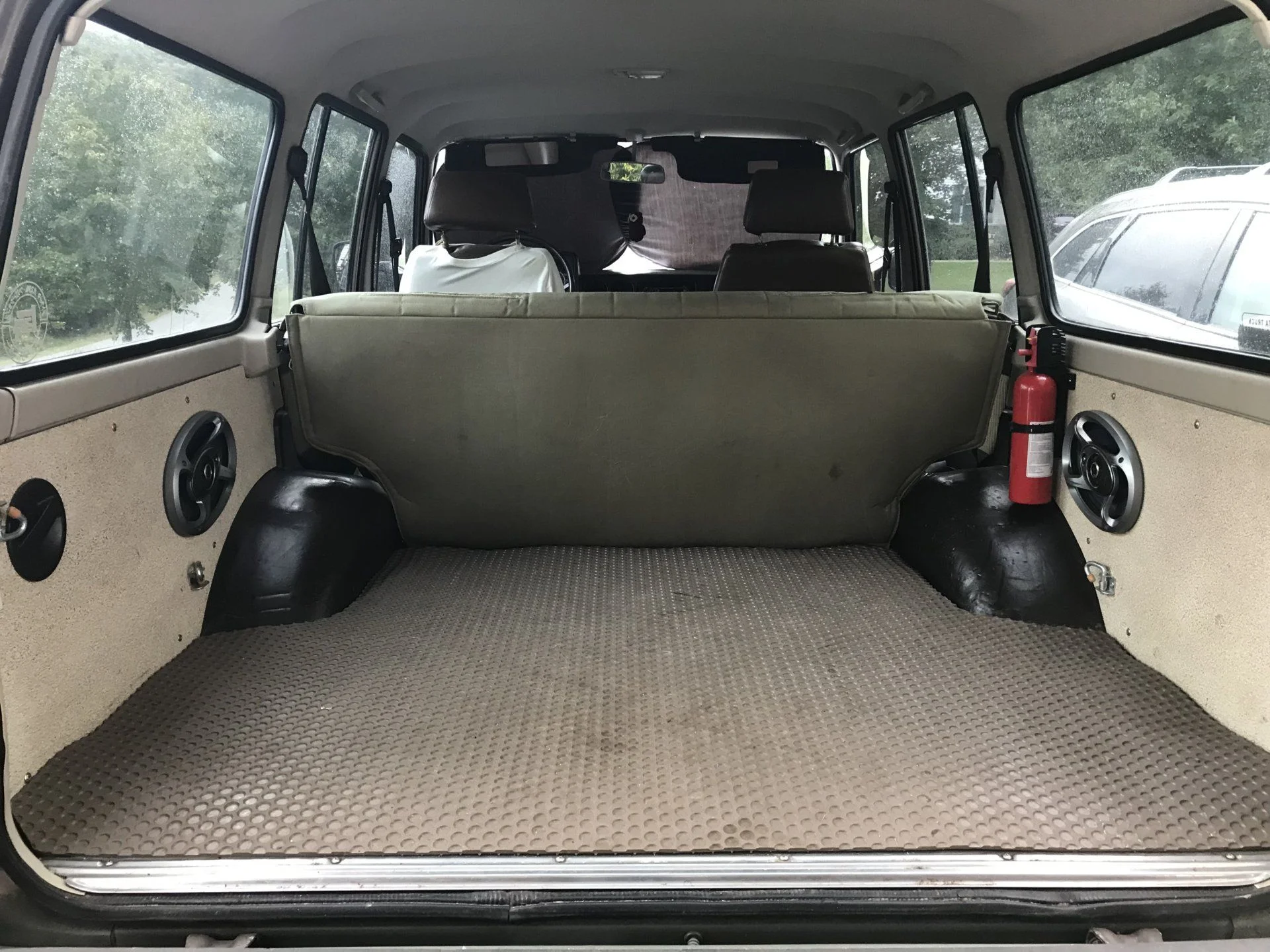

Been wanting to update the carpet for a while in the ole girl. Not sure why, just felt like I needed to. Didn't want to drop mega coin on the $OR kit, so I recently grabbed a set from Dave @dnp. Super nice guy to deal with, shipping was fast and the kit looked pretty nice, especially considering all that it came with. Maybe it's a little thinner than stock, but not too shabby, again considering it's probably a third the cost of all the stuff from Spector. What I thought would be a "zip-in, zip-out" like going to Wisconsin kind of project, turned out to be a bigger one, like they do.
Before:

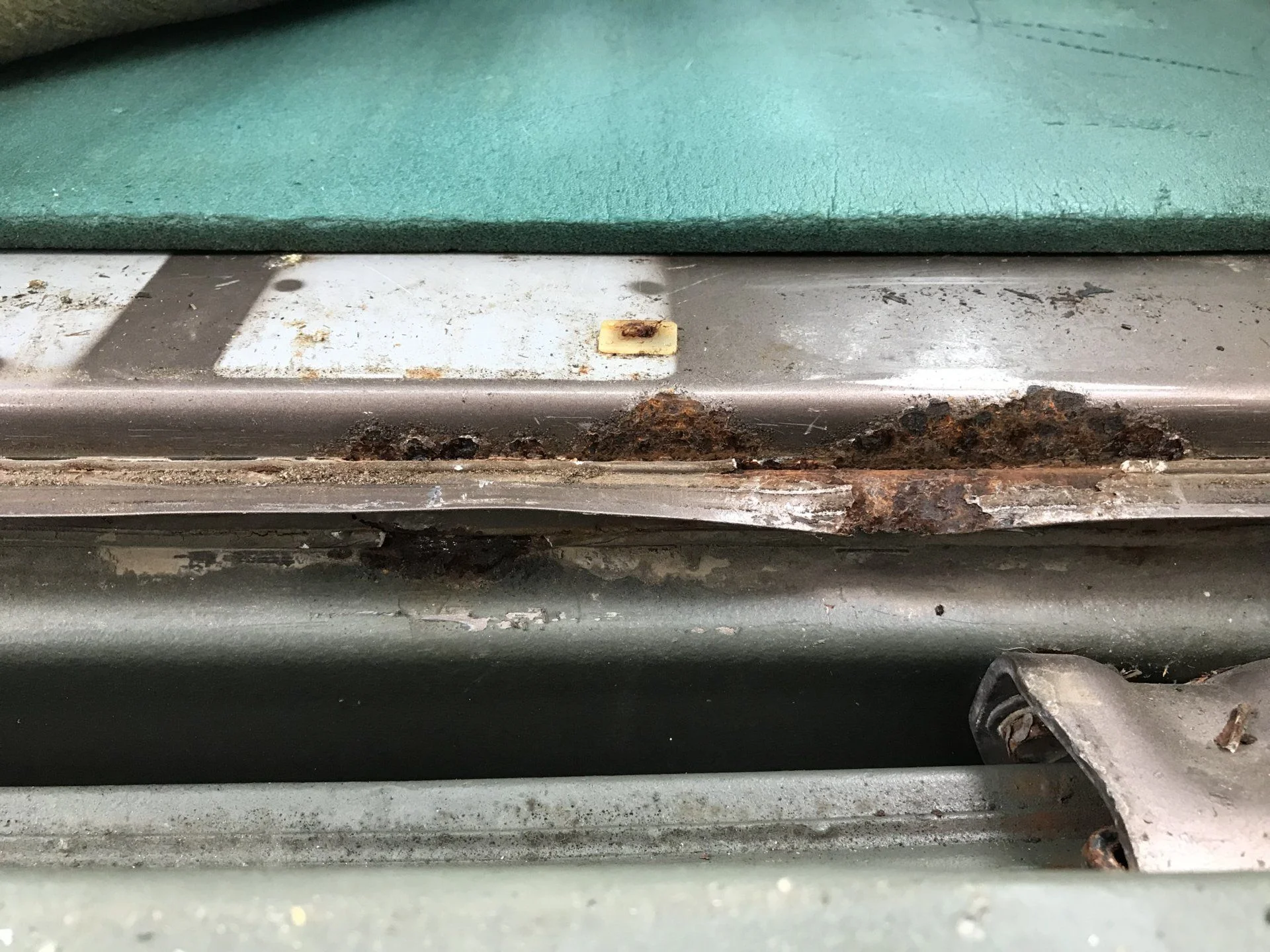

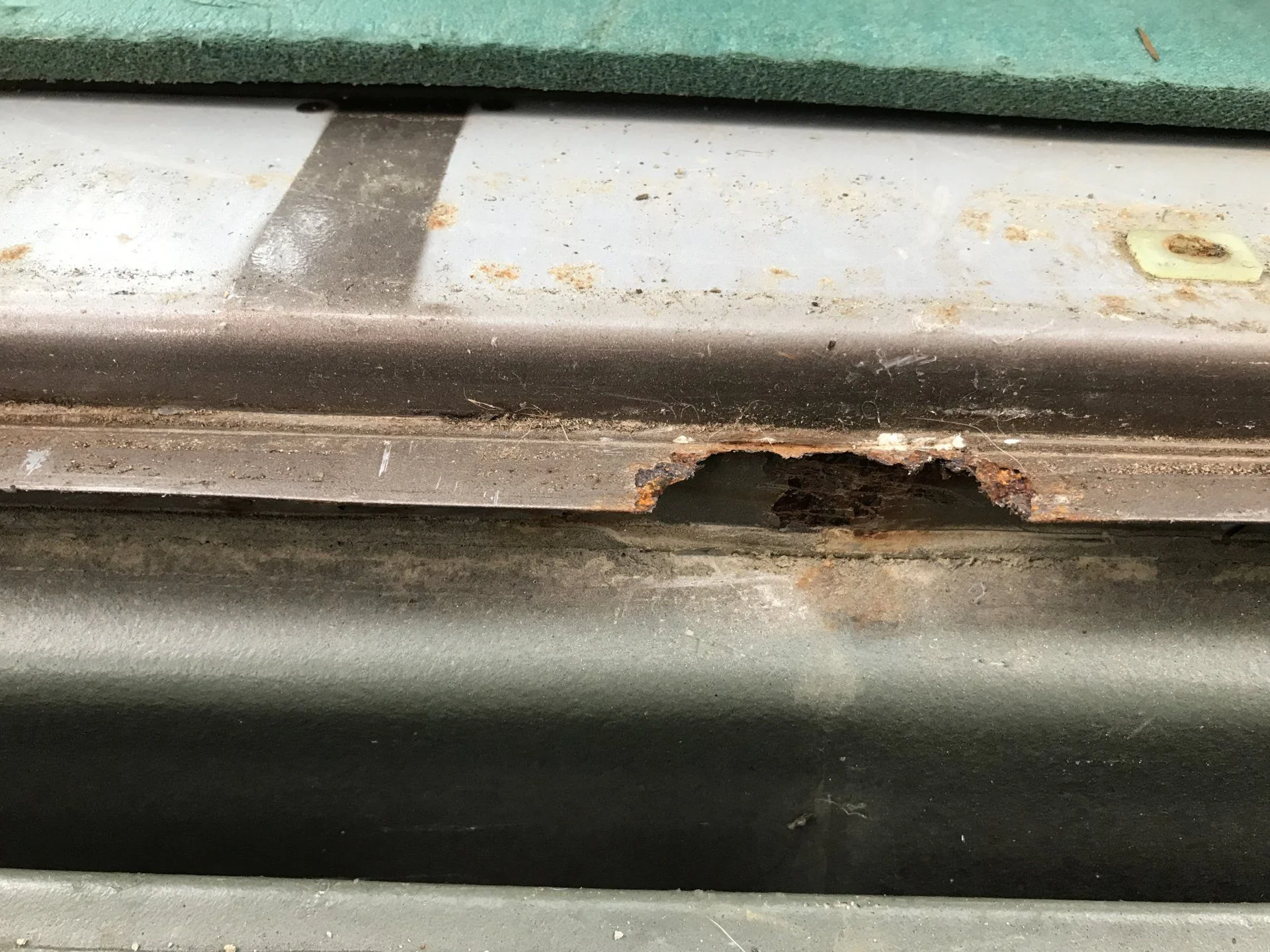

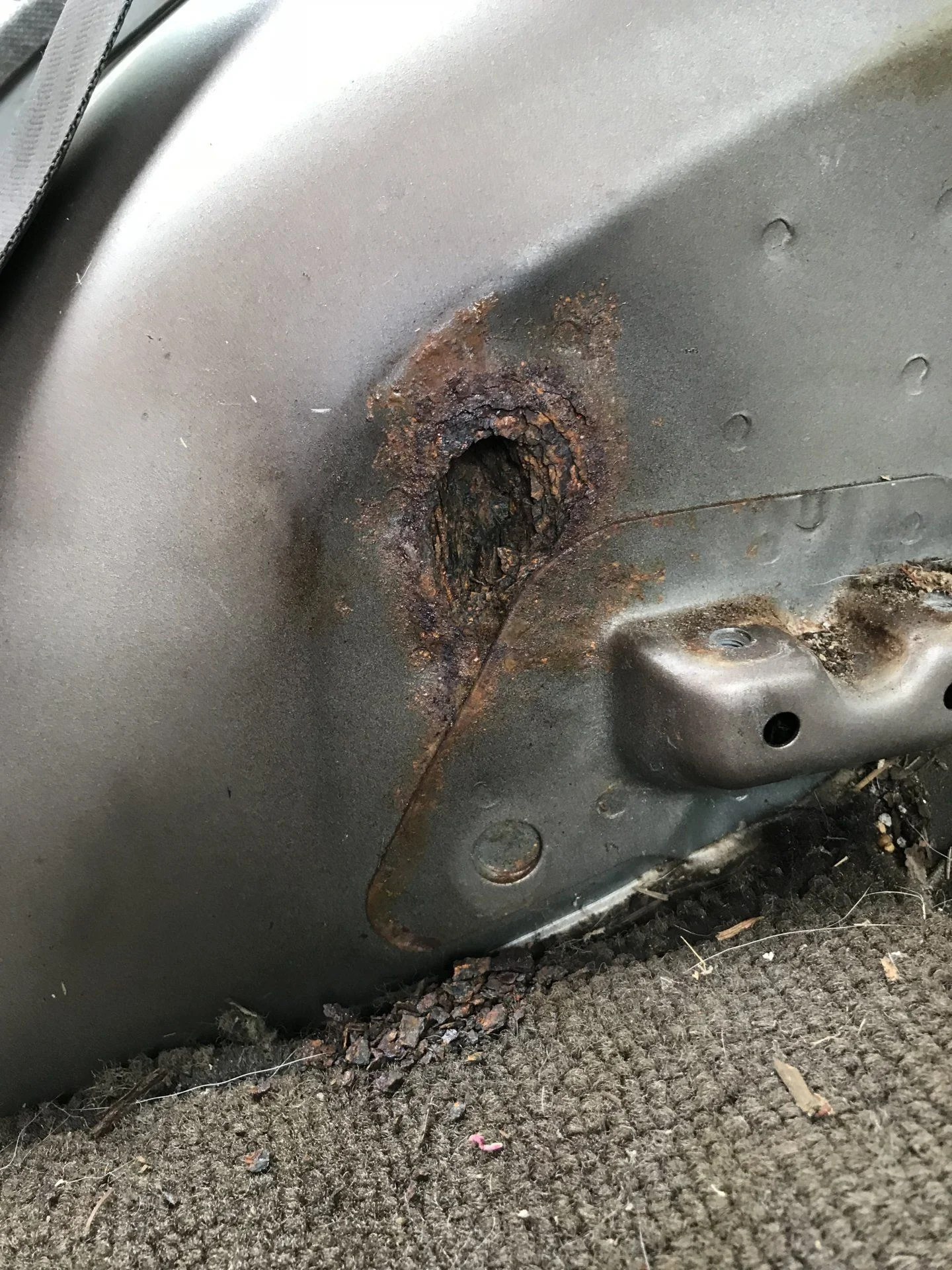

I have ProCar Elite seats up front (that I re-stained with Rub-n-Restore brown-ish color) and the original fabric on the rear seats with SOR's duck covers (tan, although they look green in the pic). Anyhoo, started ripping things out. The cargo carpet had been replaced by PO some years ago and come to find he had installed some thin foam pad underneath. No biggee. When I removed the full-surround weather stripping (part # 64904) from the rear cargo area, I found my first little rust buddies. On the lip that the gasket goes around underneath the chrome kick plate. So some scrubbing, rust conversion, epoxy and paint cleaned that up - hopefully buying me a few years of life on it. The gasket failed to hold up after 32 years...go figure. I also ordered a replacement gasket from Cruiser Parts.net - hoping it's in better shape than mine.

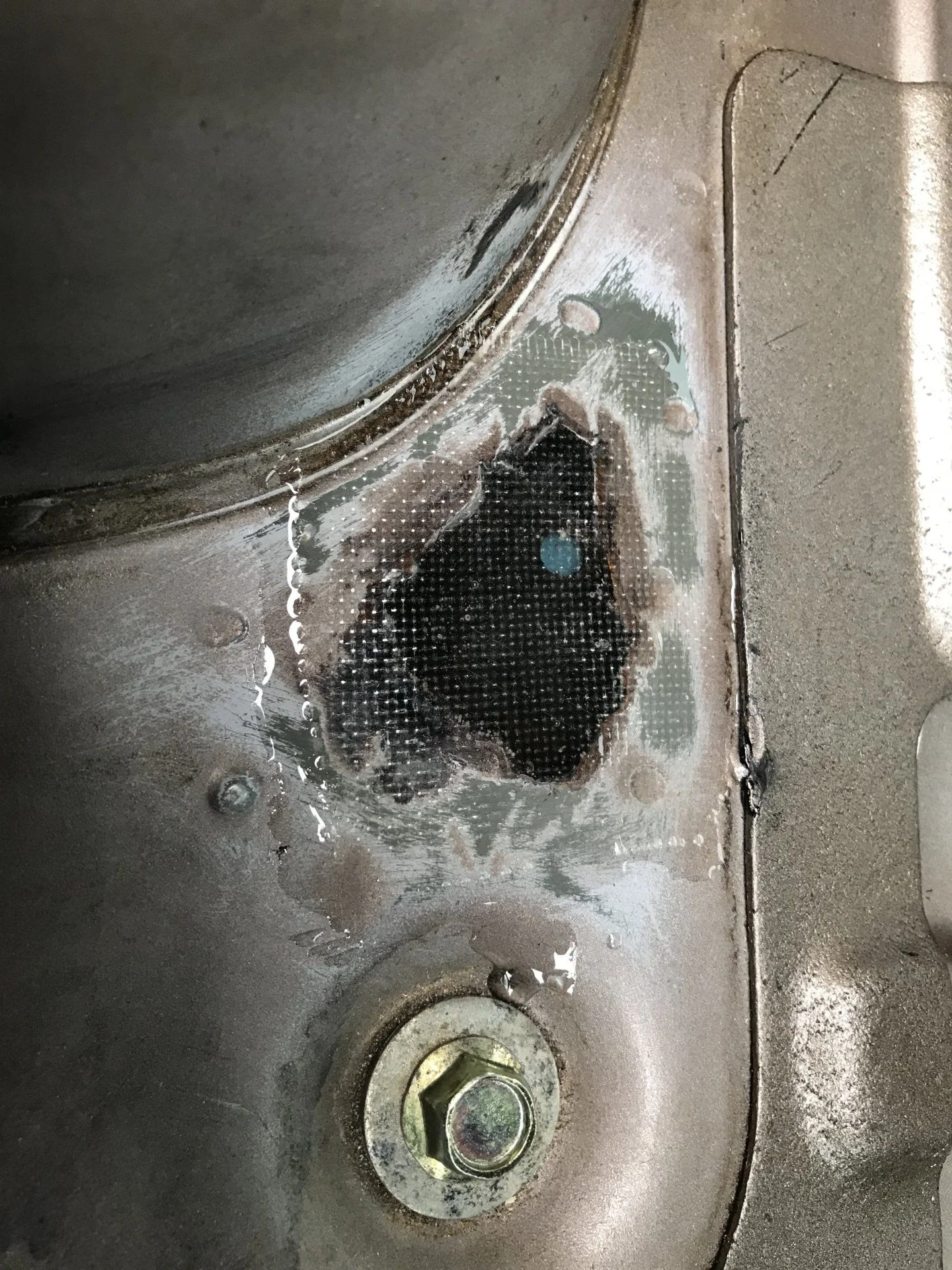

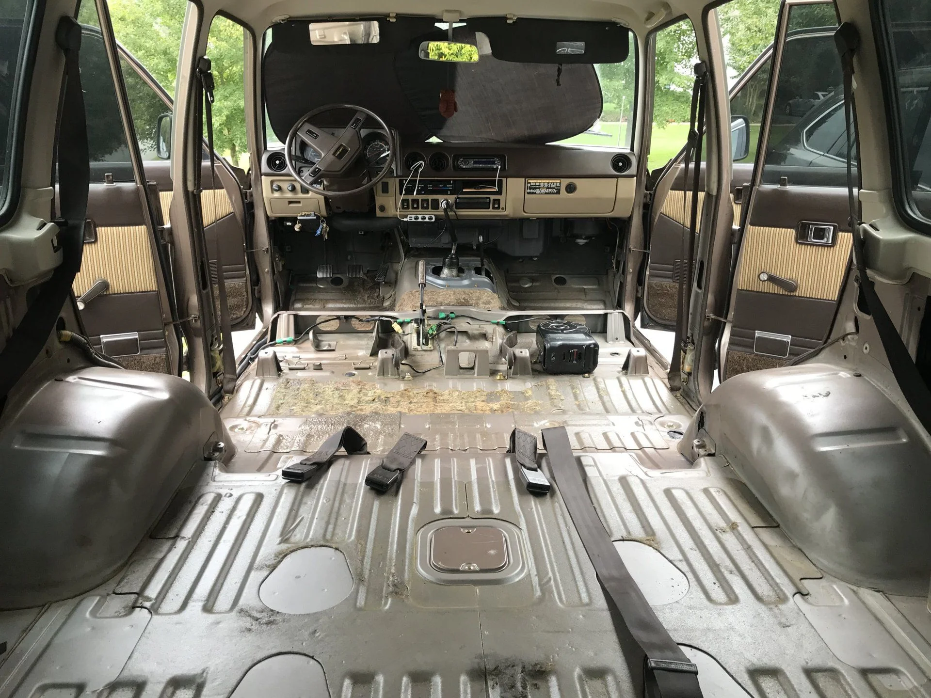

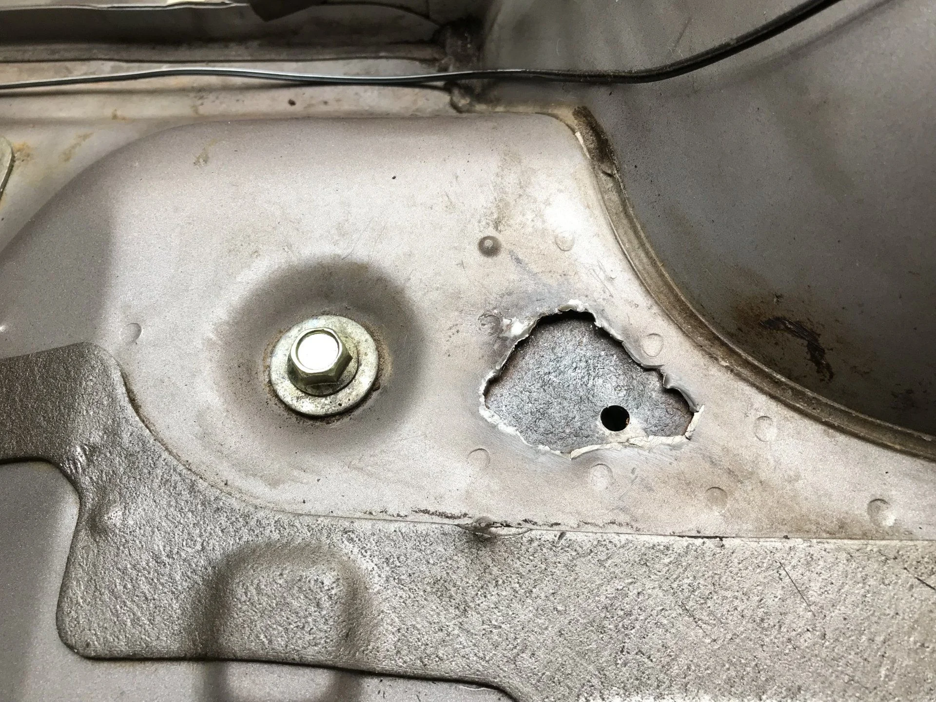

Then I finished removing all of the original carpet and associated hardware, kick-plates, trim, etc. And found two more cancerous spots on the passenger side, rear seat area. One hole was in the wheel well, and the other on the floor. Soooo, cleaned it, converted, filled with epoxy and fiberglass cloth and painted; again hoping to buy more time. I reckon the "proper" thing to do is weld in new metal, but who has time for that?

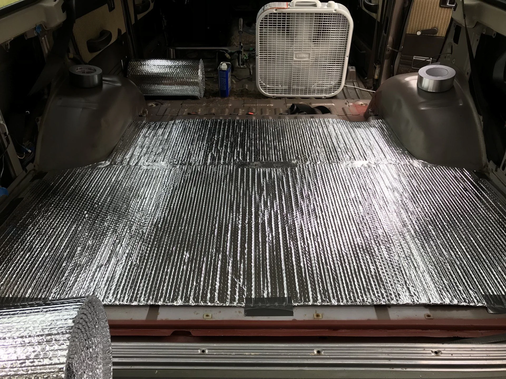

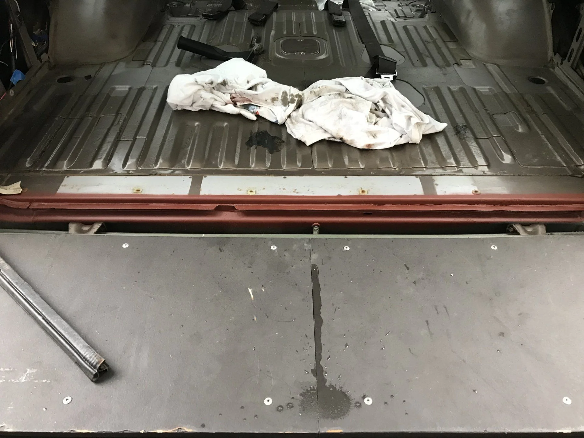

After all that, I debated about installing some sort of sound barrier but wasn't too keen on the sticky stuff that everyone uses. So I figured I'd use some foil lined bubble wrap the the Home Depot has. Saw it on another thread here and figured it was cheap and non-permanent, so not much to lose if it doesn't work....Got al that laid down (including the driver and passenger foot area and tranny hump (not pictured)....

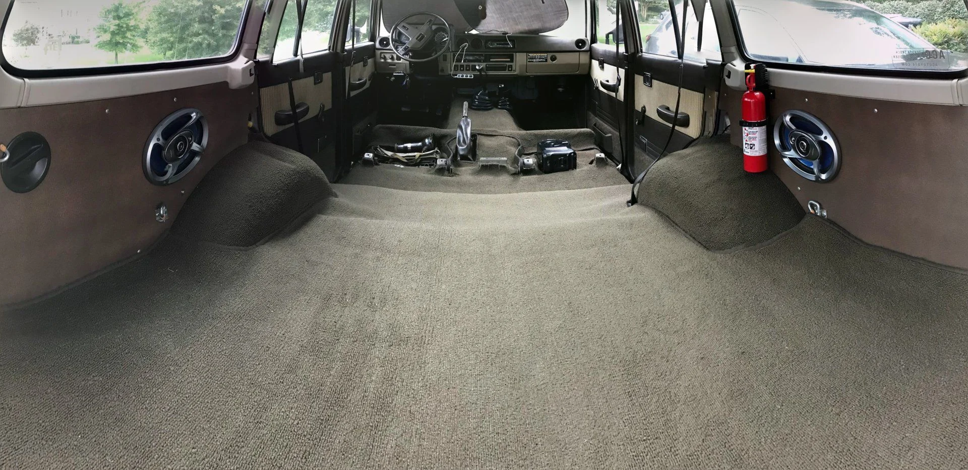

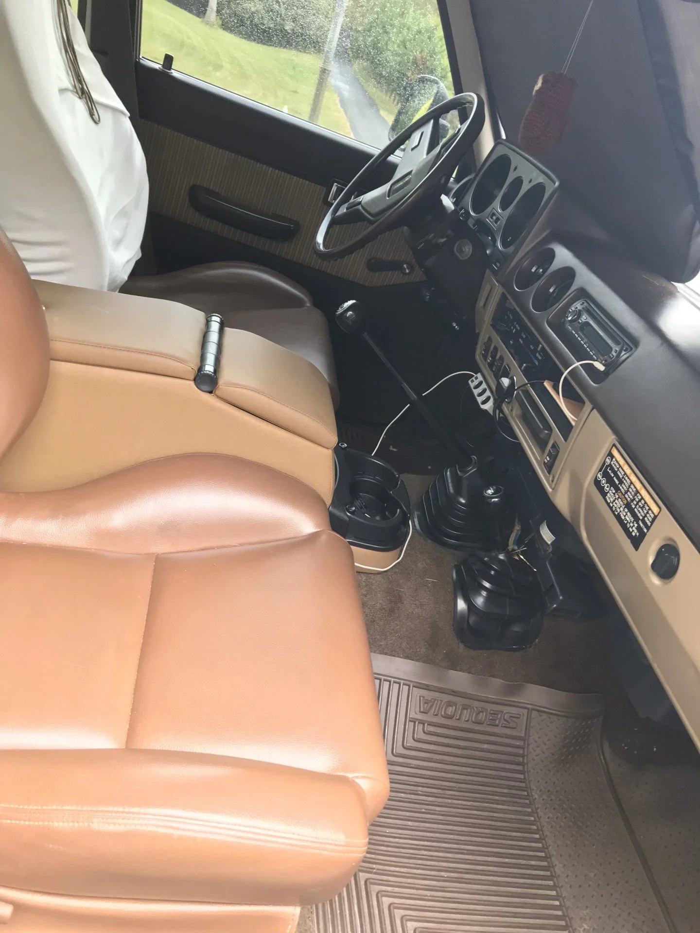

Finally got to the carpet part...Overall it wasn't too tricky. Hardest part was getting the stupid tranny and transfer case boots back in place (had one stubborn bolt that needed to be cut out).
The kit was cut really well. The rear section fit nicely. The middle section also fit well, however what was strange is that the left side didn't need any trimming to fit the door jam, while the right side has lots of slop to cut away...not a big deal, just seemed odd.
Had to cut all the holes for the rear heater, seat locations, tool kit, etc. Not too tricky.
Front section also needed a good bit trimmed off, but didn't take long. Only bummer is that the included wheel arch covers don't cover everything that the stock wheel arch covers did, so I will need to make an extra piece to add on to my rear quarter panel covers...(pic to follow soon).

Threw the front seats back in and took it for a test drive....LOUD. So I see why most people take the time to put in some extra sound proofing. I wasn't expecting anything more quiet, but certainly thought it wouldn't be louder....a bit bummed to be honest. So, project number 465, remove new carpet and install some sound proofing. I guess the replacement carpet isn't as thick as stock - or the carpet pad isn't as good? Maybe it's the foil wrapped bubble insulation that amplifies the car noise? It's especially louder near the transmission hump....ugh.

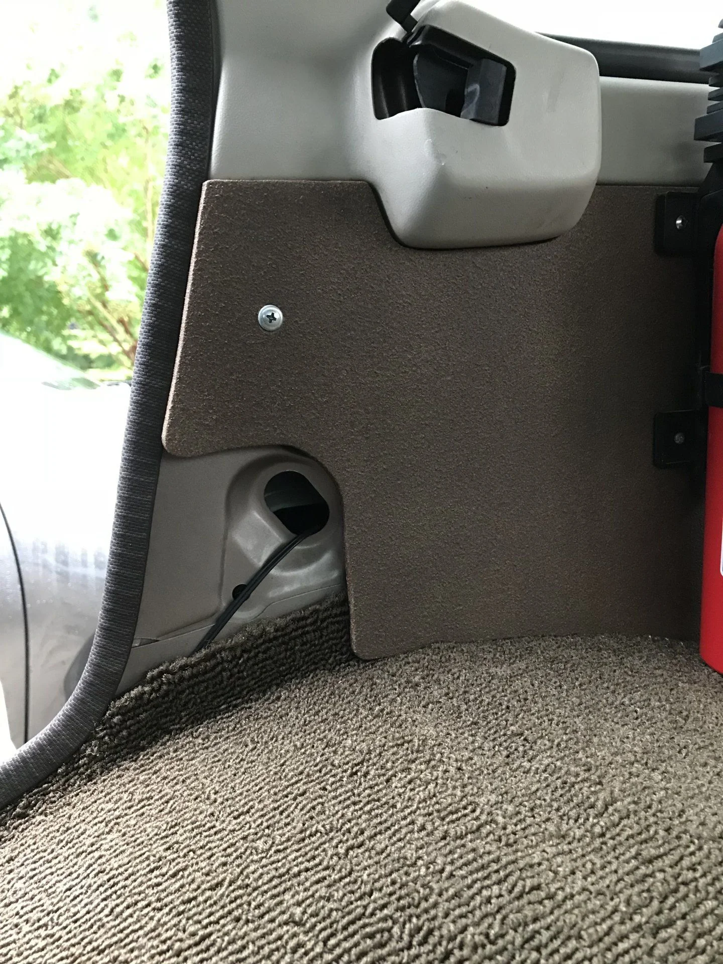

What did you use to construct the panels in your cargo area?

Hi Mac - I used 1/4" MDF and then painted it in epoxy resin because that stuff soaks up moisture like a sponge...then painted with Brown Textured Rustoleum Paint.
In my experience, the Reflectix (foil wrapped bubble insulation) is better for heat than noise. Noise control would better be accomplished with some Dynamat-type product. It's always nice to keep heat out of the truck, of course, so your efforts are not all in vain.
