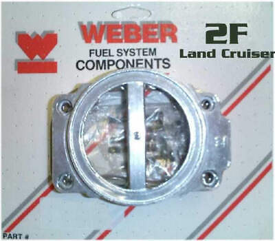

Does anyone have a picture or know how the air filter housing is connected to a 1985 FJ60 carburetor?
If you have the original parts, air cleaner housing & carburetor, it's super obvious. Like moron obvious. If the cruiser has a non original carb or air cleaner then anything is up for grabs.
It appears to be a Weber carburetor, and the air filter housing doesn't line up with it. Previous owner had it taped to seal it, but wasn't sure if the originals had some sort of boot or something to seal it.
2022334
2022335
Not gonna work properly with that carb. Others with a Weber can better inform you, but I think the weber's take something like this.
(Although you'd be better off finding a stock Aisan carb and having it rebuilt if you want to use the stock air cleaner).
2022336
It looks like there is a top that allows for the use of stock air cleaner with a weber, but it's different than what you have
2022337
Thanks for sharing. This is the top they have on it, but for some reason it doesn't align. Not sure if they didn't install it correctly or just have it aligned incorrectly. Will take some work to get it aligned.
You need that cross-section in the Air Horn for the threaded rod that fits thru the stock air cleaner, to hold it down. If you try to booty fab something you're most likely going to allow unfiltered air.
Might be worth your while to do it right and since you've got the original 2F
You should probably go back to the factory carb.
This would be the best way to go if all the OE linkage is there. Stock carb is superior to the weber, IMHO. Also, if you can run without smog equipment, you can buy a brand spanky new Japanese clone of the non-USA FJ60 carb (when they're back in stock, as they sell fast).
