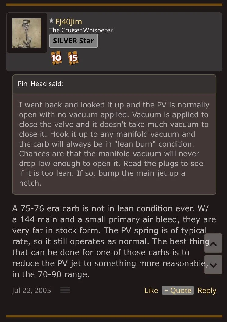

Here’s one of the many threads FJ40Jim has generously left info on.

I’d use search terms like: 75 carb, 75 cfm, single ring, 75-76, PV jet

I hate to show my ignorance, never rebuilt a carb, but what is a PV jet? Is he saying to replace the stock 144 primary main jet with something like a 70-90?

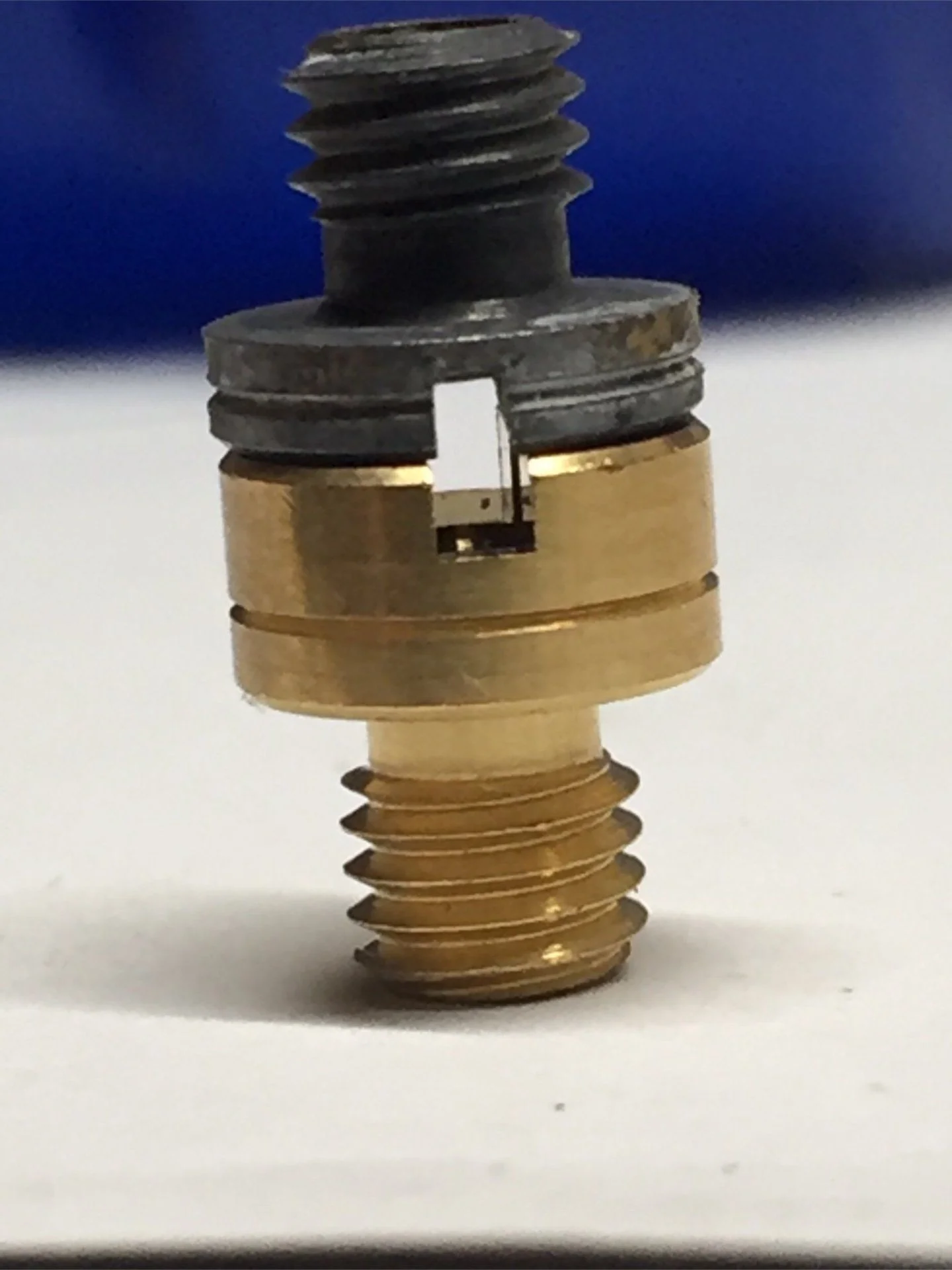

This is a power valve from a 74 carb. The tea party invite is from my daughter(6):cheers:
Here’s my understanding of the PV. At high vacuum the brass slug/weight is sucked up and off the PV plunger, holding fuel back from flowing out the PV jet. When you romp the throttle, vacuum suddenly drops and the light spring(and gravity:meh:) allow the slug/weight to open up the plunger.
I’ve used superfine wetsanding paper to smooth the bore the weight slides in. I also polish the weight. Just guessing, if the weight sticks in the bore, that’s not ideal.

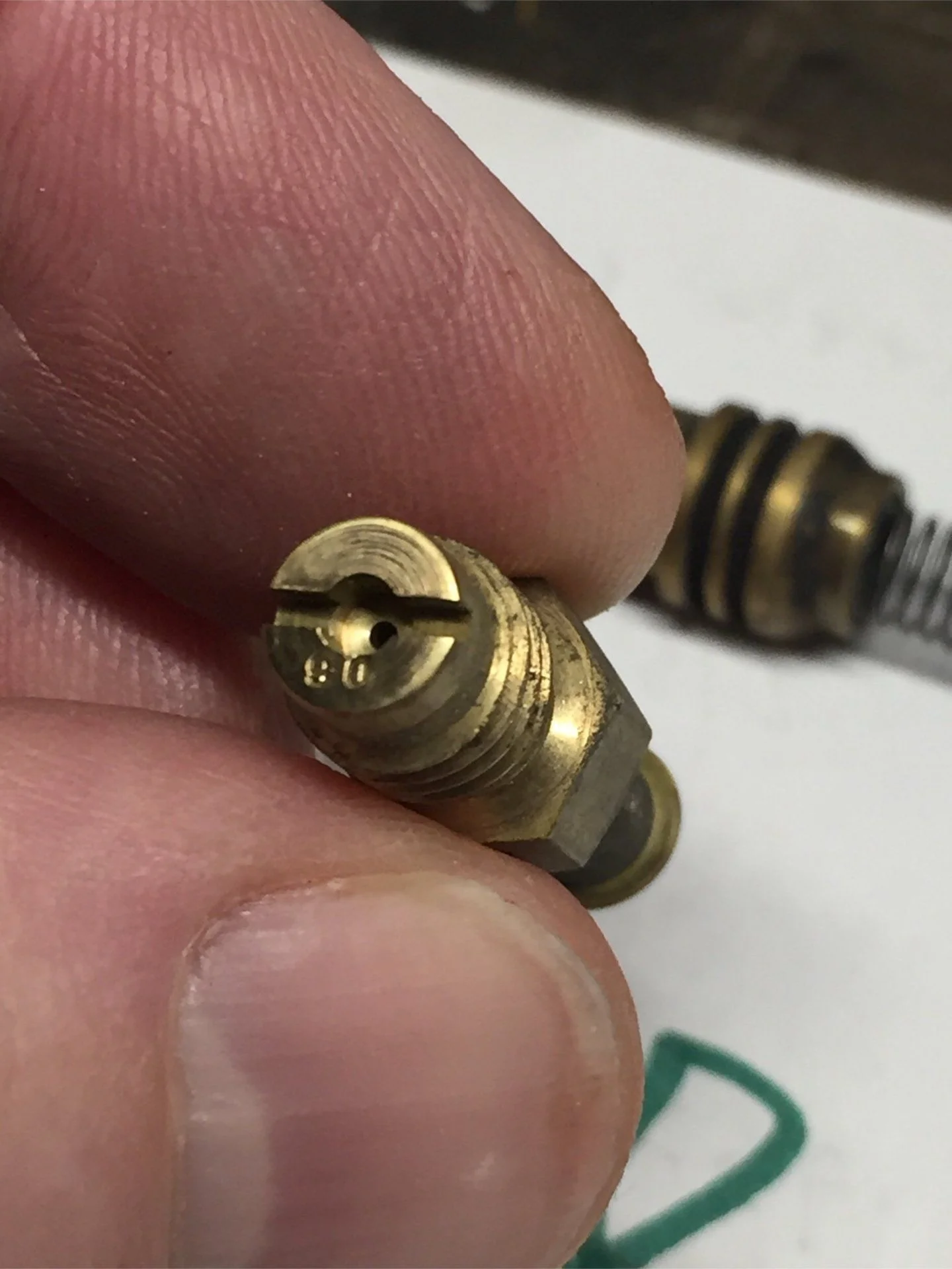

Do you just need 70 thru 90 power jets?
no just the crumbled 230 primary main. probably have to order the 1.59 off specter and drill it.
my other jets are intact and my pv is a 70. there is a bit of screwdriver bend on one of the jets. will that affect flow? replace or use it?

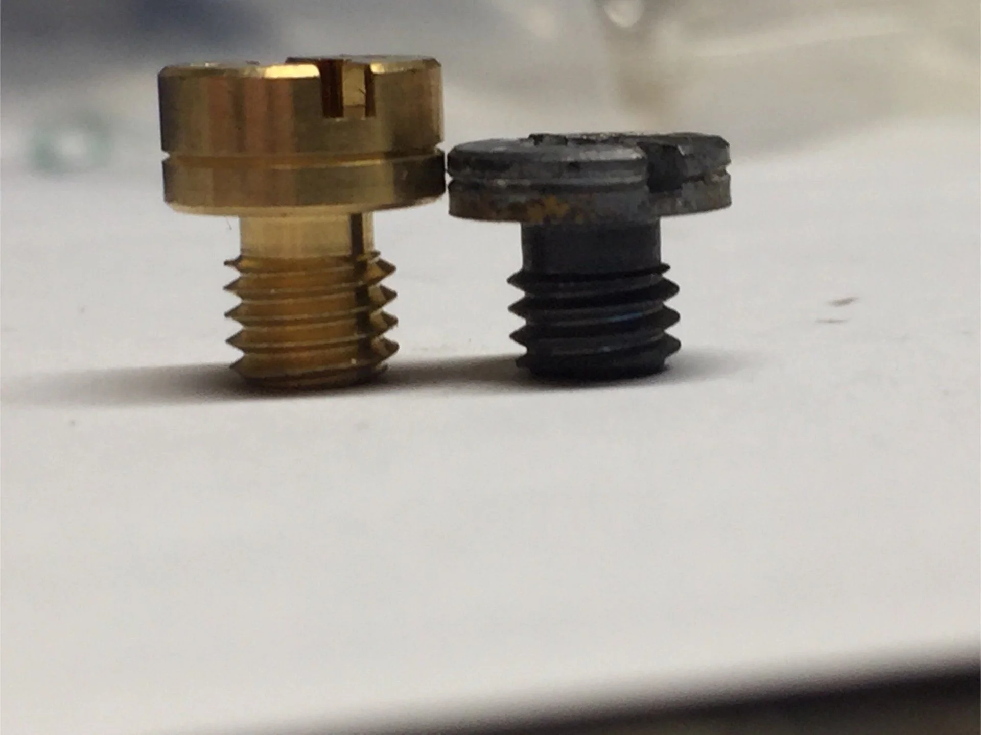

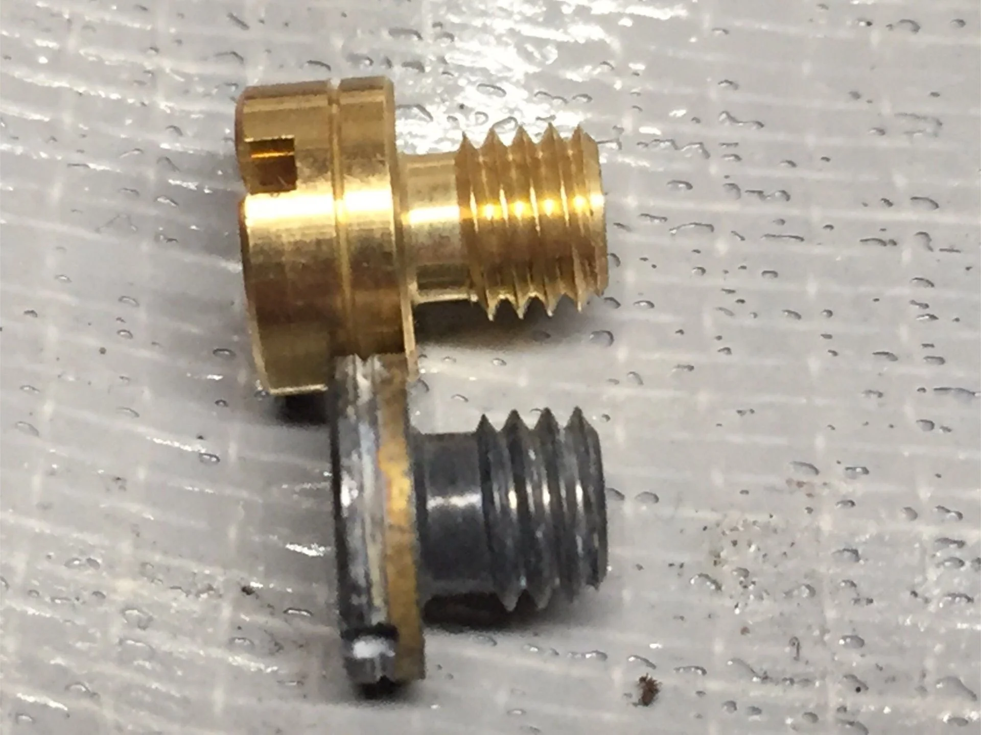

Here’s some pics of a Mikuni large round main jet compared to a OEM main jet. The main jet is out of a 71-74 Aisan carb. I assume 76-76 Aisan jets are similar, just larger.
Memory is fuzzy, but I think the Mikuni thread pitch is .75 and OEM is .8. Another mudder worked in the Mikuni jet by threading it into the spare jet holder(drain plug)
Got this off ebay. I think this is a authentic Mikuni, not a Chinese knock-off. Can’t find the sellers name. It was a cycle shop
From left to right
OEM power jet
OEM main jet
Main jet from Keyster kit
when you say "worked the pitch", do you mean that by doing do so in the drain plug it shapes the pitch of the mikuni and makes it fit and/or not strip threads of the carb?
