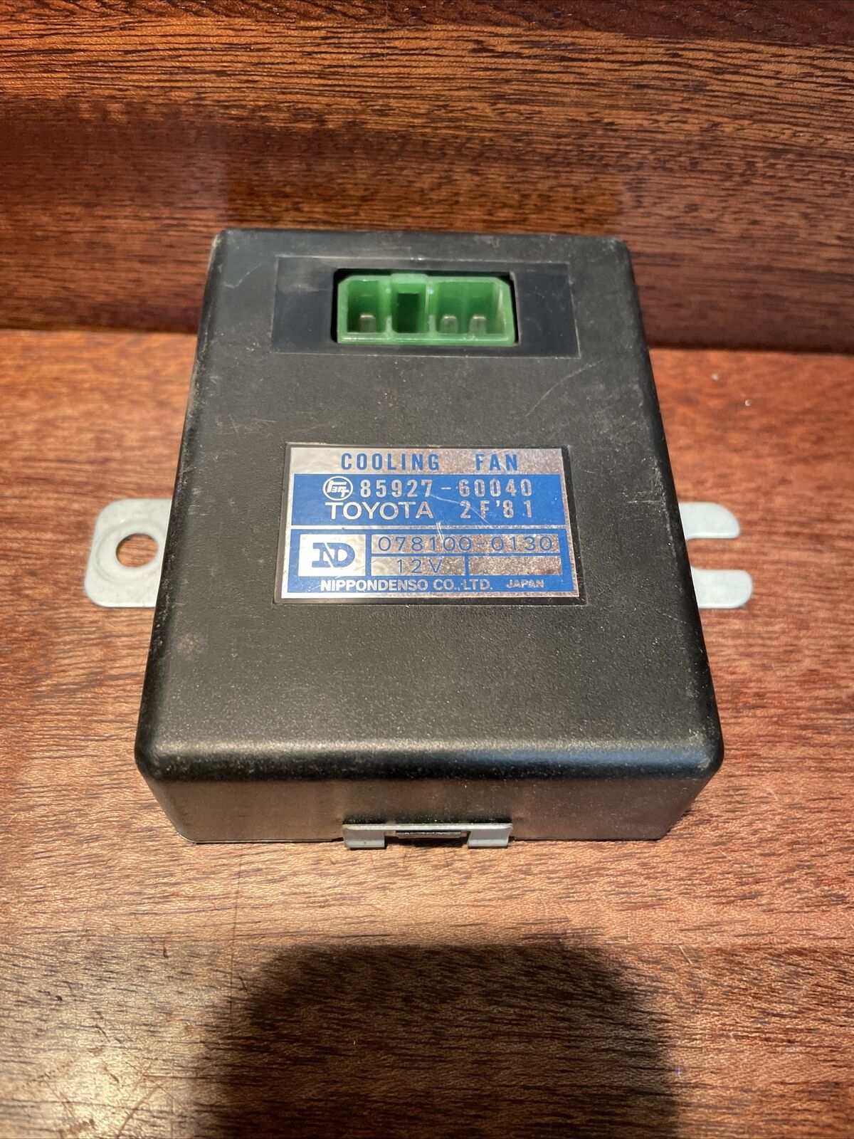

To troubleshoot after reading up on here I checked my relays behind the fuse panel as I understand there is a cooling fan relay here and it upon looking it looks like I am missing a couple of relays but I am struggling to figure out which ones are missing? I have attached an image to show you.
I have been trying to use the below image from the FSM as a comparison but it doesn't appear to match up. There are three spaces to the side of the turn signal flasher in my photo, but only 3 spaces in total for relays in the FSM image.
Any advice here would be great. Would the fan run but not turn off if the relay was missing?
I just want to rule out this before further investigating the temp sensor etc as I know that's most commonly the issue...
