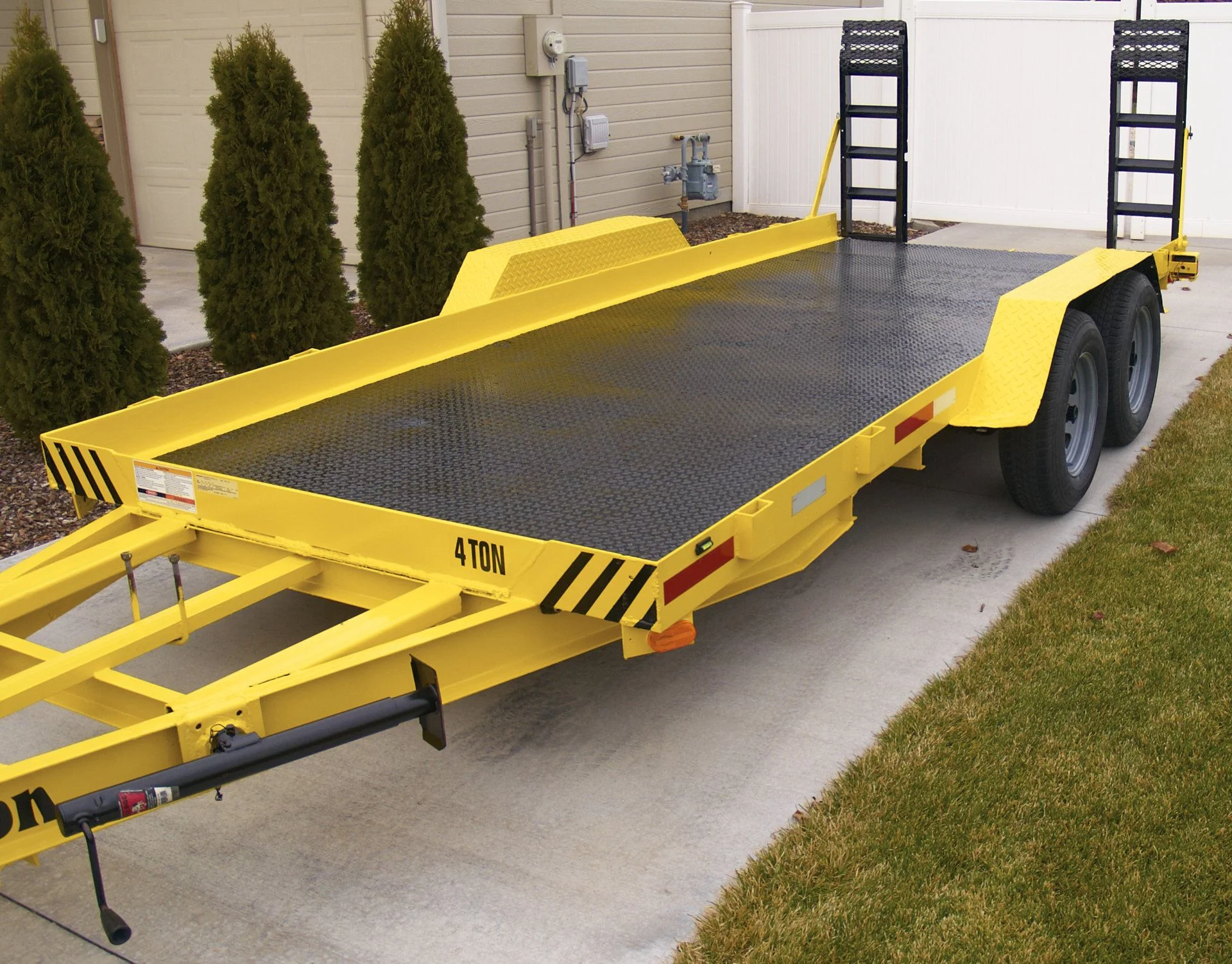

Having worked around both wood and steel trailer decks I'll never own a steel deck. They're great until you try to walk on it when wet, and then you'll be lucky not to break your neck. Tread plate AKA "Diamond Plate" is a joke, it's got no more traction than a smooth sheet.
I would consider a steel "deck" if made from something like this with a high enough load rating: Grip Strut™ Metal Safety Grating | Direct Metals
You can paint the deck with a good quality safety metal paint as I did, but must be primed, I used a gallon and added fine sand few cups, mix and add more if needed. Anti skid. Does not seem to let the sand break the surface so far when scuffed.
Also can use aircraft wing walk paint but can be a few bucks for a gallon.
I just redecked it. Why would I cover that all up with metal? (and still not treat the wood).
I hate metal decks. Out here they are ridiculously uncomfortable during the summer.
