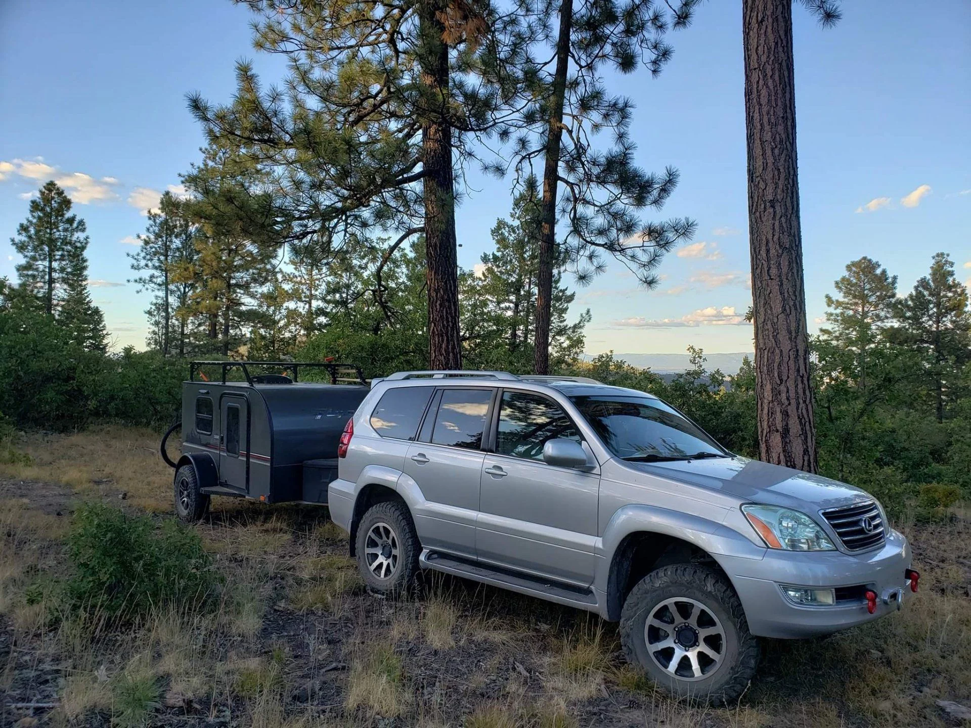

Old GX470

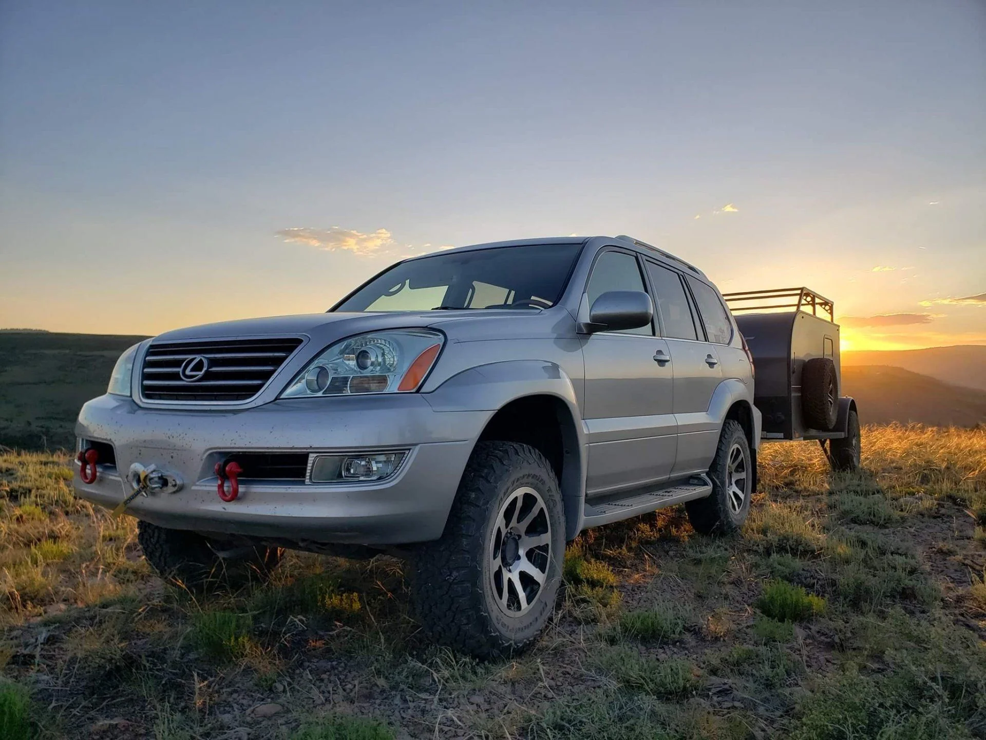

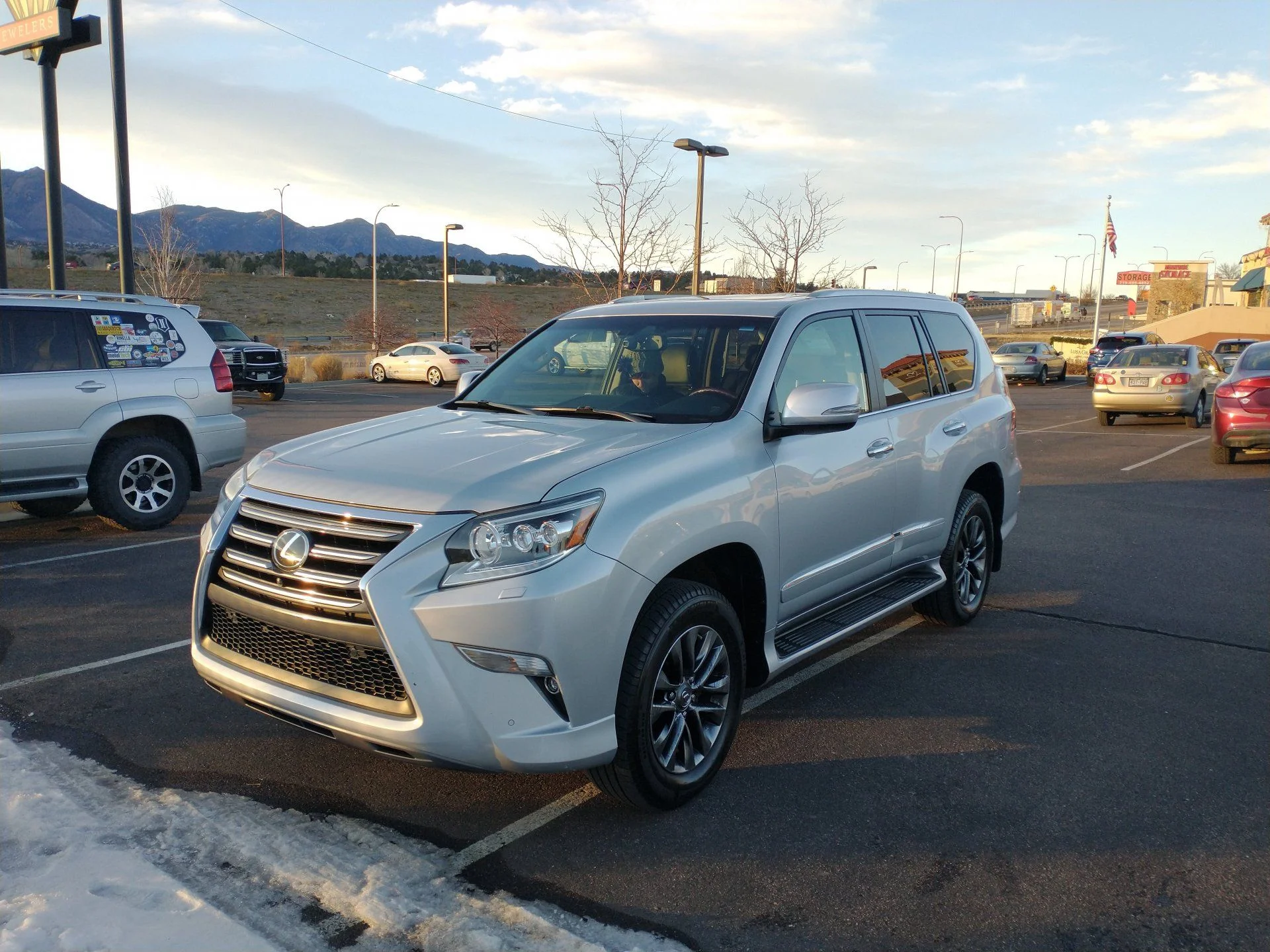

GX460 day of purchase

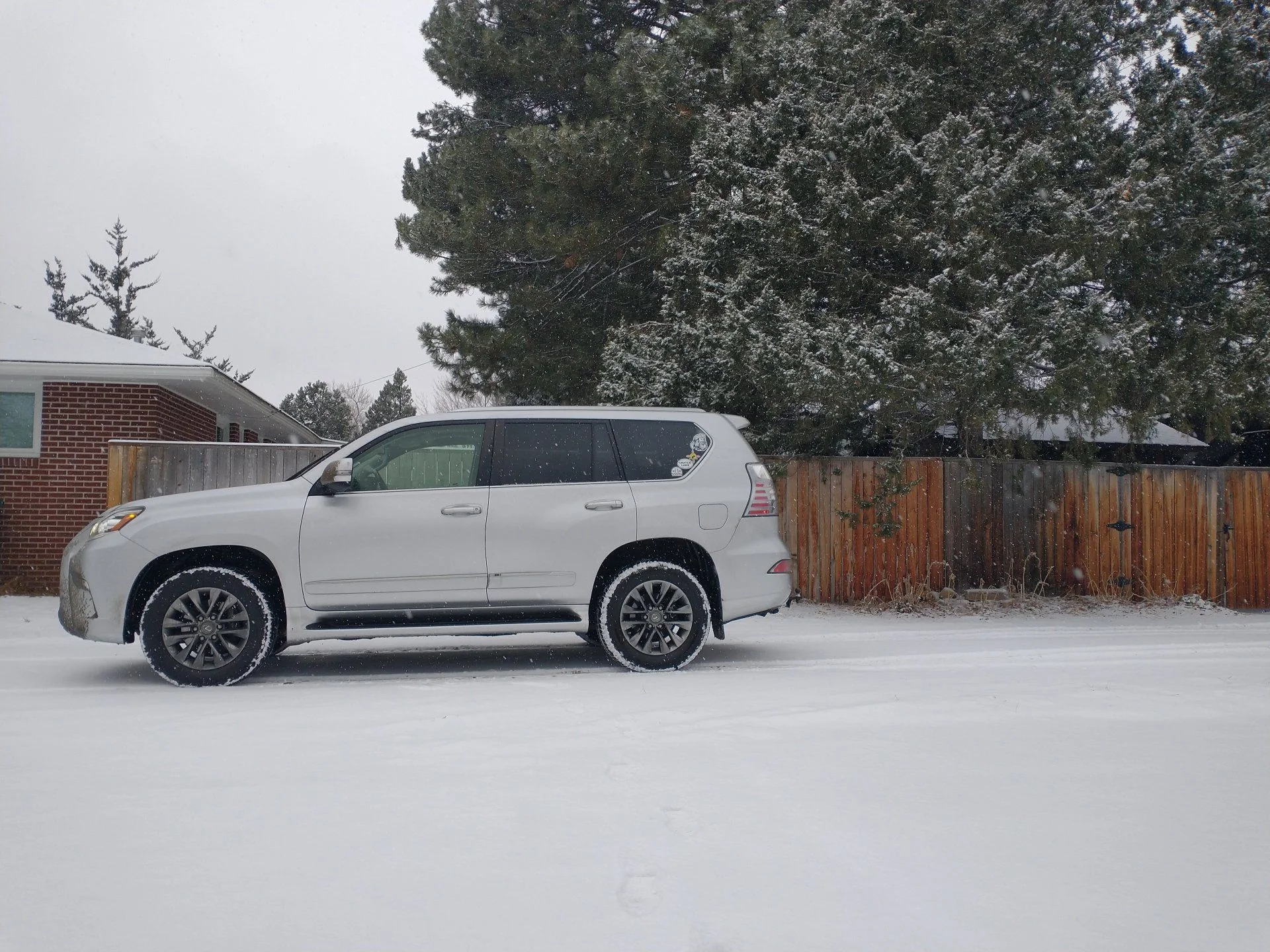

First snow before the wheel/tire swap

Build philosophy is inspired by the Lexus GXOR concept but with an eye towards a realistic budget, camping, hunting, and fishing.
Sold my old 470 for $14,000 which covered all my mods, 25k miles of use, and the purchase of the vehicle plus a bit. Figured I would get out while the getting was good. Paid $30,000 for the GX460 from a Toyota dealer. In CO this was a smoking deal.
First mod was FJ Cruiser 8 hole wheels with BFG KO2 265/70r17 C loads tires. Good mix between weight, durability, etc. This is the size I'll be sticking with since it fits in the stock spare location.

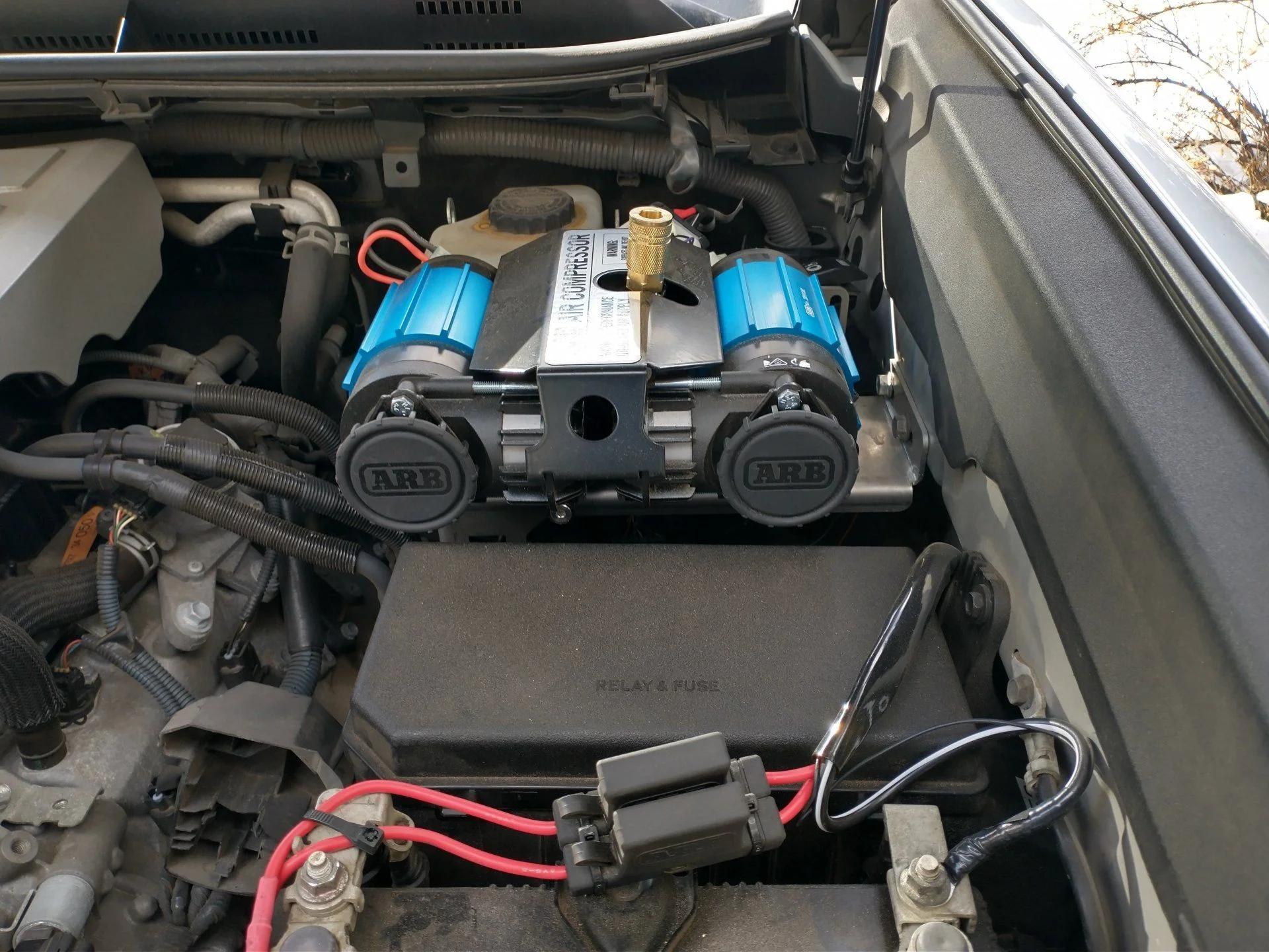

Added an ARB twin compressor and Slee mount under the hood. The switch is simply mounted to the bracket. Since you have to pop the hood anyways this makes for an easy install.

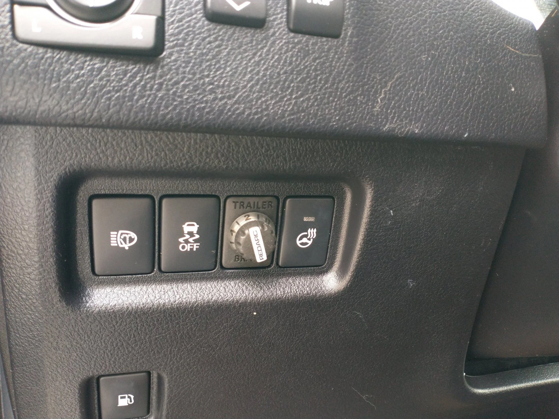

Added a redarc brake controller for the little trailer

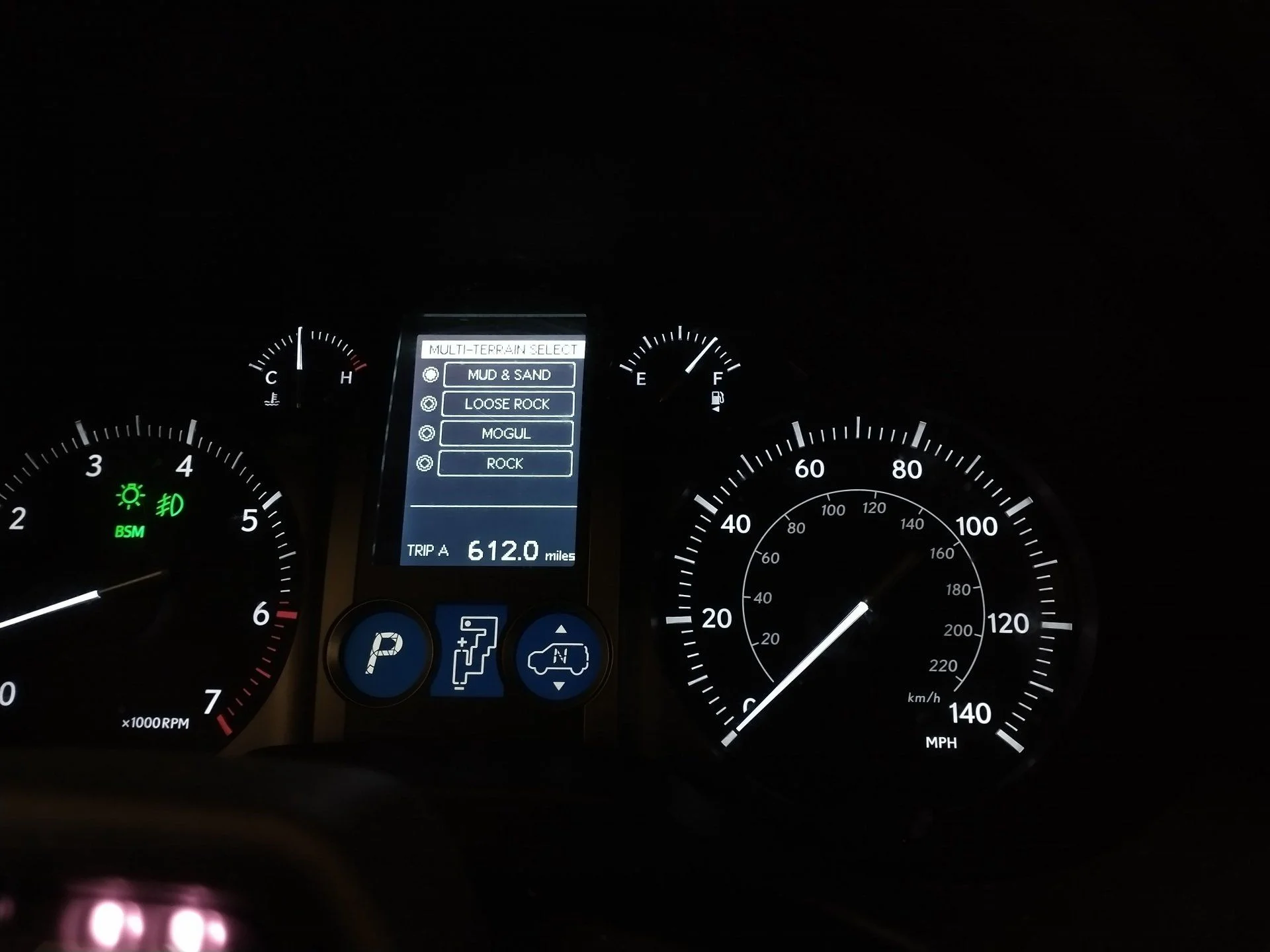

Next up was a quick and easy upgrade. Adding Multi Terrain Select. Since my GX already has crawl this only took about 30min to install.
Seemed like it might be gimmicky but after testing in the 20+" of snow we received in CO I'm actually quite pleased and could truly tell a difference between each mode.

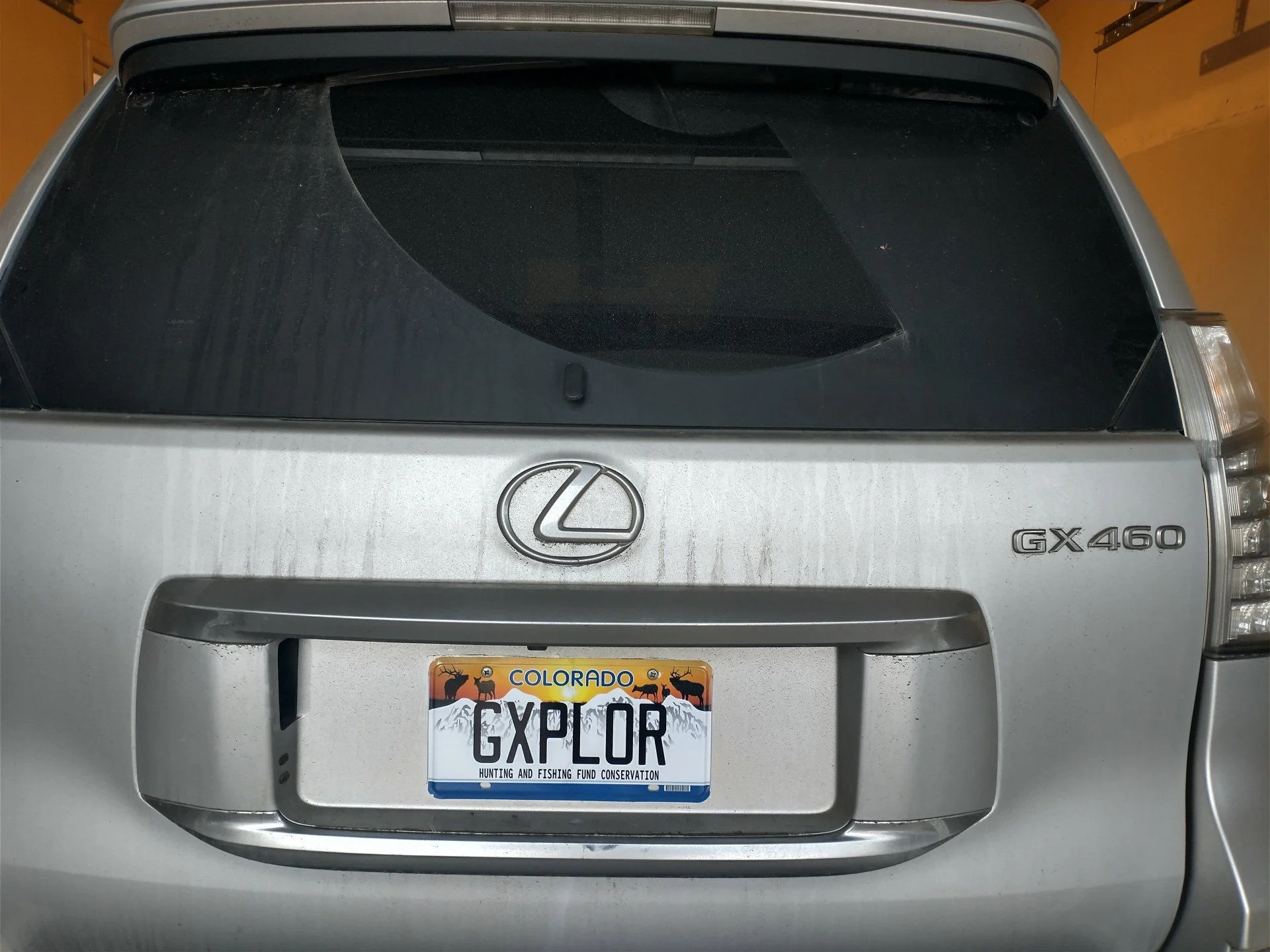

And my plates finally came in. Sadly GXOR was taken haha.

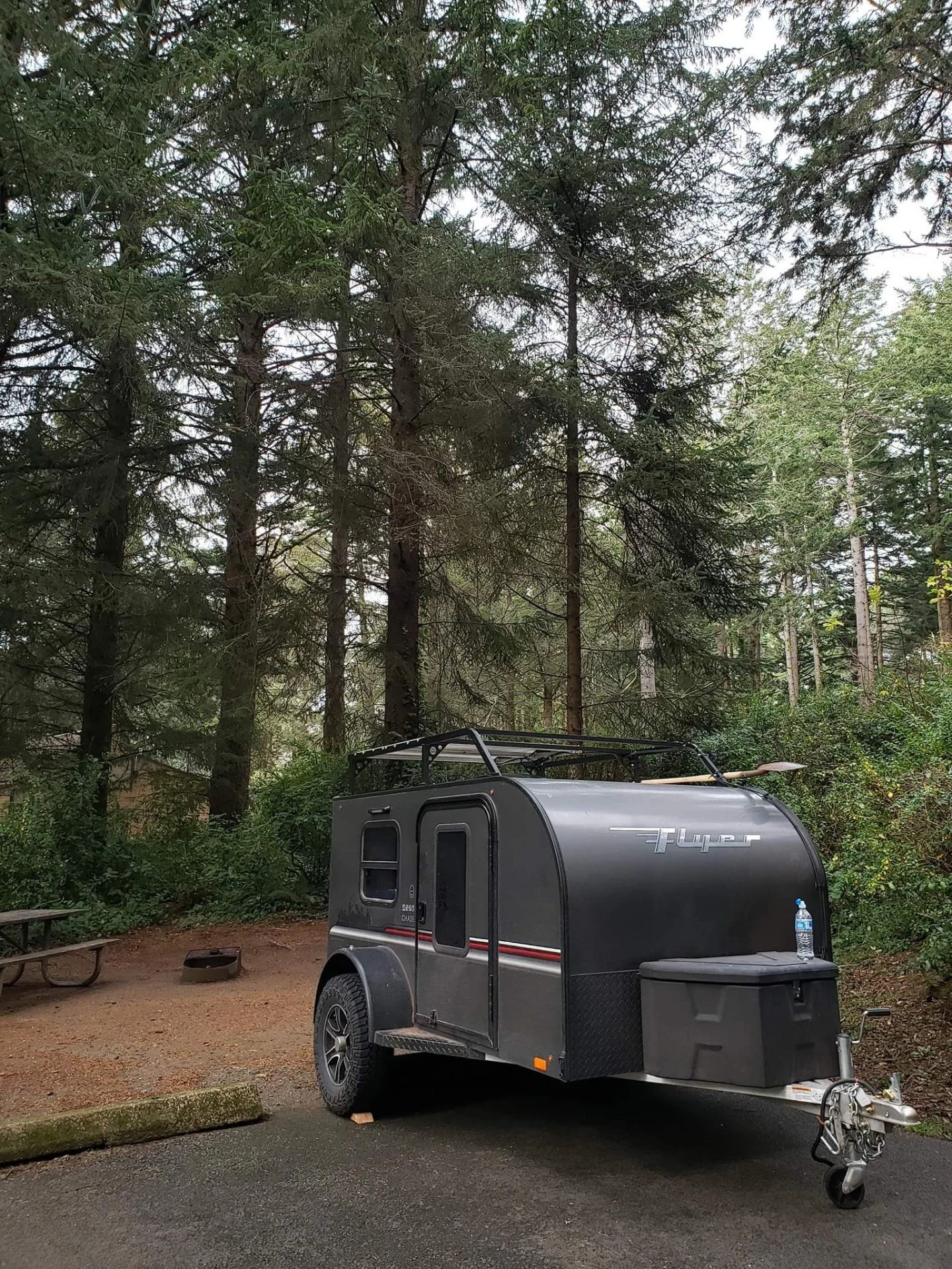

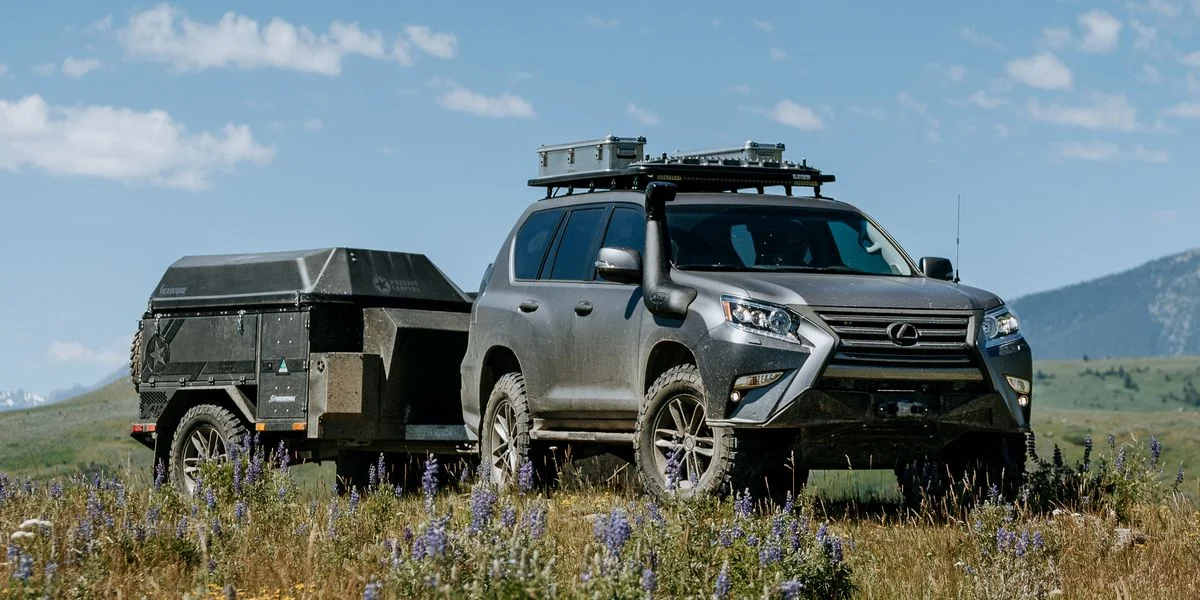

For the trailer in case anyone is interested.

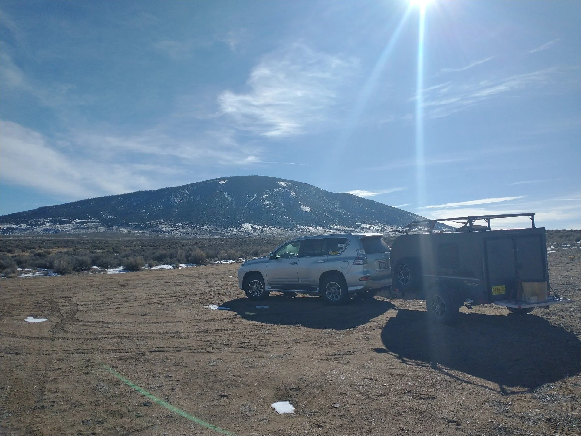

It's a 2019 InTech Flyer Chase with the offroad package. I added 200w of solar on the roof and a propex hs2000 heater. Weighs about 1,000lbs and has been super durable on a cross country trip and being drug on a lot of off-road/forest roads throughout the west for hunting.

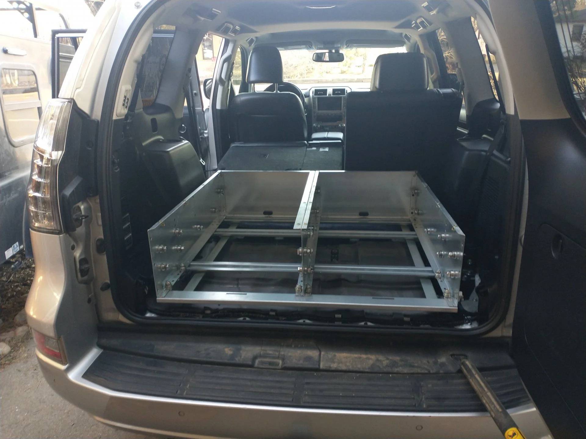

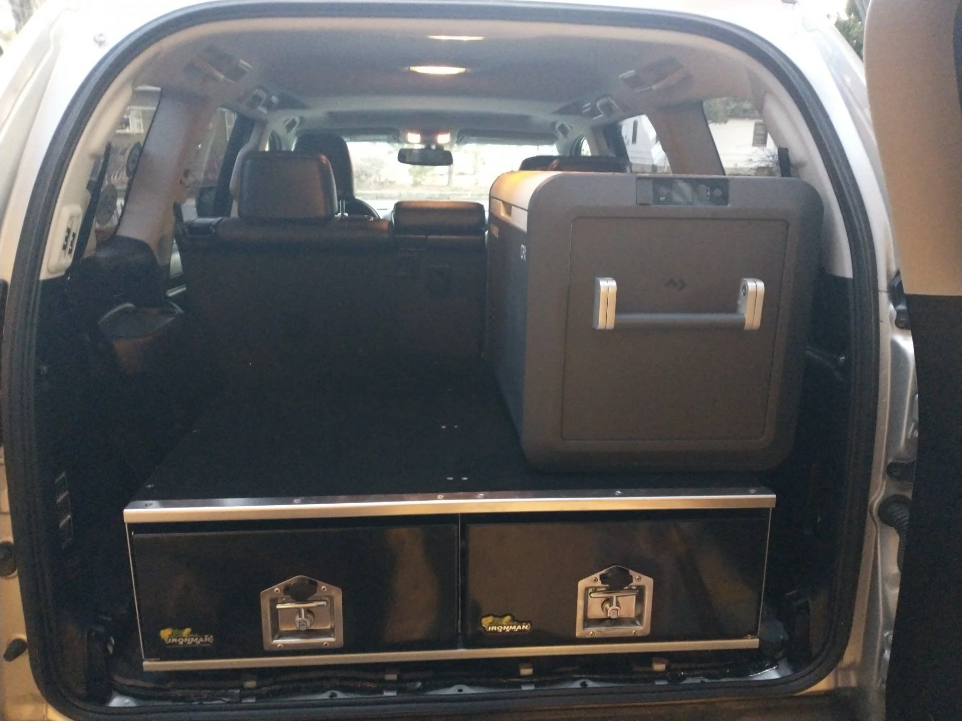

That's it for now. Currently waiting on Ironman 900mm twin drawers, Ironman Foam Cell Pro stage 2 lift kit and coil conversion, and the CBI covert front bumper. Hoping to receive the Ironman stuff in the next week or so. CBI sounds like early May.

@Pirate, do those drawers come with a built in fridge slide? If not, look into the one sold by ironman4x4. I just installed mine and they are very well built, solid, and reasonably priced.
Is that aluminum framing?
I'm going to run without a slide for a bit. If it drives me nuts I'll get one but currently I can open the lid far enough to easily reach everything so I might as well save the money and 40lbs.
