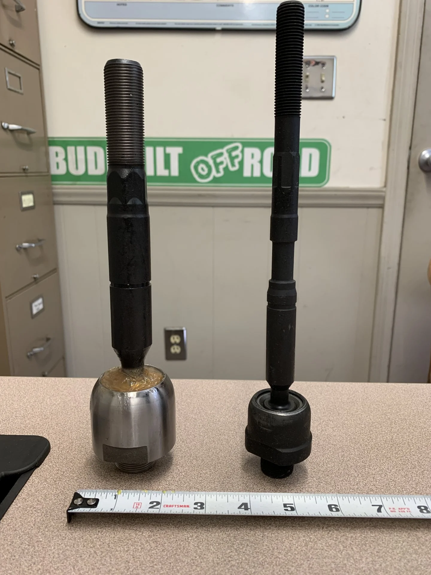

LX is in an entirely different category of ruggedness and durability.
Comparing the two is like comparing a 1/2 ton truck to a 3/4 ton.
All the components of the LX are much heavy and beefier.
The GX is relieable but can’t touch the LX in pure HD ruggedness. It’s hidden under the skin but it’s there.

I love it one pictures that tells all !
