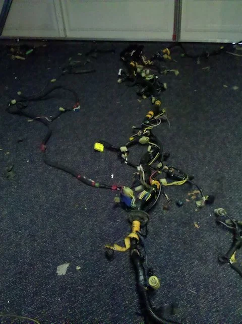

i currently have taken the body off/ entire wiring harness out of my 89 fj62. Have everything plugged in and sitting on top of the motor. let me know what i can do to help. 860-368-8802 -Ben
Keep in mind the majority goes to power windows, mirrors, rear window heat, door sensors to turn lights on, speakers.... that you prob wont need. I am contemplating just stripping mine down to engine sensors/ ecu. Then splicing in to my 60.

anyone,
what is the large yellow connector front forward in the above photo? where does it connect in the engine bay? I have 89 with newly installed used 88 engine.

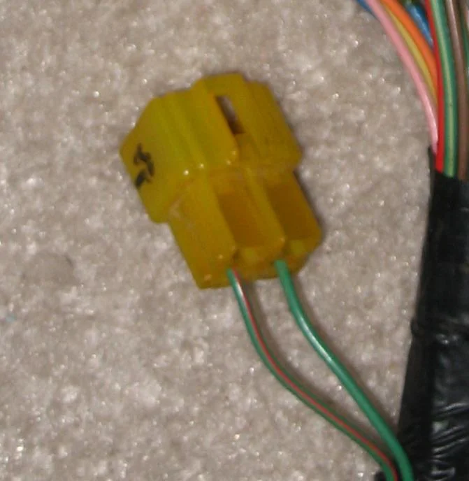

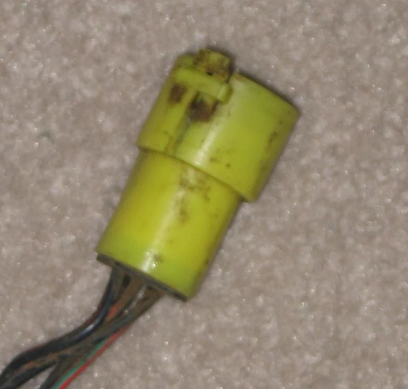

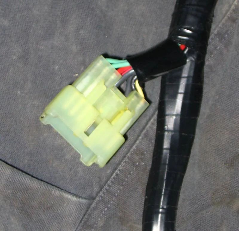

There was only one connector I found that was different between the two. The 1989 harness used one plug while the 1988 used two. They pin out:
1989 connector vs. 1988 connectors:
• From: Ignition-Starter (neutral start switch) (B-R)
• From: Ignition Fuse (B-L)
• From: EFI main relay (Y-R)
• To: Tachometer (B)
• To: Fuel Pump (R-G)
• To: Water temperature gauge (G)
• Bridge: AFM to TPS (G-R)
First pic is the connector from 1989
Second and third pics are from 1988.
They both functionally do the same thing. They connect the engine harness to the cowl harness. The 1989 harness was still available from the dealer. The 1988 was not.
