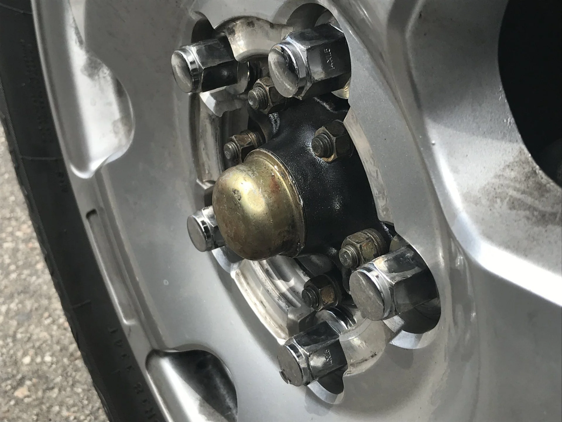

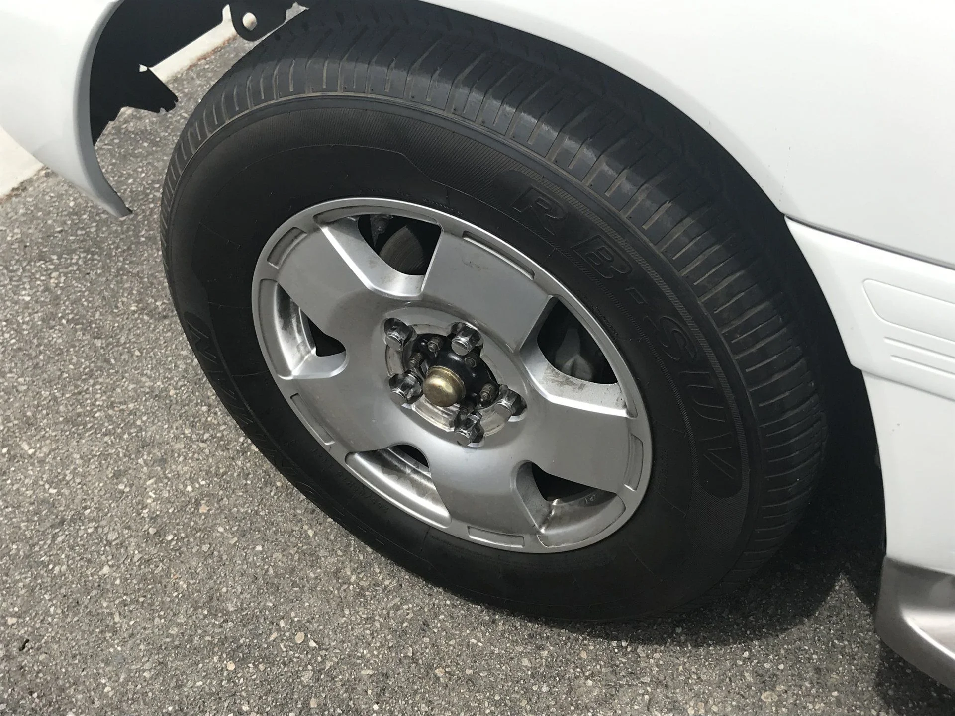

Hi,
I recently bought a 2004 Land Cruiser and was having some problems with the car shaking at about 60mph+.
I had the tires balanced twice, but it wouldn't fix the problem. Another mechanic realized that the previous owner had spacers mounted on the wheels, which then I had removed. It took care of the problem! However, once the spacers were removed, I couldn't fit the ornamental center hub caps back on on the front wheels, as the grease caps stick out too much. The mechanic told me that either the wheel assemblies and/or the wheels are after market.
Can anyone identify, if either the wheel or the wheel hub assembly isn't original? I would like to restore everything back to original - if possible.

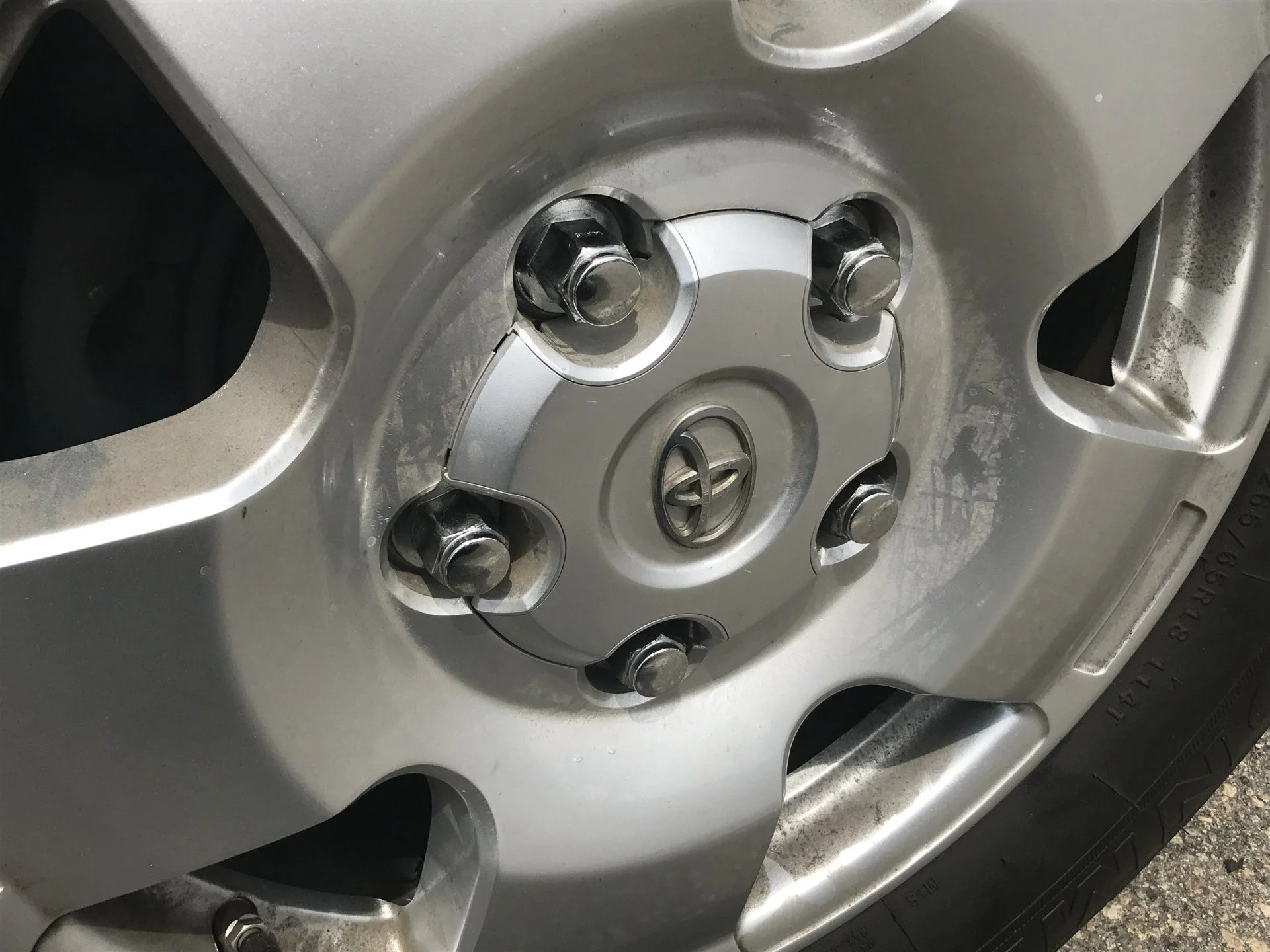

Below, you will find photos of the front tire without the ornamental center hub caps (with the brass colored grease cap sticking out), and a photo of the back rim, with the hub cap put on.
Thanks!

That’s an oem Tundra wheel.
Some folks flatten the grease cap to fit the wheel cap over top.

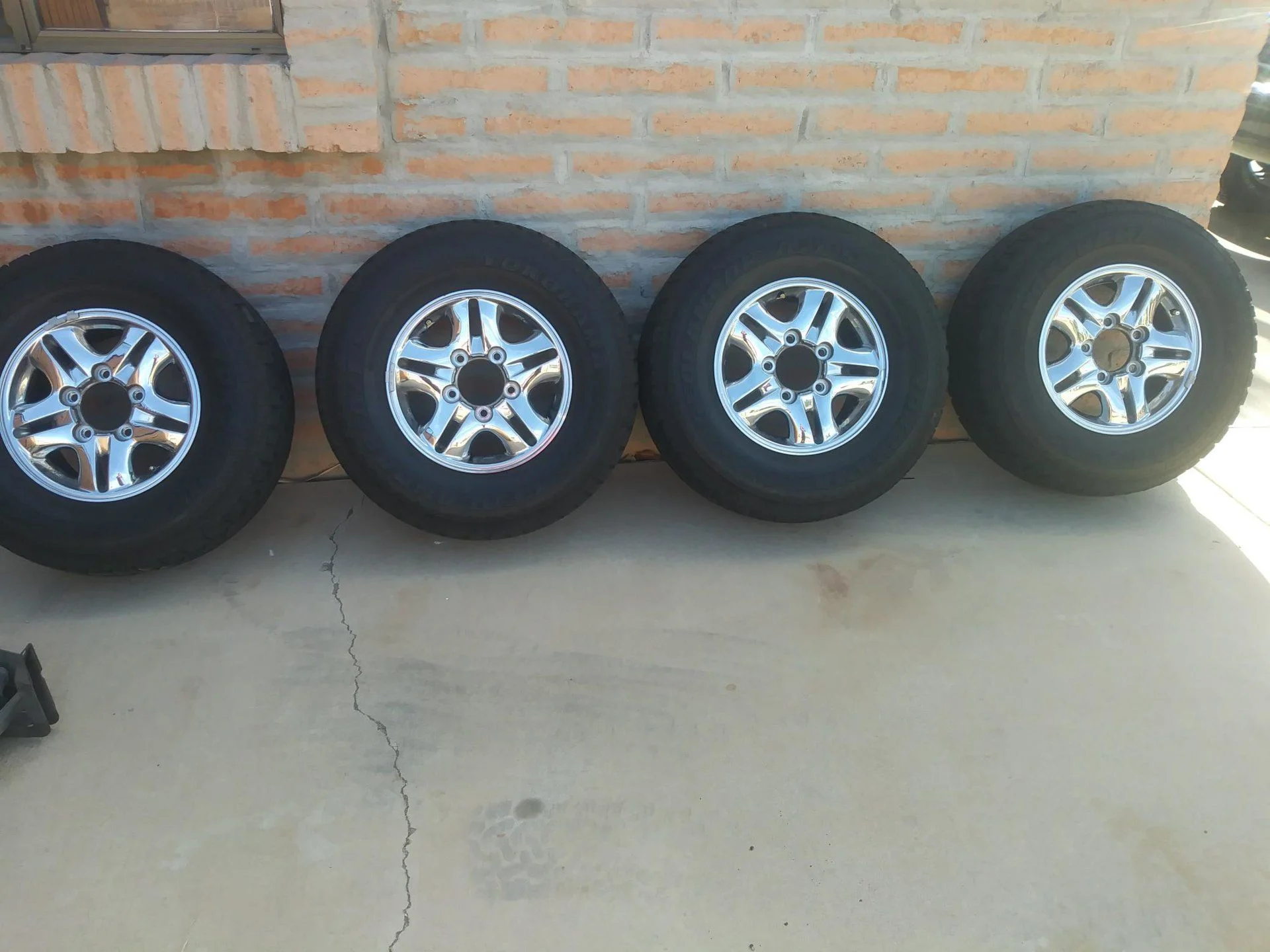

Would anyone know where I might find a used set of original 2004 Toyota LC wheels?
(I'm a purist, and would much rather keep everything original ;)
1.) There is a different size grease cap that one member put on to improve clearance. Unfortunately I don't know the part number. Others have drilled a hole in the plastic to allow the grease cap to protrude beyond the wheel cap (plastic part). Others have adjusted the grease cap by hammering it flatter, to improve clearance.
2.) Check the local buy and sell sites. Also, ih8mud classifieds. You live near an urban area, so you might be able to find some 18" LC wheels promptly.

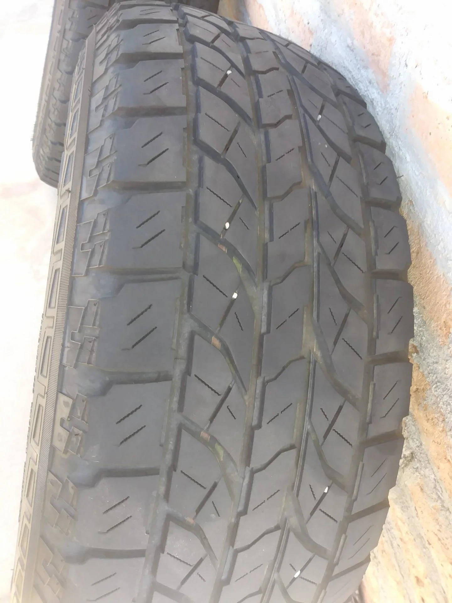

There are some cheap ones in Phx if you're this way.
A nice set of wheels off of 2002 LX. All lugs center caps etc. The tires are 275/70/16 Geolanders and according to the documents I received with the truck they have about 4,000 miles on them $200 obo Open to trades as well.View attachment 2026199
