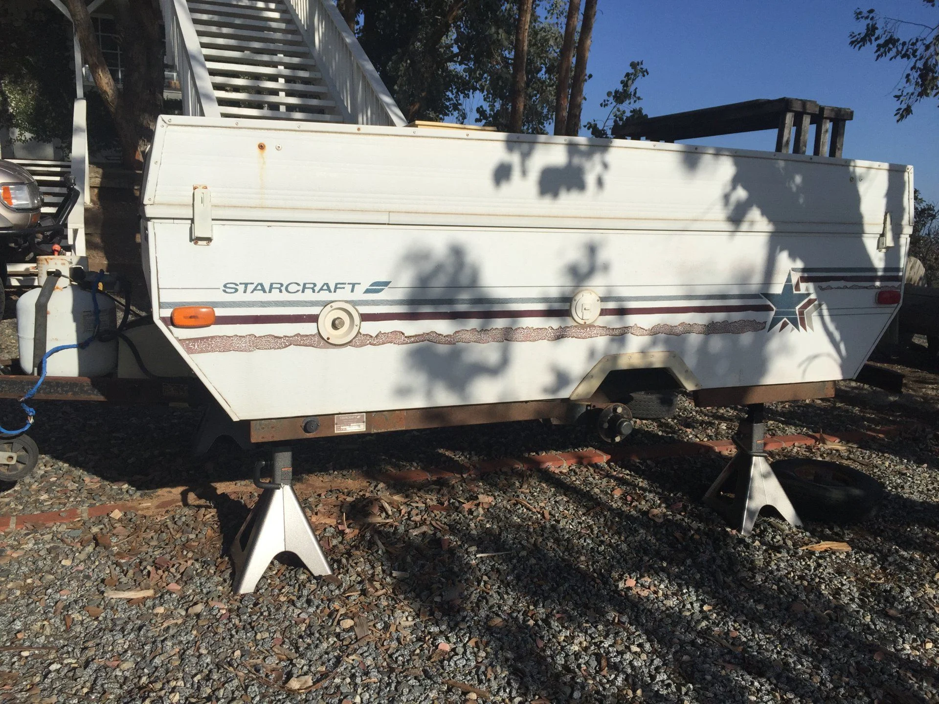

I’ve been thinking about getting a popup camper for a while now, but I just couldn’t bring myself to spend the cash on a Jayco Baja or Coleman E1. I halfheartedly check Craigslist every now and again to keep myself interested in the idea. I couple of months back I was talking to @Cruiser Bauers about it and said that if I could find a decent trailer as a starting platform I’d be willing to build my own.

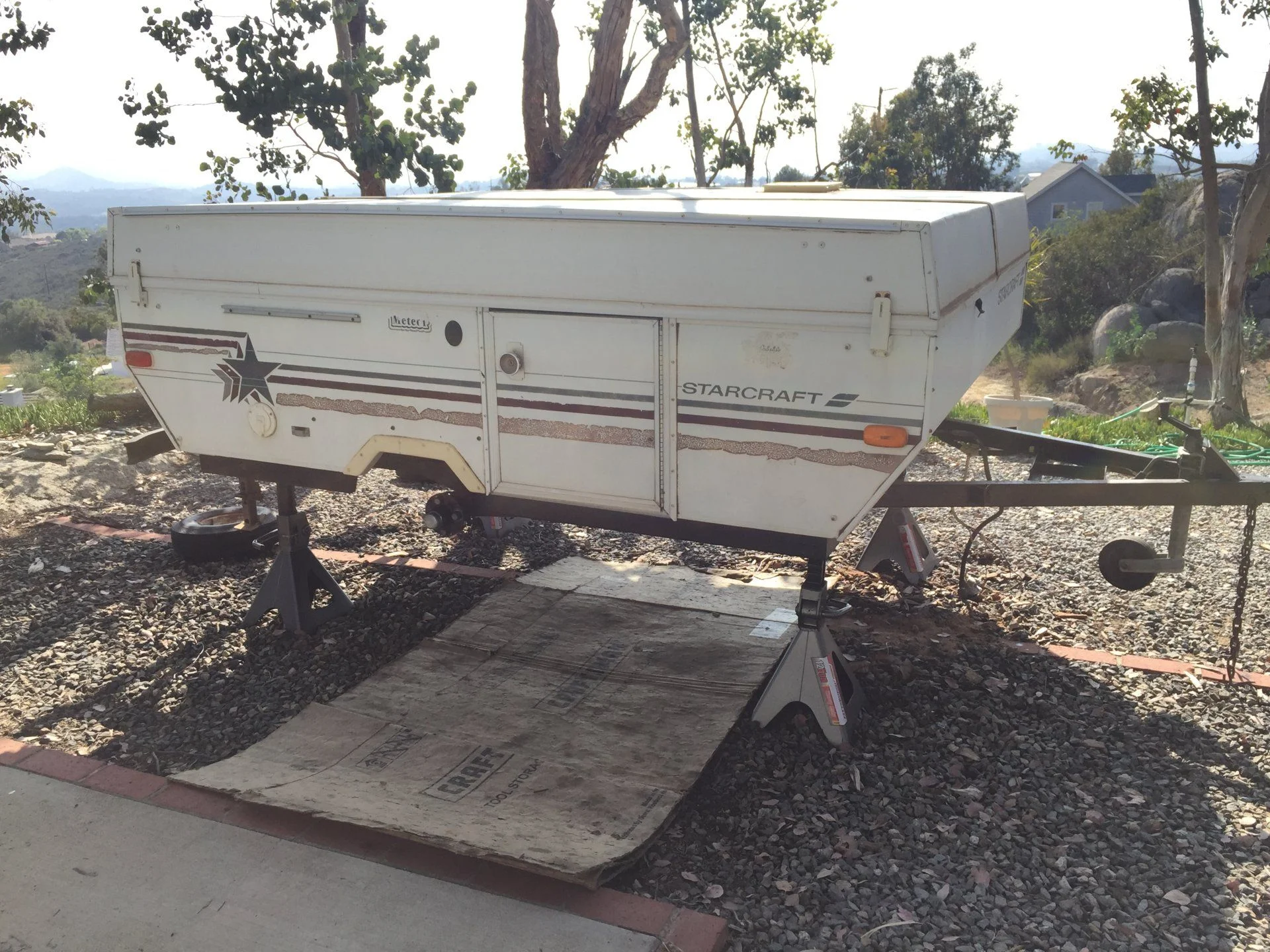

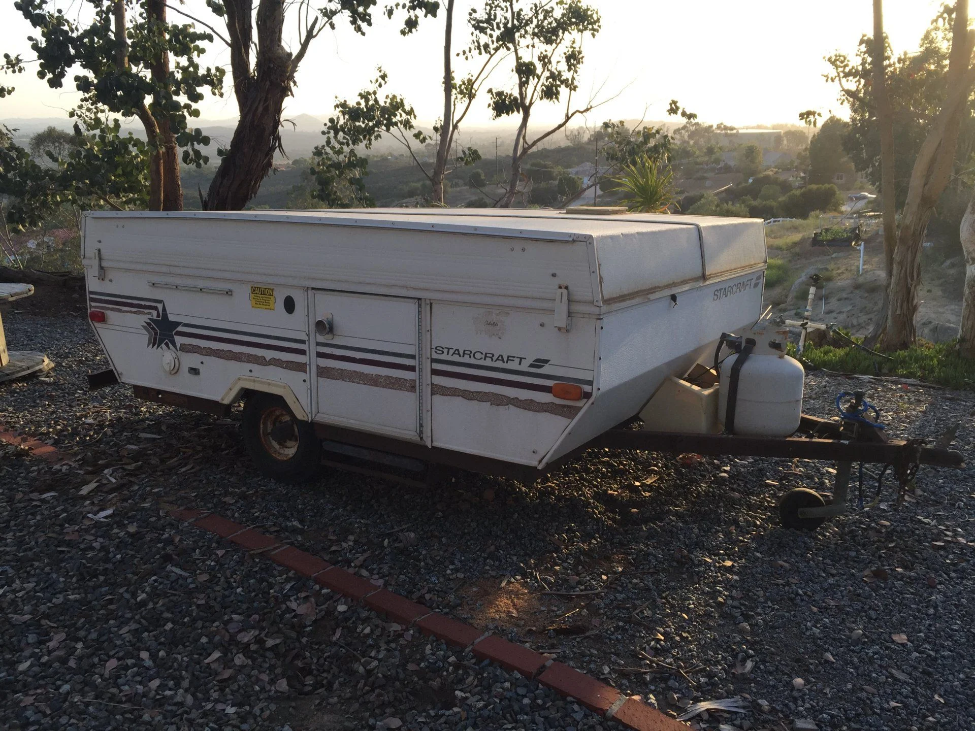

Fast forward to two weeks ago, Jeff called me to say that he knows a guy giving away his popup. A few text messages later and I have a 1990 Starcraft Meteor popup camper.
The plan is fairly straightforward, rebuild everything :lol:.

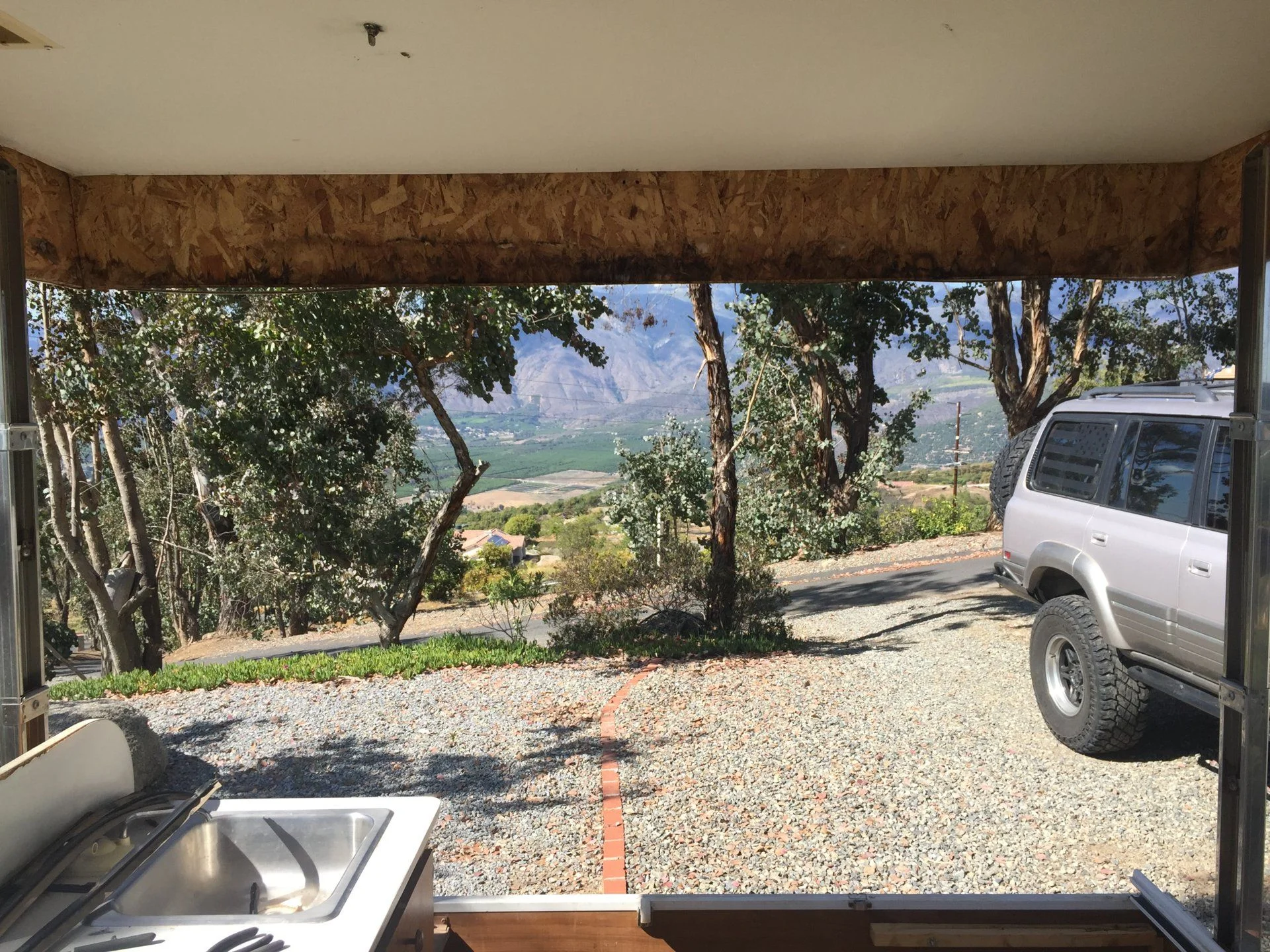

Spent a couple hours dealing with the trailer again today. Finished cleaning the frame and applying Corroseal. Next removed all the old canvas, curtains, and pulled the beds out. Upon removal of the canvas we saw that the front and rear portions of the roof have some water damage from a leak at the seam. So I will need to pull the roof and replace the wood.

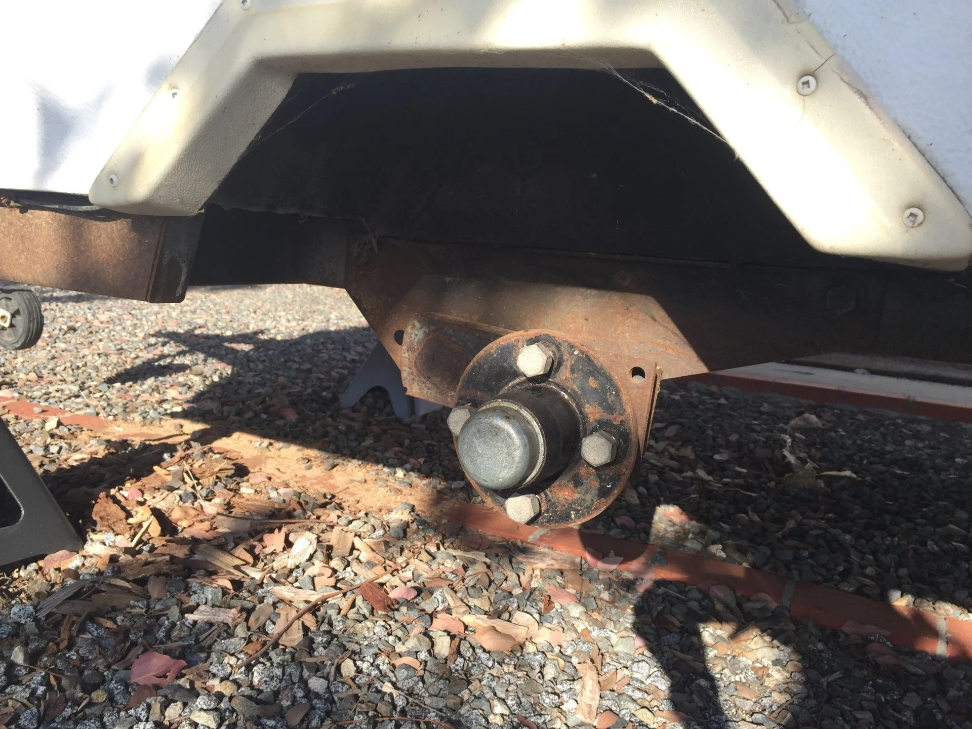

Also ordered tires this evening. Stepping up to a 205/75r15 from the old 5.70-8.

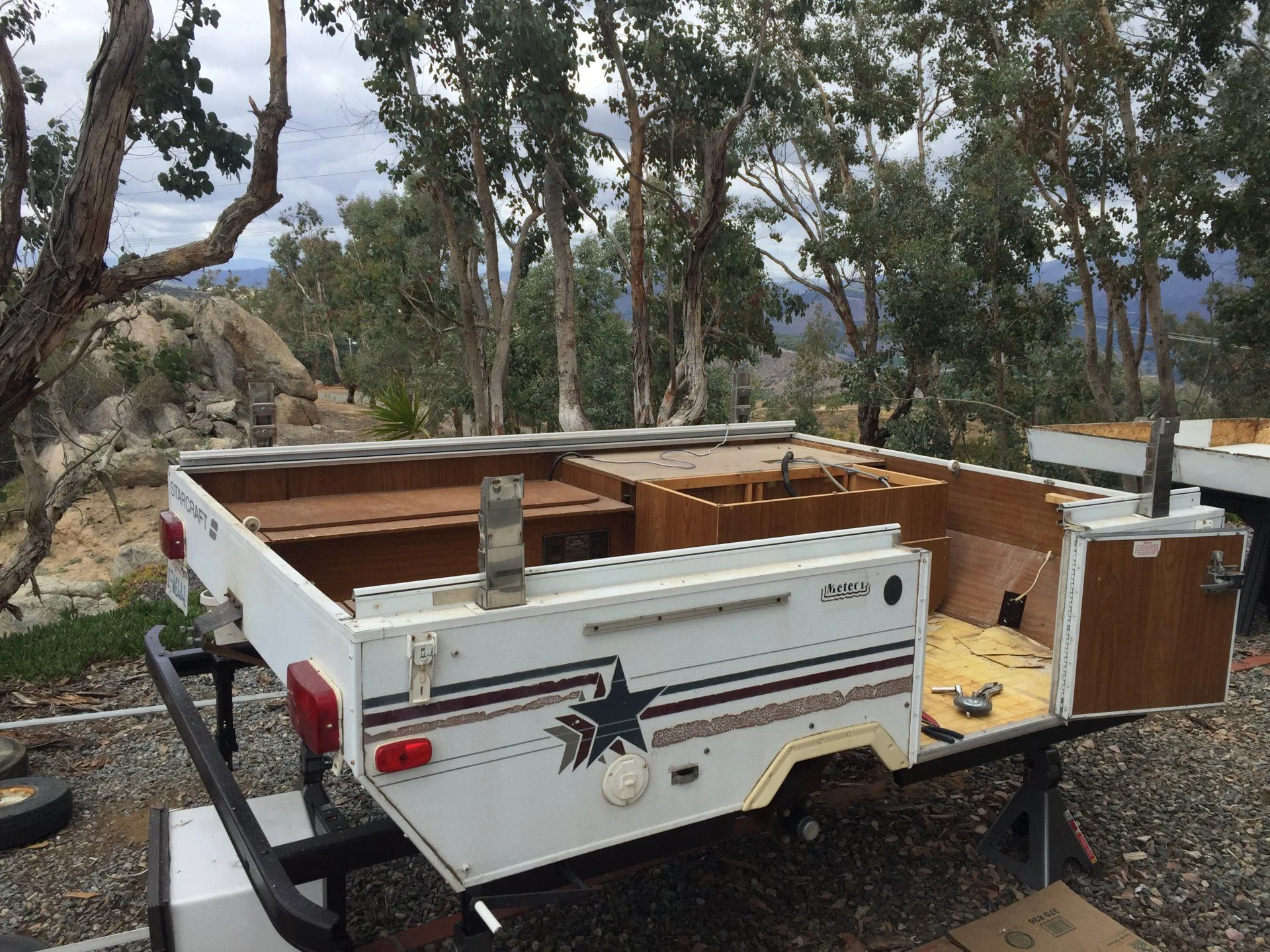

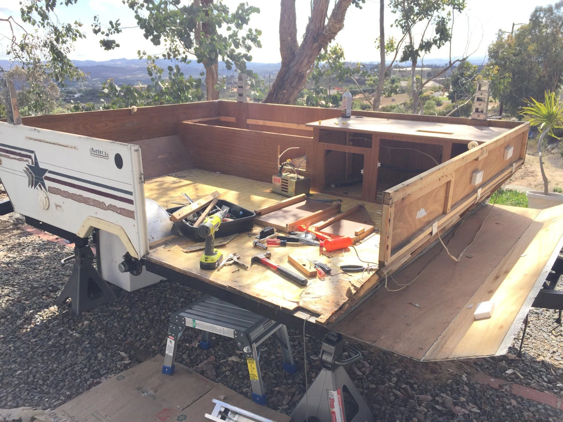

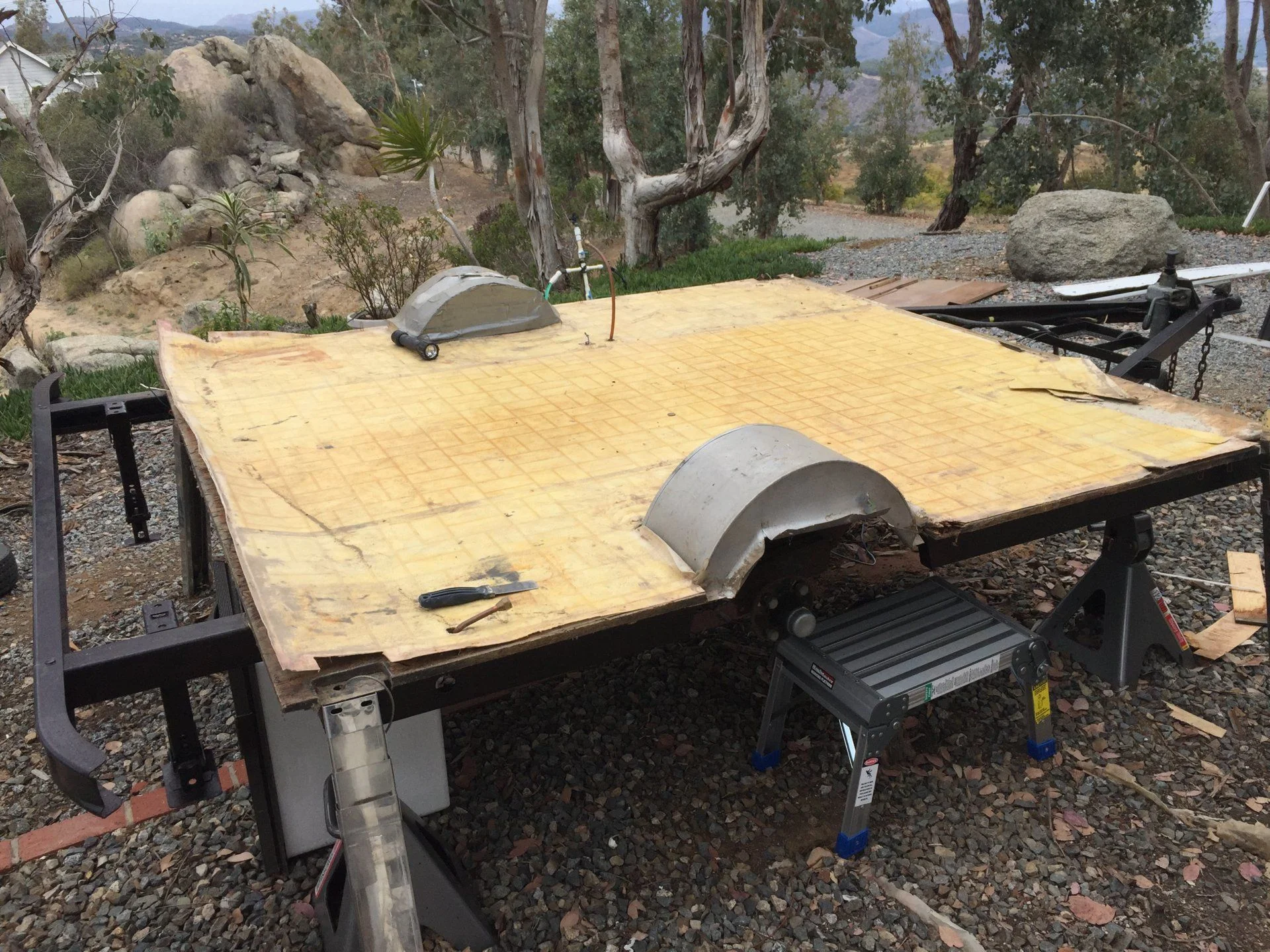

Started pulling the old seal off the roof and removed the old ice box to get a look at the floor below. I’m going to have a lot of work ahead of me. At least I have a nice view while I work.

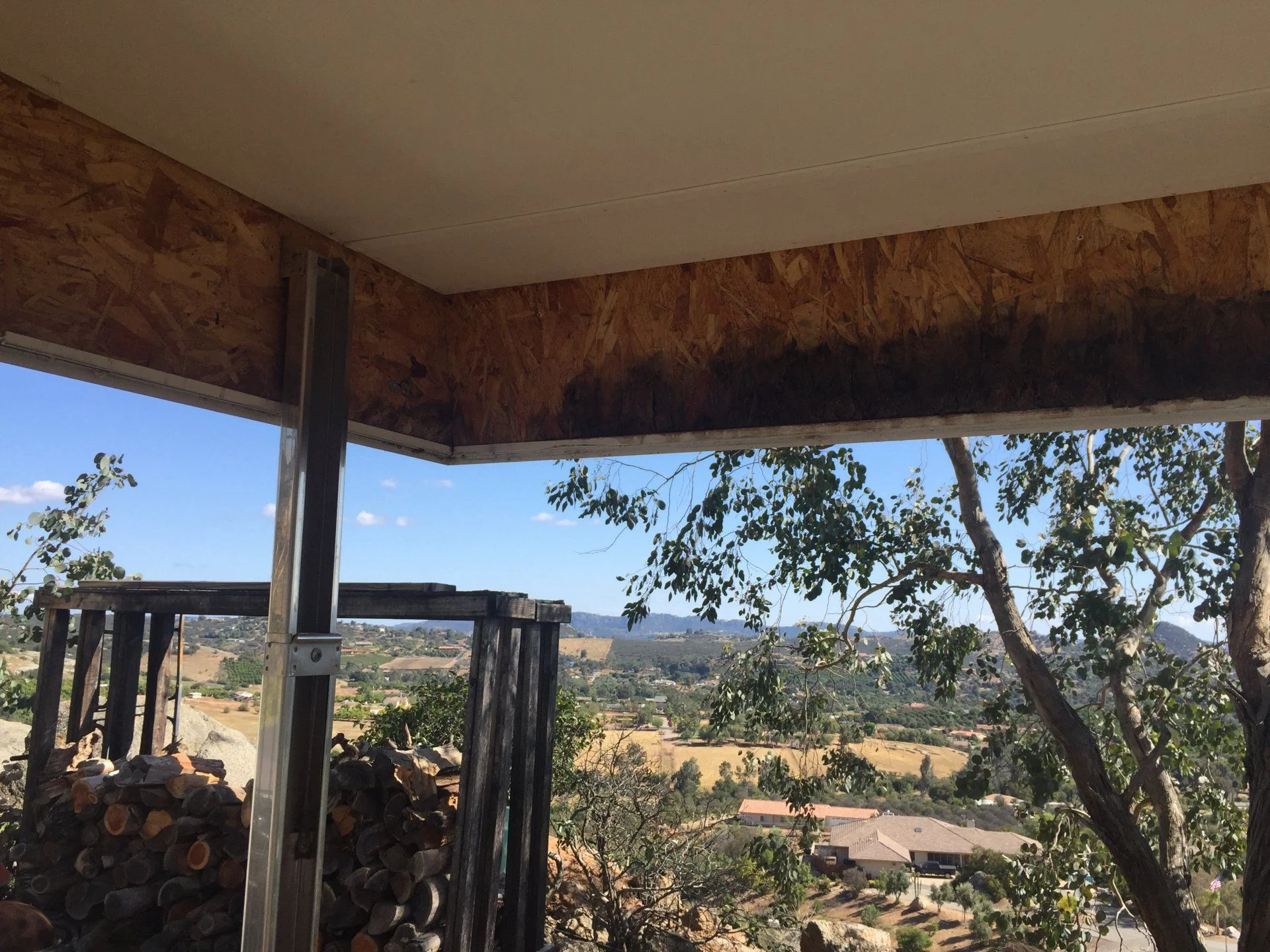

Some more demolition today. Got the roof off and examined. Looks like it’s just the sides that have to be replaced and that the center portion is still good.
:eek:
As for the rest of the trailer, it’s all going to be rebuilt.

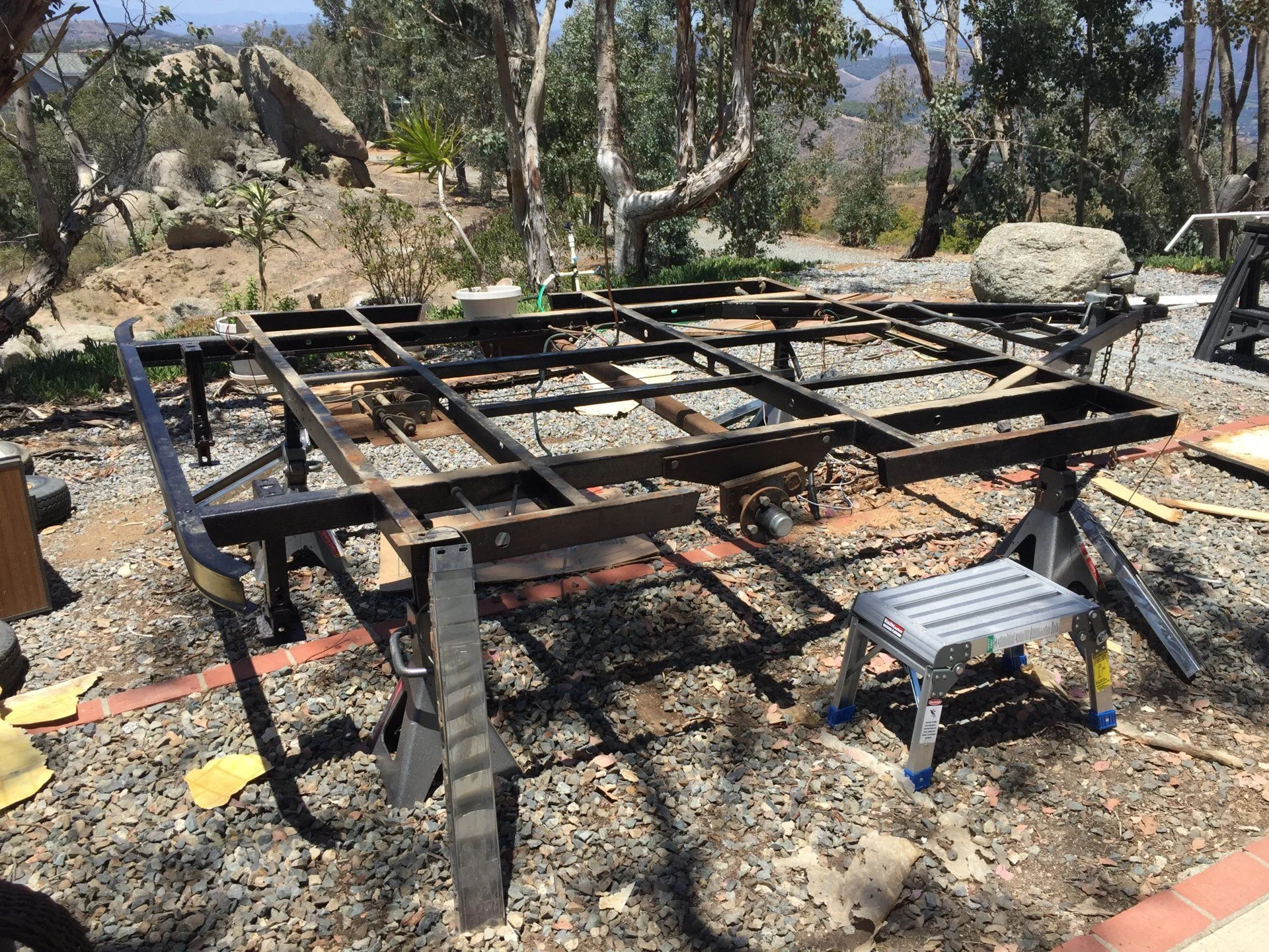

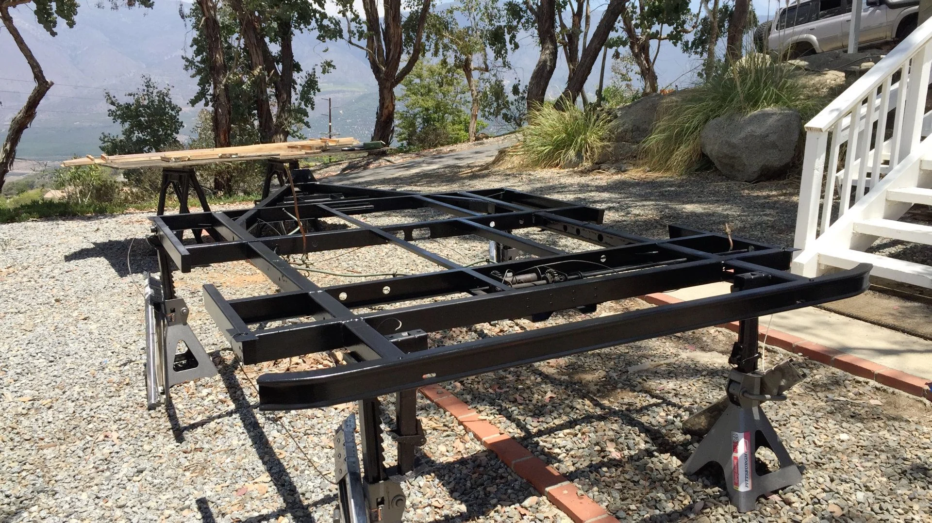

Stripped it down to the frame today, removed the old axle, and applied more Corroseal to the new exposed frame areas.
Not a lot of headway during the week. Got the frame stripped down, electrical removed, and painted satin black. Also started peeling off the old aluminum siding that is adhesived to the plywood sides. Just slow going with a 1” putty knife to not warp the aluminum too much.
