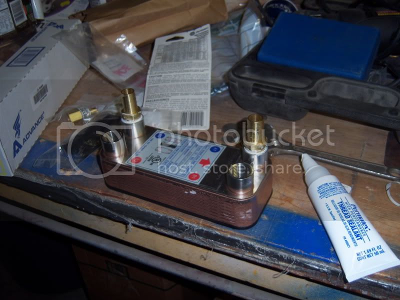

I was going to make a hot shower of sorts for an upcoming 3000+ mile cross country trip that fizzled. I was going to replace the rear heater with a small flat plate heat exchanger (pictured below) that would heat half the water stream after a splitter, and be blended back again via a flow valve to control temperature. All this seemed pretty simple and basic especially with a rack mounted swing out shower head on the passengers side above the rear side door. Then the shower curtain would have been a beach towel clipped to the top of the door and across to the rack. When you're done just step back into the towel and pull it out of the clips and around you. Ta-Da!
The "curtain" would probably need a frame or hoop of some kind to give you more room, and other tweaks to the design would be needed I'm sure but, this seems like a fairly easy way to get the job done.
However if the OP had an up and running unit for sale that I could use first, then...
An exchanger of this type and this small would actually be too big for such an application. The water would be scalding. Ten plates would be plenty.
