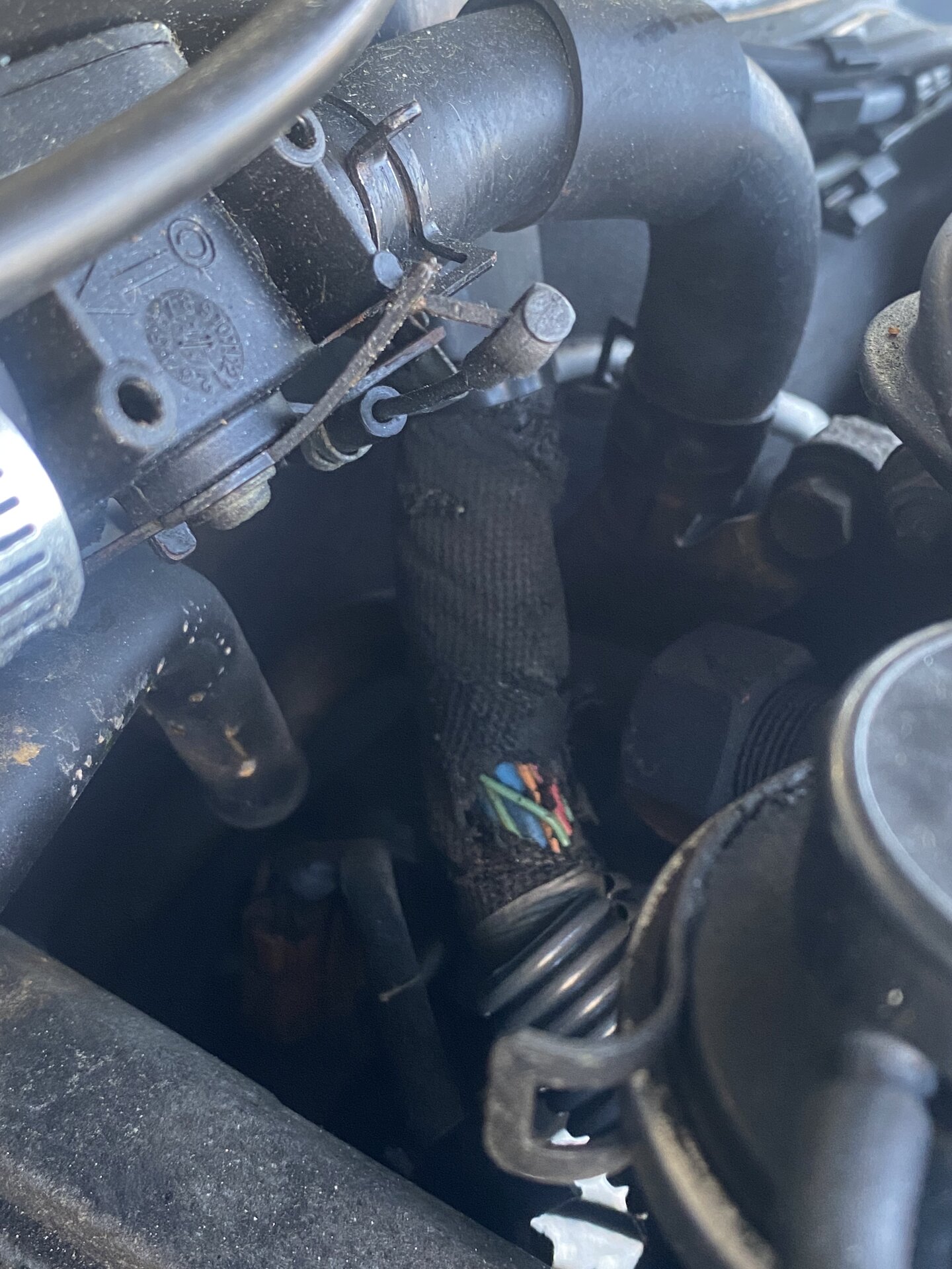

In the past couple years I've seen multiple FZJ80's have the shielded wiring fail that goes from distributor sensor to the ECM. Had a couple where it ohm'd out fine, but when I put oscilloscope on the signal it was horrible. Replaced with new shielded wire and problem cured. Just be warned it's a huge project to replace that wire and route it the same way.
"I've seen multiple FZJ80's have the shielded wiring fail that goes from distributor sensor to the ECM."
Can you share more details ie: where/why/how did the wire fail (near the EGR pipe?) and could it be fixed (spliced) or did you have to replace the entire length of that wire (or the whole engine harness)??

I can tell you the first time I saw it, it took all my spare time for a month to figure it out. I don't know where it failed at. It's a blue jacketed 4 strand shielded cable. I didn't want to take a chance splicing into it. When I found it was bad I ran a temporary cable through the passenger window and the problem was gone. I pulled the harness out of the firewall, but I didn't remove it from the engine. I just routed the new cable cleanly as best I could then cut open the harness where it goes through the firewall to add the new wire through the grommet. I spliced into the wires at the ECM connector. I taped it all back up with Tesa harness tape and no problems since.

Lo and behold. Hoping it’s not this
