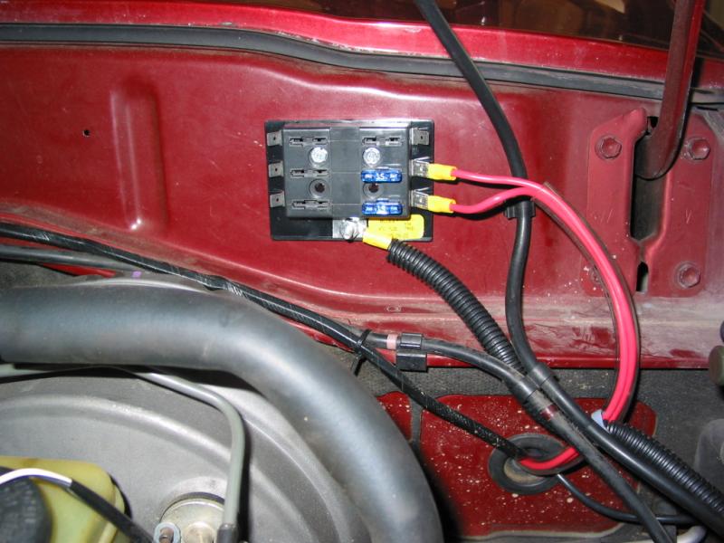

Here is mine. I just use mag antennas for both the ham and CB. FT-7800 Ham with remote head. Good unit. T
