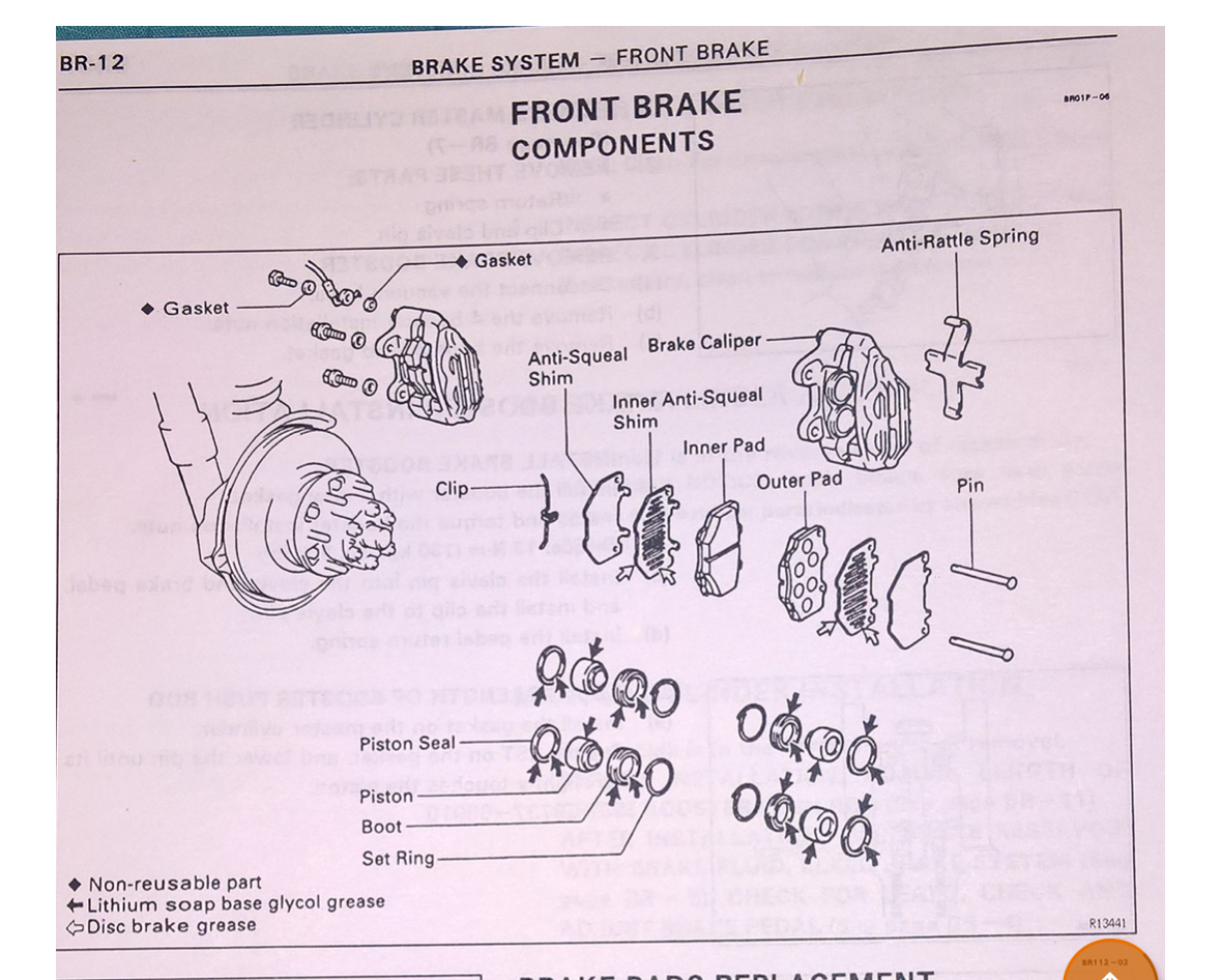

i think the first problem is i missed the black arrow and the outline arrow in the FSM on the front brakes where they call out for the grease two sides on the inner shims - which is different than what they are calling out for the lubricant on the caliper itself.

hey. give me one or two shots at asking follow up questions please? i'm neck deep in FSM and shims and lubrication and grease and videos and charm dot io install guides.
FSM shows NO grease on inside of the single shim on REAR pads. so the shims don't come with grease.
FRONT pads come with that thick bronze toyota "Molykote" stuff. so i put that both sides of the inner perforated shims.
then it says it wants you to glycol based lubricate (?) the calipers in front and - well i guess i calling it a "caliper assembly" in back.
and it wants it pretty much anywhere metal slides on metal.
so (1) can i use that purple permatex stuff for that? also (3) it shoes glycol based product at the pistons or seals or i don't know what but its not clear if its just for rebuilds. anywho - can i use that purple permatex stuff to line the rubber seals on new front and rear rubber piston seals?
EDIT: er i guess you are saying that purple permeates stuff is CERAMIC so maybe i shouldn't use it? what do i use then? can i use the CRC stuff? you want me to scrounge some of that bronze stuff in the little toyota packet off the shins and use it to coat piston seals? snd also for lubricating metal on metal areas?
seems like i should coat piston seals and metal on metal aside from the shims...?(!)

hey! sorry this is confusing but you seem to say WHITE arrow is molykote from the two little packets.
i did this on front shims.
then you seem to say there is a Toyota "rubber grease" (is this stuff white by any chance...?!) for the BLACK arrows.
then you say metal to metal contact.
this is uber confusing because it seems to want this same product on rubber and also in metal to metal like the retaining pins.
so i guess my issue is 1. what do i use and 2 do i use the same stuff on metal and on rubber or do i switch it up and 3 is it a bad idea to use permeated and 4. u guess i DON'T use bolt more anywhere other than the front shims?

you're killing it on here. awesome. and thanks a ton for this. just so i "get it" - why are you posting /three/ products and where in the FSM does it specify those three exactly please?
i'm just seeing "glycol based lithium grease for the white arrows and i just know the bronze packets go on shims because it came with my shims.
but why do you show two other items here? or how do you get from the diagram to these specific products? it's specified in the resources section somewhere for rubber seals and metal to metal and for brake shims somewhere?(!)
My take.
Glycol grease is compatible with brake fluid, and the rubber seals and dust boots.
Other greases are not.
The anti squeal aims are lubricated with ac thicker, stickier grease so it doesnt run out when brakes get hot.
What you have done looks OK to me.
Button it up, and move on

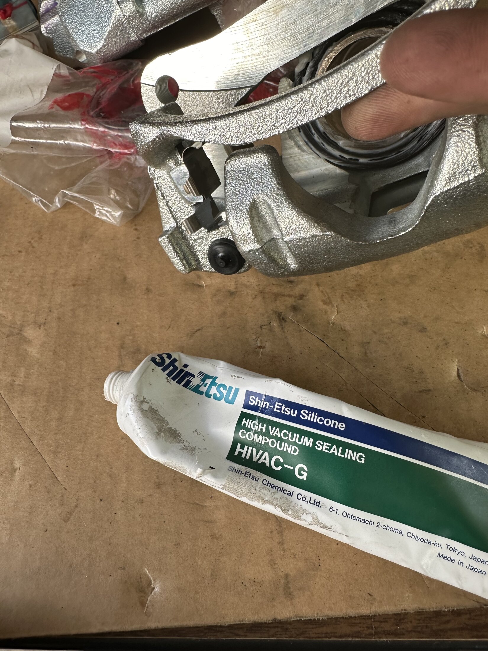

gents! i went due the wormhole today wondering if anyone has the patience or interest in digging in.
i REMOVED the purple ceramic permeated stuff and used SHIN ETSU "Grease" on the rubber seals and this SHIN ETSU HIVAC-G on the metal to metal points.
i accidentally ordered the HIVAC-G when i was trying to buy the grease for lubing window rubbers.
anyway they are both interesting and again i used the grease in the seals and HIVAC-G on metal.

I haven't used the shin-etsu high vacuum grease myself but FWIW it's a silicone grease used to swell O-rings (or keep them from shrinking) in vacuum systems.
The Toyota brake caliper grease can be ordered from any Toyota dealer.
