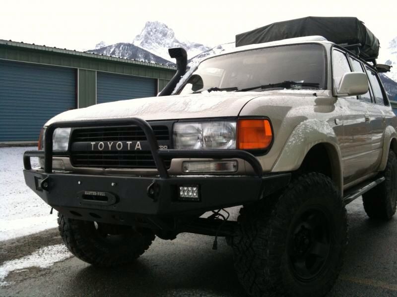

Does anybody have a CAD file for a front bumper for an FZJ? I know nothing about CNC's, CAD files, etc. but my cousin told me if I can get a file then he can CNC plasma cut it out with 3/16" plate. Or is there somewhere that I'm not aware of that has files? Thanks.

I designed one a while ago, should still have the .dwg file. PM me your email if interested. More info here:
https://forum.ih8mud.com/threads/ca-ab-80-series-custom-winch-bumper.548713/

So I finally got the file to the guy with the CNC plasma. He said the 'drawing' isn't complete and needs to be completed before it can go to the CNC. Any of y'all CNC'ed with the file @SHREDwagon sent out? Thanks.

Hey guys - I do not have access to CAD right now. The dwg file emailed was the same I used for water jetting and bending. Yes, with correct dimensions. Like I said - the pieces do not fit exactly like a puzzle. This was a prototype and will require some additional touching-up/cutting with a grinder. But hey, whaddya expect for free?
I was able to save $ in jetting by doing the CAD renderings myself based on my cardboard mock-up. It's already been reproduced by other MUD'ers who've had the time and skills (and CAD), with minimal issues. If the shop does not have CAD, you can download a free trial version from there site.

@ LFD2037: If it doesn't work out, you can always get it jetted. Best of luck man.
edit - sick tube design!
