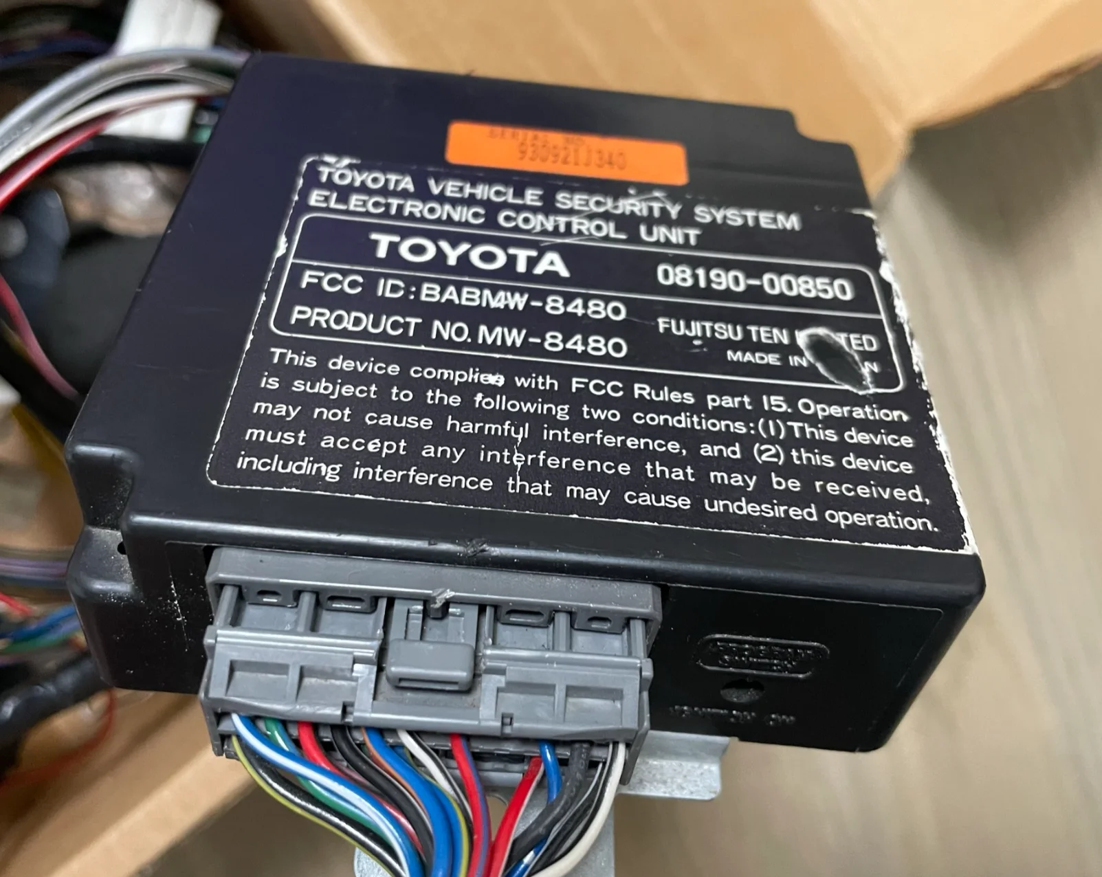

The TVSS box in my '94 has decided to auto-arm after 20 seconds and i cannot find any discussion of how that gets disabled. The manuals i have found say "contact the dealer" to enable it.
the brain box should be under your drivers seat. there is a switch on it you can slide to disable the alarm functions; leaving the keyless part functional. have you tried that?

Yeah, i moved the switch to the position clearly marked "NO SECURITY" and now i have 20 seconds after unlocking the door with the key to start the engine before the alarm goes off.
dang. thats odd. mine stopped working completely, but that failure mode is more acceptable than yours

And yeah. I might bring the tvss box inside and apply some contact cleaner to the switches, maybe refresh the capacitors. It's all pretty annoying, but i still want keyless entry and an alarm system.

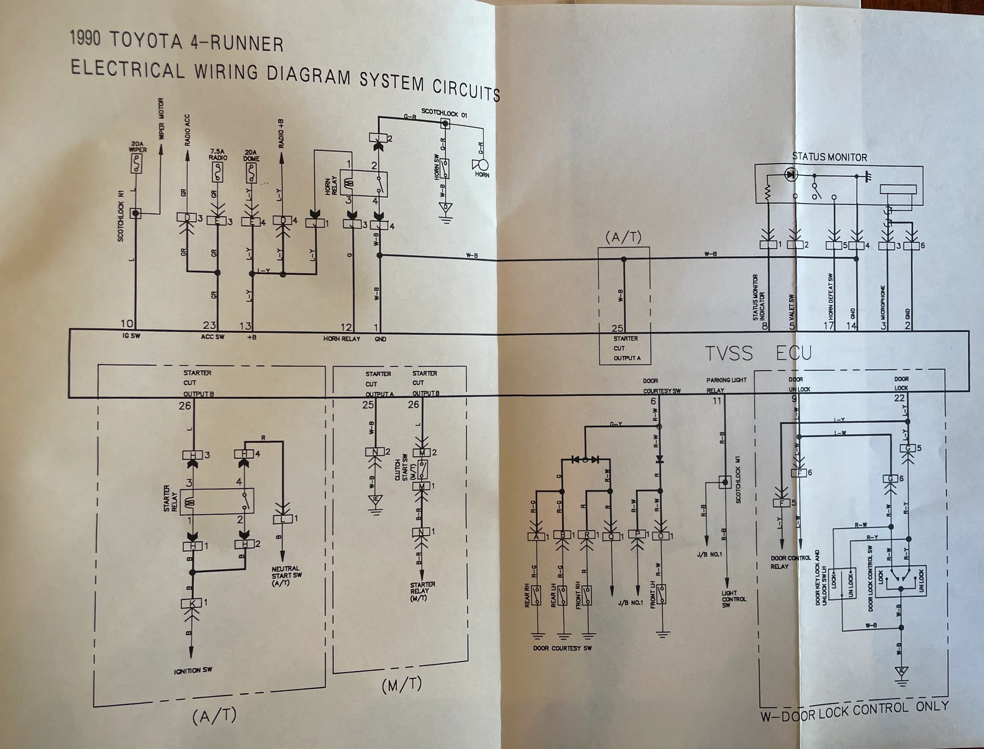

looks like maybe, based on the diagram for a 1990 4runner, maybe i need to jump for both power and ground to the starter relay?
or i need to ground two pins.
i guess i will need to see which pins have power when the tvss is connected and the key is in the "on" position
*sigh* much data collection needed.

ok, there were signs of water ingress and lots of crud on the switches. flushed with isopropyl several times and now the damn thing is properly disabled.
still, next step is remove it (but keep the harness).

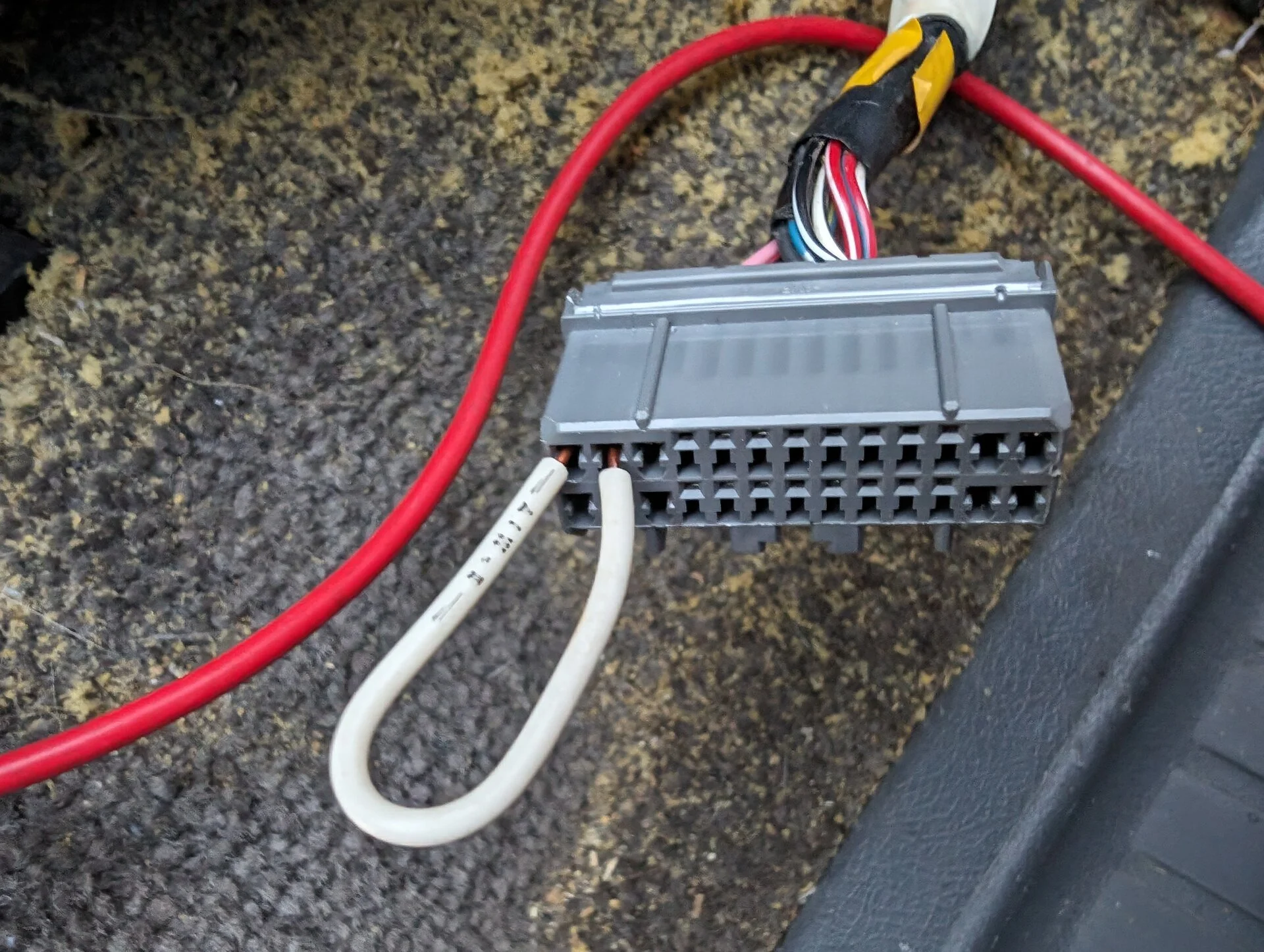

Found the starter relay lockout.
I should note that the park/neutral switch wiring on my truck was ****ed with by the shop that did my head gasket and associated onion layers. It's possible that something that's required on that side was manually bypassed. The gear selector lights and reverse lights on my truck haven't worked in the 11 years i have owned it, and still don't. But they had to replace the park/neutral connectors to get the truck to start again after putting the engine back in.
